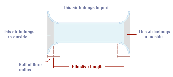

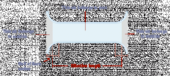

From outside the baffle, total length, for straight/flanged ports. If the curved lip is used measure from middle of the lip, for flared ports.

Port Flares
