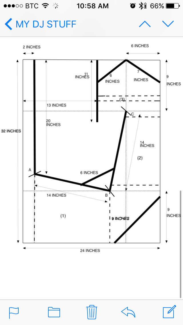

The dimensions overall are
24 INCHES WIDE
24 INCHES DEEP
33.5 INCHES HIGH (after top and bottom put on)
They are made of 3/4 inch birch
Sorry. I forgot the cut sheet

That's going to be an interesting one to sim. It looks more like a BVR than an RLH, but even then there's a "pinch" at the last fold before the mouth, because the cutout at the bottom corner reduces the cross-sectional area in the middle of the bend.

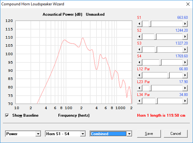

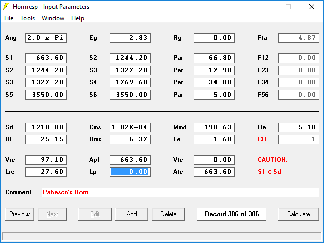

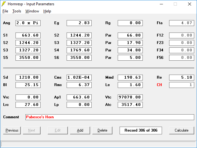

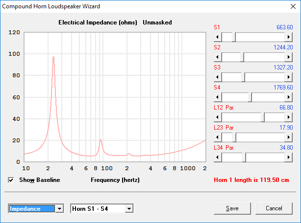

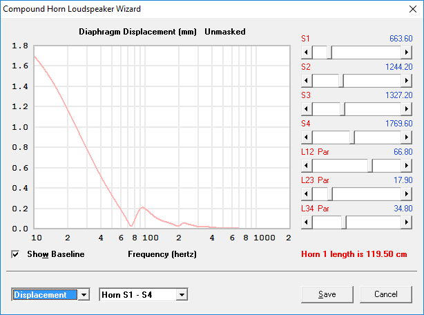

Ok, I've put together a basic sim (using the B&C 18TBX100, because you didn't indicate which drivers you're actually using). The results are not too pretty - the boxes are very efficient, but the resonance frequency is too high for them to be called subwoofers. That's if the sim is correct, of course. If you measure the impedance curve, that could be used to determine whether or not the sim is accurate.

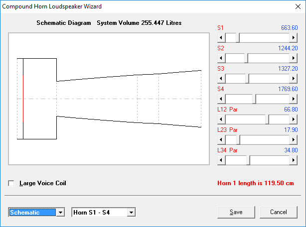

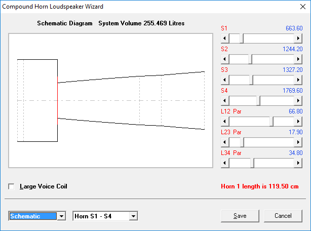

Brian that sim doesn't look correct for blh, swap your vrc and vtc values.
Whoops- good catch! I should have picked that up from the schematic, grr.

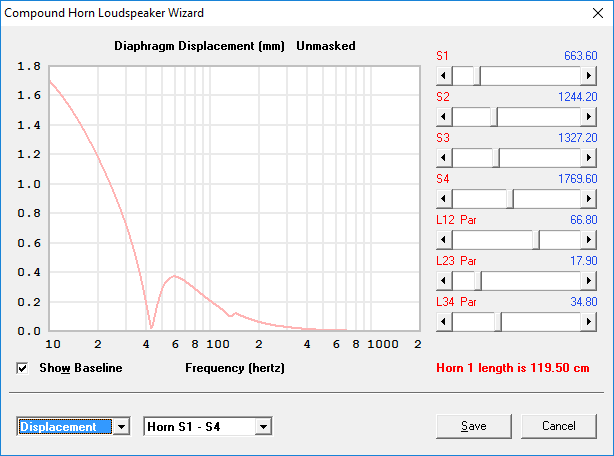

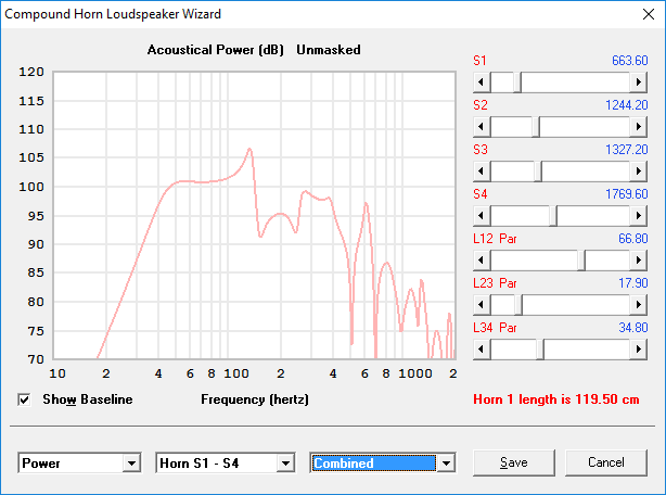

Ok, here it is with the corrected chamber volumes. Looks quite a bit better now. And the impedance curve and displacement suggest BVR.

There's minimal difference in the sim when the 18TBX100 is replaced with the 18Sound LW2400.
And yes, getting a hang of how HornResp works and what the graphs mean is going to take a lot of guesswork out of your builds.
