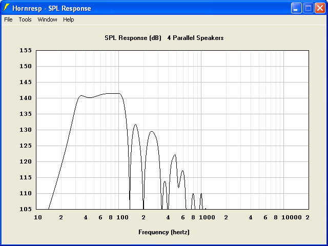

18" horn enclosure
I want to try my hand at horn resp. Still struggling with the rear enclosure volume and also, where exactly does S1 begin?
For selenium 18sw2p.
I can post dimensions if anyone is willing to assist.
Selenium 18sw2p

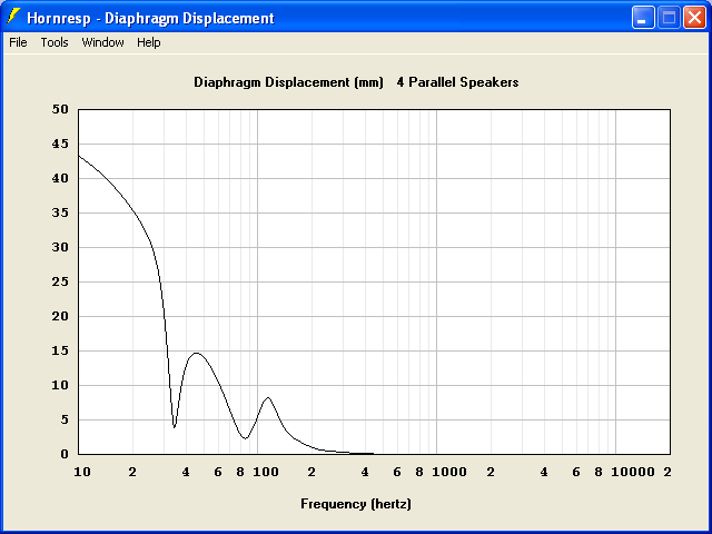

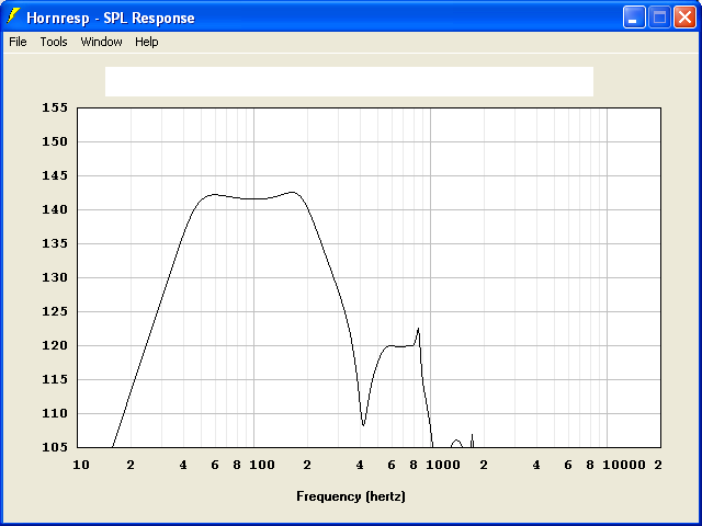

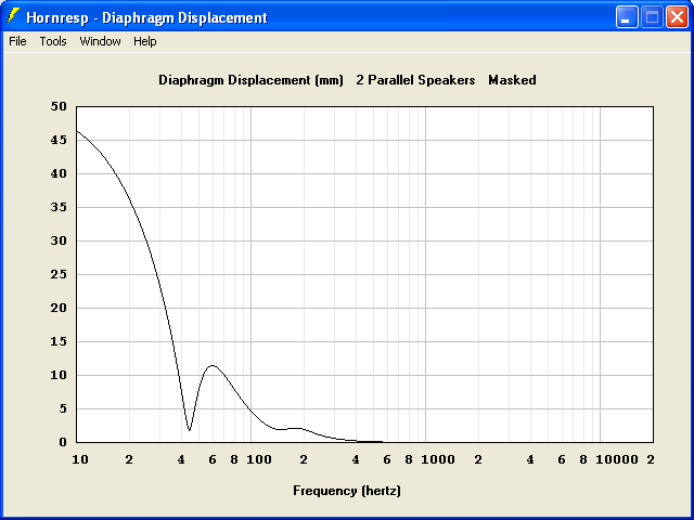

Usually the cabinet external volume is about 1.2 - 1.35 times the volume simmed by Hornresp. I calculated the external volume as ~435 liter, therefore I would limit simulated volume to ~344 liter or less. On my own designs I calculate the panel volume and substract that from the external volume, as well as the driver, handles, etc.
It will go ~10 Hz lower then Cubo 18, at the same sensitvty. it will have ~40% higher excursion needs between 40 -60 Hz, significantly less below 40 Hz untill equal at about 25 Hz.
Cubo 18 is ~250 liter external, Cubo Sub is ~368 liter external.
Best regards Johan
"It will have ~40% higher excursion needs between 40 -60 Hz, significantly less below 40 Hz until equal at about 25 Hz."-What does this mean in terms of efficiency as an outdoor cab for dj and p.a since the 40 -60 Hz range is also much needed ?
The difference between the 2 dual 18" bins and 4 of these single 18" bins @ 1000 w per driver.
