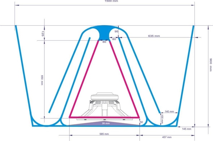

Hi ,
I have just finished my design for a folded bass horn powered by a single 18" Selenium Driver ( 18SW1P ).
The horn cabinet is 650 mm High and close cabinets have 125L.
If somebody like this type of cabinets I will apreciate his opinion about this design.
I hope to reach 135dB / 800w rms in 40-100Hz range.
Regards !

I like horns very much! And bass horns are really a challenge, especially for the WAF thing.
With which material are you going to build this? Wood I guess. Then it has to be a very heavy wood to avoid vibrations.
What will be the efficiency of the system with 1W/1M/40Hz?
I think to use 18mm OSB to reduce weight but I will make many reinforcements for walls .
For round walls I will use 6 layers of 3mm plywood glued and pressed togheter in required shape .
I've made some similar horn ( 2 x 15" drivers ) in the past and I saw what potential problem represent weight. So, I've decided to make everything is posible to reduce wight without sacrifice sound quality.
I hope to reach 105 - 106 db/1w/1m at 40Hz .
Bulding a folded horn can be a challenge for every DIY-er but , in my opinion , is the best option for bass range if space isn't a problem.

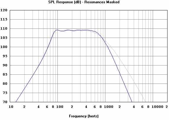

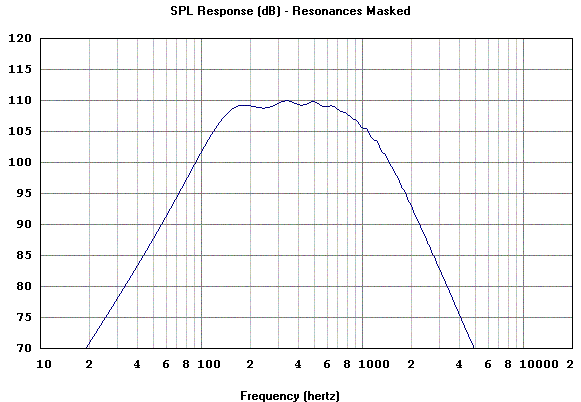

if u have specs il model it in hornresp.
specifications

Your horn appears to be a hyperbolic flare.Do you have any LF distortion from the tight flare rate?
are u talking to me/?
when i do midrange i start with tractix
hyperbolic bass
=thats where i start,where i end up,that depends.
my latest basshorn can be made into 4 conicals approximating a hyperbolic flare(sorta) and allows adjustments in frequency response.
