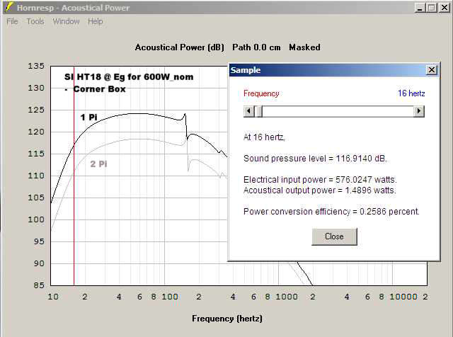

Hi DrDyna,
I agree, it all looks better with the SI HT18. They seem to like from ~ 8 to 12 ft^3 in a vented enclosure, w/ the duct as large as possible. I have simulated them w/ the T/S from the manufacturer (for the other model), and the T/S from data-bass.com. Some difference, but not enough to talk about. To get high SPL @ low frequencies we just need to move some air. Oh well.

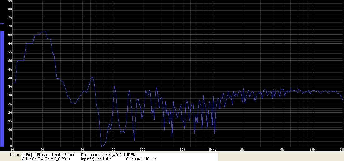

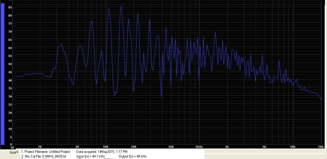

Here's a spectrum analysis on the final chord of the Toccata and Fugue in D Minor by Bach.
I also played some sine waves to measure output.

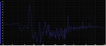

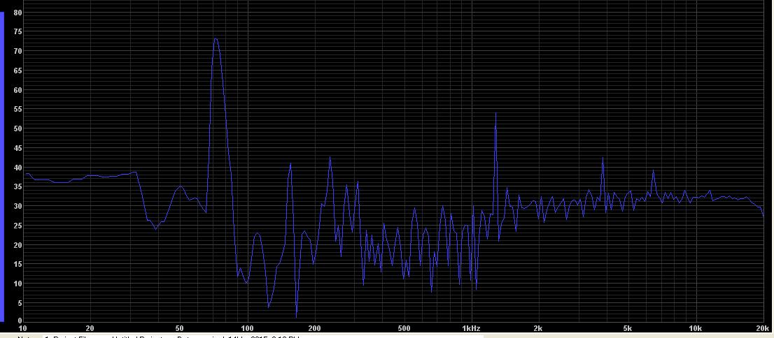

Here - for perspective - is a 85 Hz. sine wave being played.
And here is one at 21 Hz. - all settings the same:
That's my first stab at using the software and equipment for measurement. I'm open to all sage observations.

What's needed for comparison is one of your 16' pipes sounding, measured in the same position. If you're getting similar loudness from the electronic rank(s) the rest is just cleaning up the details . . .
The other question, of course, is do you like the voicing and could you mistake it for "real" . . .

Nice first measurements. You have clearly identifiable measurement points there.
dewardh is correct in the matching idea. But I think everyone knows and understands this.
It will have to wait a little while.
Keep on trucking sir. This is looking pretty good.
How far away are you measuring?

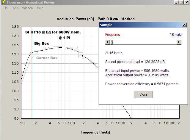

Hi Bach On,
Good to hear that you were able to listen to the Big Box w/ two HC12s, and that the result is promising. The second subwoofer together with the change to the SI HT18s should give you the volume you need.
I fleshed out your geometry from Post #556 to get a feel for the available volume; see attached (What looks like a drawing is really just a sketch w/ notes. You'll have to figure out how to build this thing, and how to get it into the loft. You may have to build that in place, and provide for a removable driver baffle. Don't forget some protective grill, or so, for the driver(s).)
I also ran some more simulations.
P.S.: Your pace is just fine.
Thanks again for the terrific work. I took a look at the "drawing". Hmmm. The clearance at the back of that driver is really close with that 18 inch driver and the hypotenuse wall.
I do think the ported bass box with the two 15 inch drivers is putting out pretty good sound. I do notice some "thruming" in the box. A short note seems to have reverb. That bothers me. But the box does seem tight with little that I would describe as rattles or wood flexing. I do suspect I need to add a wood brace between the front and rear walls. I originally had one in there, but removed it to add the port.
I believe I also need to substantially increase the damping fill in the box. I saw where someone sprayed adhesive to the interior walls and applied poly-fill to the still-sticky walls to reduce reflections. I've only got two or three inches of fiberglass damping material at the bottom of the box. I think more might help.
I plan to use both the 15 inch box AND add the 18 inch corner cabinet. When you've got a volume control you can always cut back on the volume. It doesn't work as well the other way.
