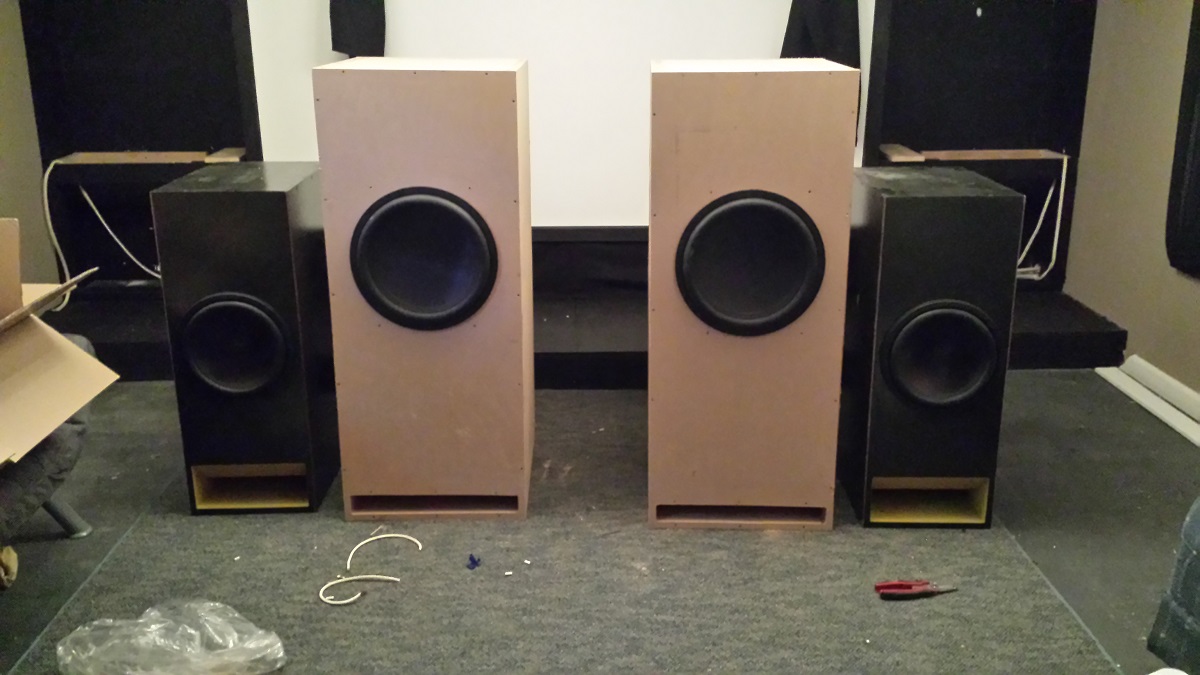

Well, I added the port this afternoon (7 3/8 at 30 inches). Put it in the bottom of the cabinet. I'll put 3.5 inch feet on the cabinet. I'm waiting now for the glue and the caulk to set. I also cut another hole for that second Dayton ST385-8 15 inch speaker (which arrived yesterday). I decided to go on and try both in the same box with the port. I had to remove the original speaker to move an internal support that was blocking the port tube. I'll go back tonight and wire and install both speakers in the cabinet. Then I'll do some testing. At least we'll having something operating when the organ work and sound engine install gets done - hopefully sometime in late June.
I have some men from the church coming in the morning to help me put the speakers into the speaker chamber. If the 15 inch speakers don't quite cut it, I'll enlarge the holes and switch to the 18 inch speakers later. But the 18 inch speakers are back ordered. I can do this now. If this proves inadequate, I'll just buy the two 15" drivers myself. I'm sure I can find a use for them - or sell them somewhere.
We're going to try one of the HC12 speakers for the other channel of the pedals. It will be on it's own Crown XLS1000 amp. I'll eventually tinker with the crossover point for it as we do voicing. Many have suggested that the 15" woofer on that speaker could do the 16 foot stops - and the upper frequencies of the sounds can be reproduced by the mid-ranges - and maybe even the tweeter will have something to do. If needed, maybe there will be room to add another HC12 later in parallel.
Keep your fingers crossed!

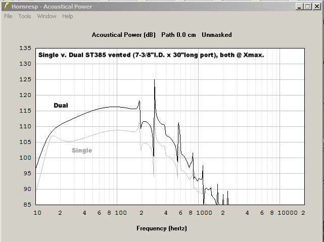

Hi Bach On,
So your first try will be w/ 2ea. ST385s, and the 7-3/8"I.D. x 30"long vent. This should give you a very good idea as to where you are with your project. It's a lot of effort, but I think it will be worth it. I recommend you use a lot of fiberglass in the bottom of the enclosure. It should be far enough away from the drivers not to give you any problems, or you can use polyfill too. I'll attach a Hornresp SPL comparison @ Xmax for single v. dual driver. It's important to remember that these simulator programs do not address losses; you can simulate something like losses in Hornresp, but at best it's only an approximation, I went w/ the simple simulation (no losses).
As to the HC12s, I used to run 4ea. Eminence 15" of a similar vintage sealed in corner soffits in a control room. They were more than sufficient for me, but did not really go down to 20Hz, they did 32Hz just fine. But, that was for 4ea. 2ea. per side. Just something you'll have to play with. At least the HC12 were designed for your application.
When you are talking about 2ea. 18", are you talking about the UM18 or the SI18? Either driver will move enough air to overload the port, so it may take another look at that subject. (Passives anyone?)
How? I was thinking of using light filling in the sim as an approximation for losses, but I wasn't sure if it would be a good approximation for losses.
Hi Brian,
Yes, using filling would be one thing, especially if one simulates the enclosure as a OD-MLTL, that way you can pick where to insert the filling. Let's see, David has added the power compression feature, where you can type in a coice coil temperature, and the program will calculate the new Re, and re-simulate. You can also try increasing Le, and see what that will do (there seems to be concensus that the Le @ subwoofer frequencies is higher than Le(1kHz)). You could decrease the duct I.D. to get an idea of what turbulence might do.
Obviously, all that will loose accuracy, so ultimately you just have to measure. I don't know of any other way.

Edit: For reference, the OP's subwoofer and my subwoofer(s).
