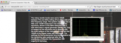

Some napkin physics. A small blower motor of 20 hp =15000watts. Efficiencies of 30% (guessing this and making it similar to high efficiency speakers, but I don't imagine that much heat comming off the organ. ) so a ballpark for power amp is 15,000 watts. Depends Huge on organ efficiency. If it's 60% you'll need 30,000 watts. A large organ needs 300,000 watts. So large low end in a large space needs large power, no surprise there. These numbers suggest a large PA rig. Are a couple of subs really going to cut it?
Cbdb,So large low end in a large space needs large power, no surprise there. These numbers suggest a large PA rig. Are a couple of subs really going to cut it?
Your numbers are based on all the blower air going to the low pipes, which is not the case, the blower is sized to provide enough wind to blow multiple ranks all at once.
A couple of fractional horsepower Thigpen rotary fan subs were considered adequate for Cameron Carpenter's Telarc recording, though they could do 110 dB, 105 dB from 7 Hz to 25 Hz was considered to be tonally balanced with the rest of the system.
If you limit the LF extension to 16 Hz, those levels do not require a large PA rig or rotary subwoofers, but do require one or two high power, high displacement, low Fs woofers.

flat response of 143 db up to 200hz would clear the congregation VERY quickly.
Don't forget, 143 db at 1m isn't 143 db out in the room. I'd think 120db/1m would be more in line with what would sound decent and not be under any stress.
And no, I didn't shoot JR.
Numbers aside, a system capable of 143 db in passband at 1 meter is sufficient of providing "rock concert" levels of bass for venues up to 2k people.
