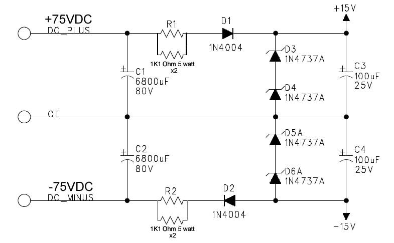

Is there a better, quieter, more elegant way of developing +/- 15VDC from +/-75VDC rails??
An amp i am working on uses this schematic to power the front end from the +/- rails. It works, but they used two 5 watt resistors piggybacked on top of each other without any sort of support to the PC board, or each other. and because this amp see's regular road use, the piggy backed resistors ended up breaking the solder connections causing the amp to fail.
this just seems like a brute force way to do this. and Most V-Regs like a 7815 etc cant handle that much on the input side.
If i calculated the power dissapation correctly, then there is about 5.5 watts going up in heat which was enough to discolor the resistor legs and board around them.
I thought of changing the resistors and zeners to develop +/- 30VDC then using regulators, but i thought there must be a better way to do this using a transistor as the pass device etc.
There is not enough room in the chassis to mount another transformer, but i can put a small PC board vertically inside next to the cap bank board.
Can anyone show me a schematic that i can adapt. and would there really be any benifit to going through the trouble??

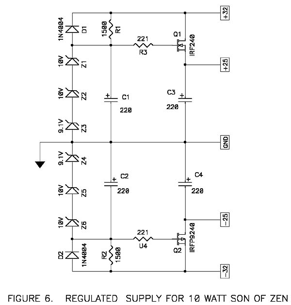

jleaman said:What about using the Nelson Pass Zen regulator ?
DUH! you know i never thought to look there! But look what i found, a simple easy circuit that looks like it will do the trick!
Now according to the text, the Zeners need to total about 4V higher then the desired output voltage. so, i should be able to just remove one of the 10V zeners per side for a total of 19.1V remaining minus the VGS of the mosfets should yield 15.1V thereabouts.
Now, will i need to change R1 & R2??? and i wonder what wattage those should be. I just so happen to have some of those mosfets on hand, but i think my front end is drawing only 100ma or so, so i may try and find some smaller mosfets to conserve space.

Zero Cool said:Oh yeah, forgot the disclaimer...
The schematic show above is of course the property of Nelson Pass and is shown for reference and Education only etc etc. DONT STEAL THE DAMN THING AND CALL IT YOUR OWN OK!!! hahahahha
Zc
Yup im building mine for personal use not To sell : O ) He has great design's..
It may be crude but it works. If the trouble is the resistors cracking free, they need support. I often have to resolder them in Crate and Fender products for this reason. A line of silicone will hold them in place and seriously reduce the motion that causes the solder to fail. Or mount larger resistor to the chassis wall in clamps and run a couple wires. More complex circuitry is not always the best approach.
Apart from the switching option suggested by anatech, all the other options will produce the same, or more heat. You might get a better quality of power supply though.
I would just get some ali clad power resistors, and bolt them to the chassis somewhere near, then just conect up with flying leads.
Cheap and easy.

The whole front end is powered off the +/-15VDC a preamp section and 2 parametric eq sections.
I am adding the vertical board anyway to the amp as there are no fuses on the B+/- anyway. if one channel should fail (which it did) there is nothing to protect the thing from totally destroying itself except the 10amp line fuse!!! So i am adding a board in there with fuses between the power supply and each amp board just to try and help save the thing a little bit should it ever fail again. at least try and save the PCB board and traces from burning up.
So i have a small amount of room in there between the fuse holders where i could put a regulator that uses TO-220 pass devices mounted on small heatsinks. OR, i may just use some larger resistors or maybe parallel several together to reduce the tempurature of each down a little bit. the total heat will be the same, but each one will run cooler.
But before i went that route, i thought i would explore what possibilitys are out there and the PASS regulator looks like it would do the trick nicely and fun to build and experiment with.
A small transformer really would be the best option. and im still looking to see if i can somehow squeeze one in there, but i think the regulation would actually be worse then. as there would be no regulation at all. i would have to add some regulators and a small trafo. but i could at least then use off the shelf 78xx devices.
BUT,... would that be better?

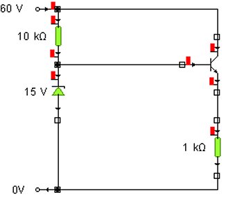

I looked in the power supply section of "Success in Electronics" and found what it calls an "emitter follower stabilizer".
It's a power transistor whose base voltage is controlled by a Zener diode. The output voltage is the Zener voltage minus the base voltage. Apart from the transistor and Zener diode, the circuit has two resistors.
Tim: This circuit is OK provided your current drain from the +15V is very small. But it is simply a linear regulator, and if you were to draw, say 50mA to power a lot of op-amps in a preamp or something, the power transistor would dissipate 2.25W and would require a heatsink.
