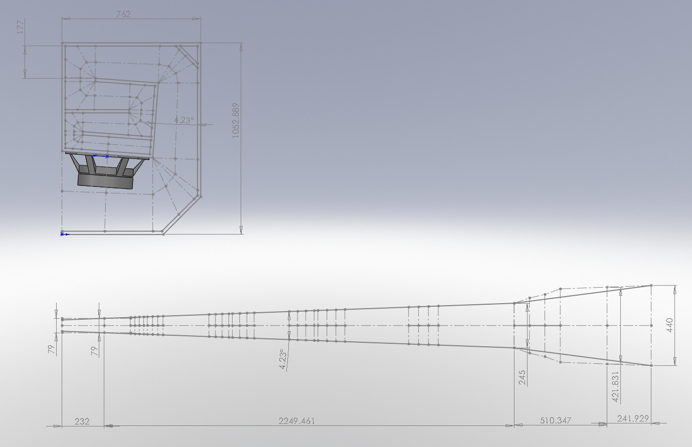

There has been some discussion on calculating the folded length in the 'spreadsheet for folded horn layouts thread.'
Soho54 sugested an 'advanced centre line method' in post 13
http://www.diyaudio.com/forums/subwoofers/171747-spreadsheet-folded-horn-layouts-2.html
I have adopted this method at the moment. It has advantages when used with a CAD drawing package as it is possible to use the segment line lengths to generate an associated sketch that has the schematic dimensions ready to input into Hornresp.
The sketch also allows me to measure the optimal width of the horn at each segment end, and the taper angle. By entering these dimensions back into the folded model in an iterative process I am trying to optimise the horn layout!
I attach a layout similar to Wood1y,s 15" TH as an example.

Sorry for my sarcasm, Martin. I wasn’t aware of the discussion about 'advanced centre line method' (thx for the link). Indeed it sounds interesting what you are trying to do, so I’ll keep my eye on your posts. But still, I would like to see (sometime) that we were able to calculate/visualise the differences in pressure within the folds. Then we could optimise the folds and its airflow to improve efficiency and get less side effects, although... we might end up with some very complex designs to build.
I don't know that I would call it "advanced", but it gets the job done. It has worked for every sim posted, with real measurements, that I have used it on.
I referred to it as the "advanced" centerline method to distinguish it from the normal centerline method.
And this the most important part. I'm seeing very good correlation between predicted and measured results (impedance plot) using this method with my POC #2 TH. Once I have a bit more time, I'm going to check to see if it provides good correlation between the predicted and measured results for my POC #1 TP as well.
