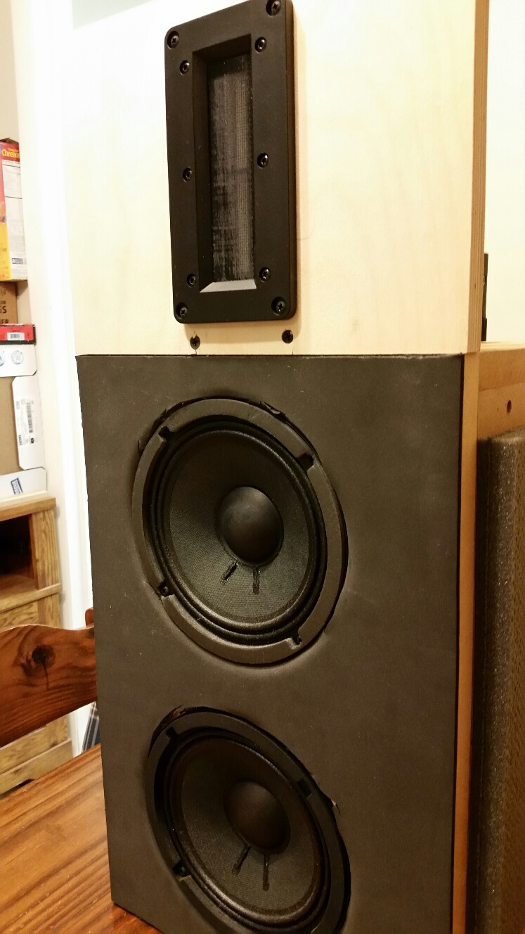

Is there some reason you can not use TWO faital 6FE200 per speaker?
It's a bit difficult to find 10" and 12" with high sensitivity also, the 6.5" can be placed close together and wired in parallel for higher sensitivity. There is also a 16ohm variant of it, in case you need/want impedance matching drivers.
Sounds like a great plan :)
