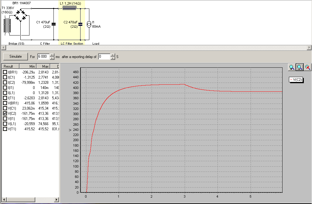

PSU for output triodes
Now, I need to choose proper HT PSU for output tubes. I am not certain what is current requirements while voltage at grid changes from 0 to max.
Assume ug = 0 (or Ug = -65V), then Ib = 2x 40 mA and Ub = 400V.
When Ug1=0V and Ug2 = -130V, then Ib = 75 mA + 0 mA, because one triode does not conduct? Shortly, can I use a current source of 80mA as a model for a load to PSU?
Why is it important? One reason is choke impedance in series with the load, the more current, the more voltage drop.

PSUDII Sim of output stage
I have done quick simulation using PSUDII. At t=3s 2 x 70 mA current is drawn. See attachement.
I will verify voltages and response to the load after having built. Instead of 1N4007, 1N5062 sintered glass avalanche diode will be used. If full wave circuit employed - 2 rectifiers must be connected in series - repetitive reverse voltage for 1N5062 is 800V which is exceeded. With Graetz bridge it is 415V.

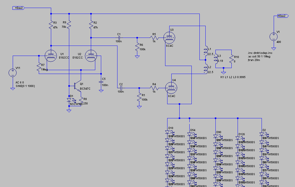

Driver / phase splitter
Input capacitance of 6C4C consists of
Cin = Cstray + Cm = Cstray + Cgk +Cgp*(1+u) = 10pF + 7,5pF + 16,5pF*5,1 = 101,6pF round to 100pF.
Source impedance of a driver stage
rs = 1/(2*pi*f*Cin) = 1,59 k, where f=100kHz
Output impedance of an E182CC-based LTP is around 1,54k with plate resistors of 47k. Which should be fine.
Voltage amplification of LTP is about 11,8 in reference to gnd. Provided I need 130Vp-p or 46Vrms to drive 6C4C, voltage preamp stage is required.
LTP with some feedback to improve signal symmetry (Thanks Geek) and constant current sink as a tail will be used

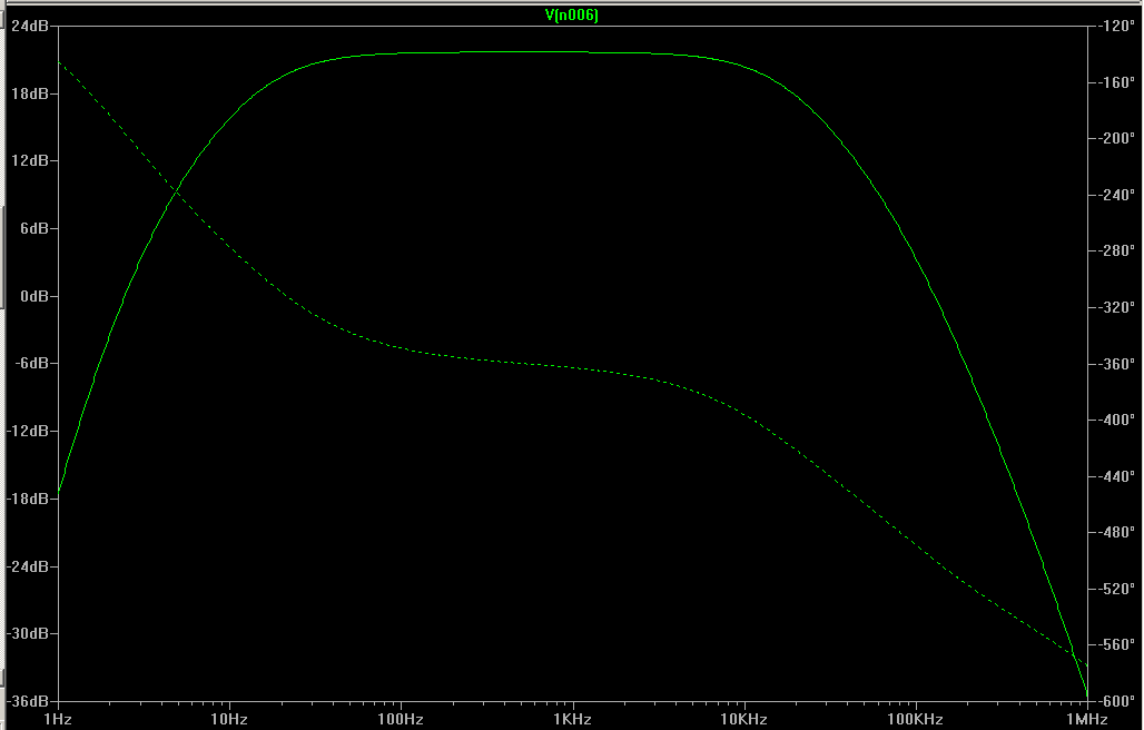

First simulation of LTP and output stage with LEDs
Phase splitter (LTP+simple CCS) and output stage with LED matrix. That is first approach and LTP may change when voltage amp is added. I still have troubles with 6C4C P G H1 H2 spice model to be used with LTSpice. For now simplified version with virtual cathode. There are 20 x 5 LEDs used in the 6C4C bias, which gives ca. 65V voltage drop DC and Ua=386V-65V=321V.
I think if cheap red LEDs are used I need 5-6 more in each chain. I have already had two 4 x 26 LED matrices which were used with SE stage - I will reuse them.

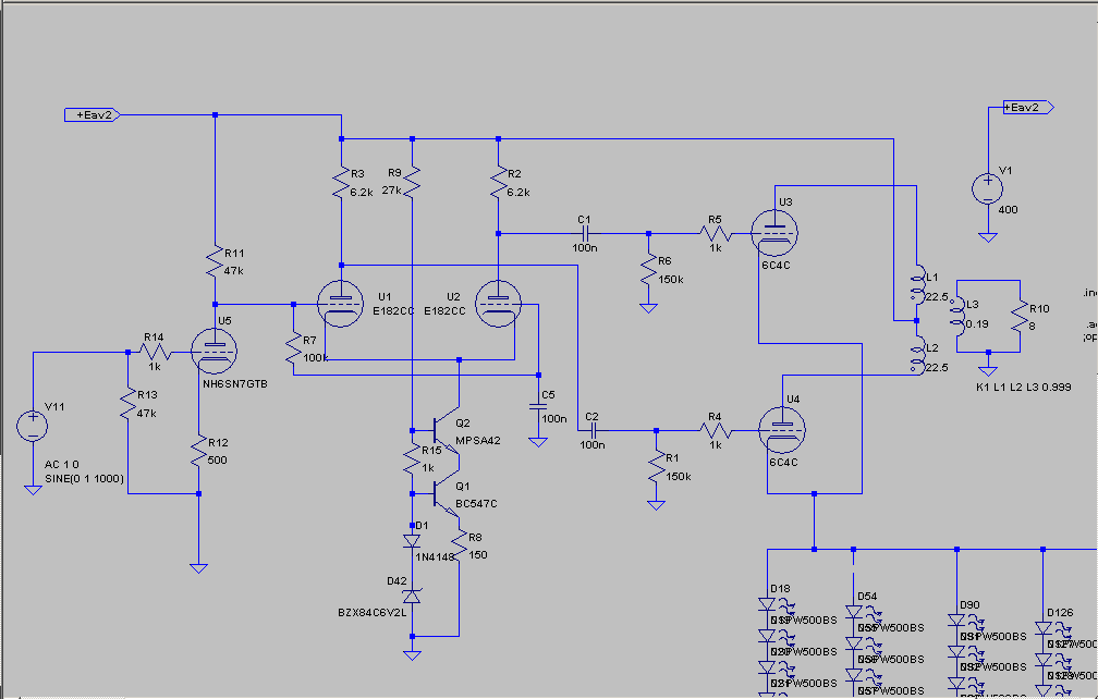

I want DC couple the first stage to the LTP, which needs elevating potential on cathodes of E182CCs. Cascoded NPNs will be used. That in turn will increase CCS AC impedance 3 magnitude order (initially max. 200k).
E182CC is said to work @Ua=150V. I need 130V anode voltage swing and 150V of Ua then 120V + Ugk(E182CC) is left. Say, 126 - 134V on the anode of the first stage.

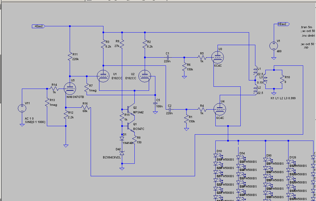

Ready for breadboard phase and tests
Initially I wanted to use E80CC, yet decided to change to Russian 6H8C (6N8S = 6SN7 equiv). That implies change of heater supply.
I am eager to start breadborading. Weekend ahead.
Any comments welcome.
