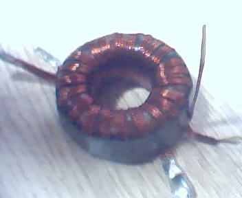

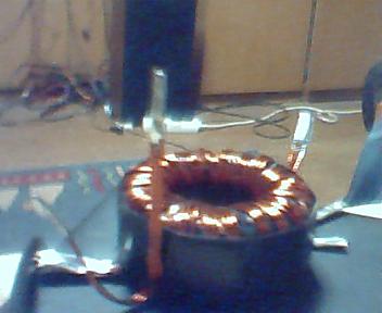

Ok if I say it differently, no it is not, You will have to use 10x0.5mm or better yet 10x 0.8mm or more wires.
I used I think it was 12x0.5mm for each primary, loaded supply with ~320w and wires heated up so much inside 30s that I could have fingers on it, and primary current was only about 25A...So you see what I mean by you will burn them... Ok my test was 320w continuous, not music or something, but still, use more wire
Depends on what you want to do, if you want to burn them...are 5x0.5 mm diameter wires not enough for about 30A current (max power)???

Well i intend to use the supply for audio amp 2x80W max. I'll do some tests after I finish the smps to see how much the primary will heat up because I don't want to dismantle the transformer since I spent a lot of time to wind it. If it gets too hot I will rewind it because I don't like very much the idea of burning it.
kozetot said:Well i intend to use the supply for audio amp 2x80W max. I'll do some tests after I finish the smps to see how much the primary will heat up because I don't want to dismantle the transformer since I spent a lot of time to wind it. If it gets too hot I will rewind it because I don't like very much the idea of burning it.
For that low of power it may work OK, but if it gets hot, why not wind as much as you can in parallel to handle more power...

Kozetot: Nice Toroids.

Thanks. When I finish the smps I'll post a pic.

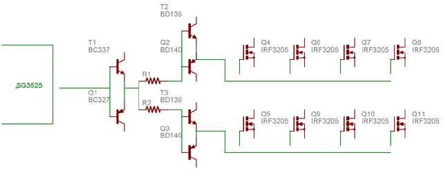

Please do, and also a schematic or details about the circuit!

Here's the power stage schemo....

I've never liked the idea of directly driving the MOSFETS with the PWM IC being I've saw so many blown car amps with that setup.
Was thinking 2 or 3, or even 5 pairs of the 100N10s (just got 10 samples from OnSemi ) and driving them with MJE15034/35 transistors driven by a TL494 PWM IC. Should be stout enough I imagine. Also Have 10 TO-220 NTP75N06's to play with.
I'll experiment and see.
Although I'd like to get a bunch of IRF3205.......
Try the IRFB4110 100V 180A!!! 370W 3.5mohm in TO220 package.
The gate charge is quite huge, 150nC per device. I use it in pairs
to drive a push-pull transformer of around 1kW.
To drive these mosfets I think that the better solution is to use a dedicated low side mosfet driver IC between the controller IC (eq. the SG3525) and the mosfets gates. The better I have ever used is the Texas Intruments UC37322 rated for 9A of pulsed current.
Sweet
