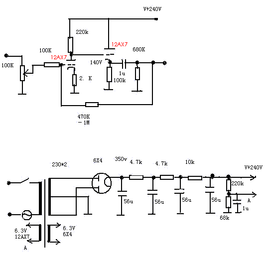

The cap after the 6X4 is really high, about 10µF should be a lot safer.
Yes definitely change that cap. Should sound nice and warm and fuzzy!
Enjoy!

Personally, I would go for the 6SN7gt, or the 6SL7gt if you need that extra gain, the 12ax7 aint a great valve, a bit prone to microphonics, Changed dosens of them over the years!
The 6sn7/6sl7 have a great reputation it seems, but they are an International Octal 8 pin, and benefit from DC heaters to reduce injected hum, especially in phono stages!

Hi, alastair
can i use 6sn7 for phono stage & 12ax7 for line stage?

Not Alastair but the other way around would be a much better place to start.
fdegrove ,
so 12ax7 for phono stage 6sn7 for line stage, tnx. fdegrove
