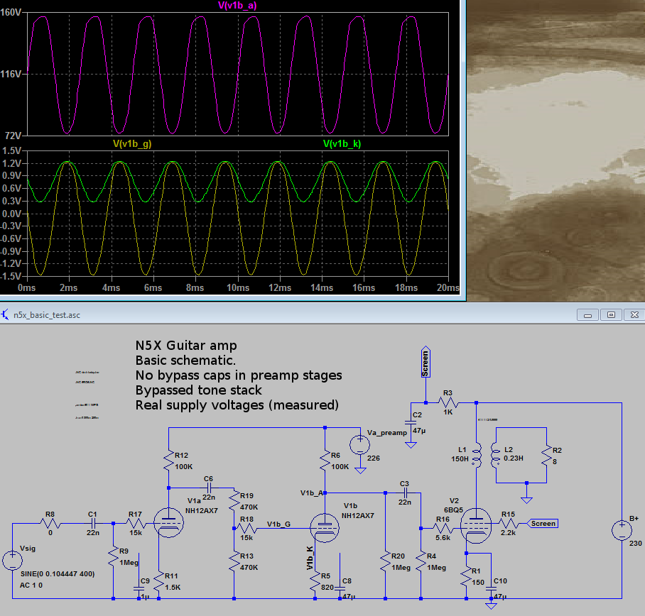

I built a nice 5W guitar amp, and I'm checking how the stages are working with a pure sine input and oscilloscope.
It has a two stage 12ax7 based preamp.
The next oscilloscope capture shows input (yellow), first pream output (blue) and second preamp output (magenta). All of them AC coupled.
Look at the "clipped" bottom of the magenta signal.
The grid is not able to approach cathode voltage, and stays 0.5V appart. The next capture shows it (yellow: grid, green: cathode).
I think this is causing the asymmetrical output.
The spice simulation does not behave this way. The grid-cathode voltage can reach -20 mV, where I suppose grid current starts to flow.
The simplified schematic and simulation:
This is my second tube project, and the first time I'm really trying to understand all steps in detail, so I'm not very experienced yet. But I would say the 12ax7 should reach Vgk = 0. Could there be something wrong in my circuit?
Thanks for your help and support!

Hi
In a 12AX7, grid current starts to flow at Vgk=-0.5 V.
As you have a voltage divider in the input, it reduces the sine voltage applied to the grid as current flows.
Simulation of grid current in tube models often doesn't work when grid voltage is negative. So simulation likely not correct.
Can you post the listing of your 12AX7 model ?

Ok, I see. I didn't know about that.
The model I use is this:

Thanks Elerion
In the model you use, grid current starts when Vgk > -0.2 V.
I suggest you try others values more realistics in my opinion :
In the model, you have 2 parameters describing grid current :
GCF change from 0.00001 to 0.000003
GCO change from -0.2 to -0.5
Furthermore, if you want to avoid this effect in you real circuit, remove the voltage divider between first and second stage.

V(v1b_a) swings 157V to 72V, 82V peak-peak.
The 6BQ5 is probably running 8V at cathode, bypassed, so can't take a lot over 8V peak (16V p-p).
The "asymmetrical output" at 2nd plate happens only LONG LONG after the 6BQ5 has gone totally square-wave. It is in 5X overdrive before the 2nd stage gets bent.
So not a problem for Clean.
And generally "asymmetrical" is not a big problem in guitar amps. It adds "flavor" to the dry sound of a naked steel string.
I agree the Vgk is interesting, but that IS a high impedance at Grid, and 12AX7's tight-strung grid flows some grid current before it gets positive. And different in different brands.... Neumann and Irving's Guitar Amplifier Overdrive has some data. However I do not think your 2nd stage is the least bit stressed when the 6BQ5 is banging itself rail-to-rail.

I tried. But the same happends. Just the cathode signal shape changes a little bit, but the 0.5V gap is still there. This is not bypassing the cathode resistor.
With voltage divider:
Without voltage divider:
When using a bypass capcitor, the grid-cathode voltage does reach 0V, and when removing the the voltage divider, the voltage even gets a little bit positive.

I don´t simulate but have been building tube amps since 1969.
The waveform you show is exactly how a triode behaves when driven hard, and, as mentioned by PRR, an important part of the "flavour" which makes tube amps preferred by most Guitar players.
If you are annoyed by it, just go Solid State

Download this:
http://www.valvewizard.co.uk/Common_Gain_Stage.pdf
A few pages down toward the end see "Grid Current Clipping" , its is right after the "Cut Off Clipping" section (Sections 1.13 and 1.14).
