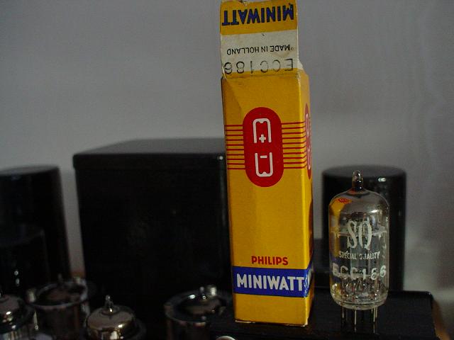

Also try ECC186 if operating condition allows.
