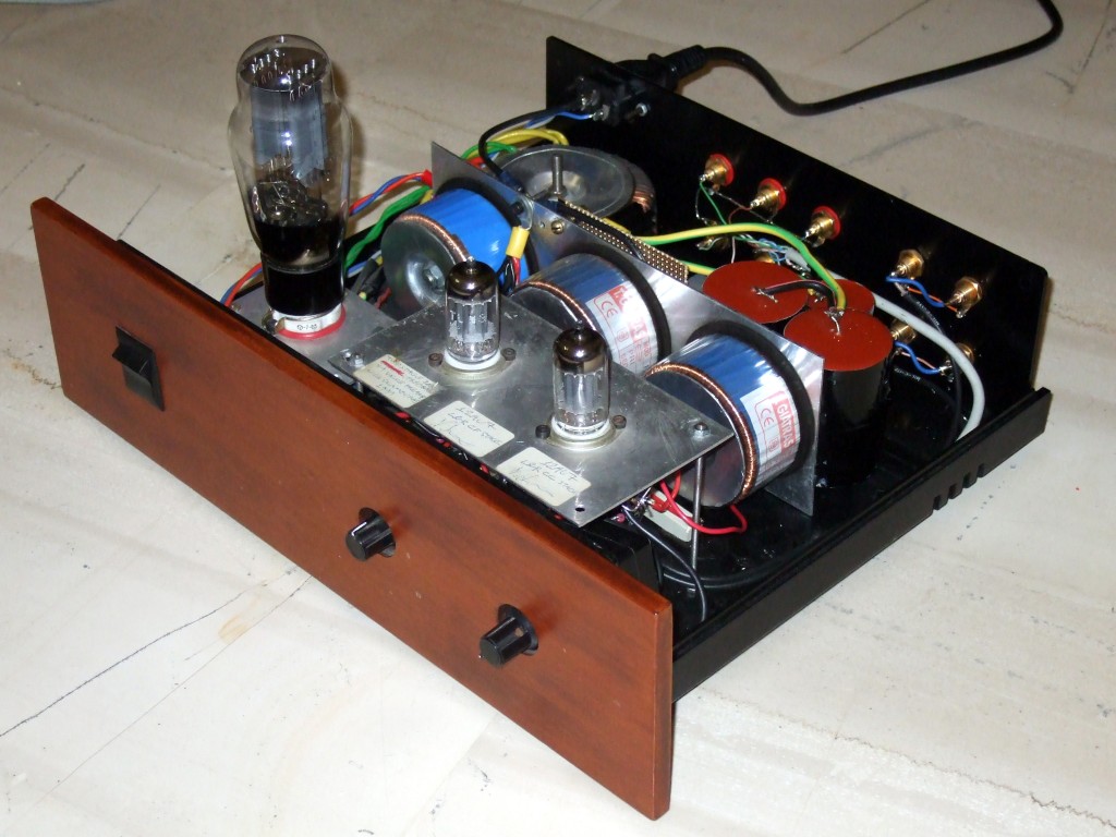

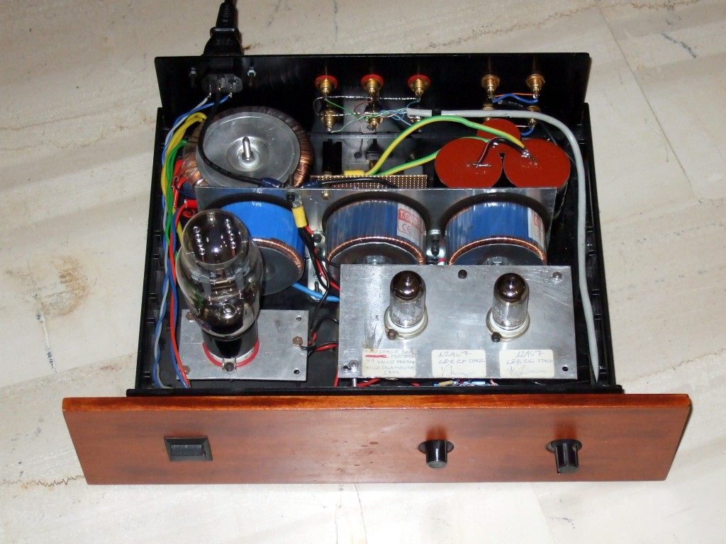

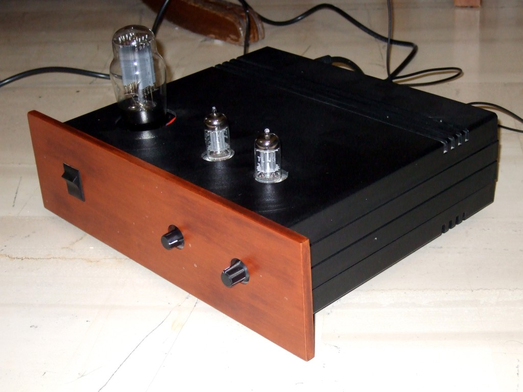

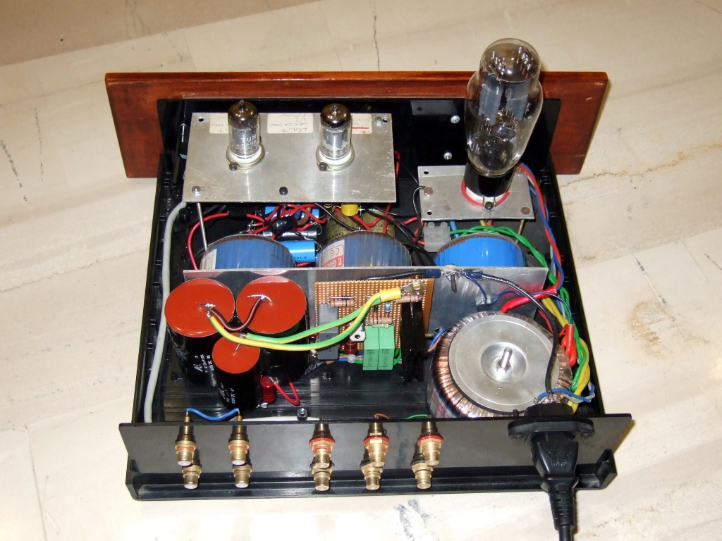

I have made one 10 years ago which is good if you like 12AU7 and you can handle 18dB gain. Has 5R4GY or analogous rectifier, MKP CLC and a Mosfet Maida reg for PSU. Pictured with Russian NOS rectifier and Tangsol NOS 12AU7s.
