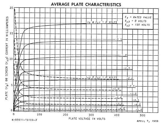

More to the point why would you want to? The 12AU6 is not particularly linear and is extremely noisy, hummy and microphonic compared to say an EF86.
Just because someone says it, that doesn't make it so. See for yourself; here are the 6AU6A characteristics. These look pretty linear, wouldn't you agree? As for "noisy", "hummy", and "microphonic", well, there were a lot of these produced "on the cheap". Buy inferior tubes, expect inferior performance. There are also good ones out there. Now triodes can be better than pentodes in terms of linearity, noise, and distortion. They are also easier to use and design for. However, you shouldn't be afraid of small signal pentodes if you believe that these will get the job done better.

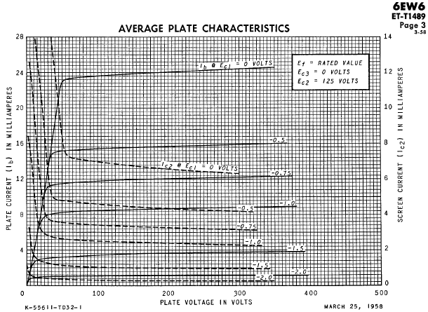

For comparison purposes, here's another small signal pentode: the 6EW6. Now that's what I would call a nonlinear characteristic. Of course, the 6EEEEWWWW!6 was never intended for audio amplification. This is a high gain RF voltage amplifier, such as you'd find in an IF amp. In that case, the nonlinearity and distortion is of no consequence since an IF amp will include at least double tuned xfmr's, and perhaps narrow BP filters as well, to clean up the messes this tube will make.

Most tubes that were originally designed for IF amplifier use had characteristics such that the tubes gain changed with the operating point. This was done so that the receivers AGC (automatic gain control) function would work. The gain of the receiver was reduced on strong signal, and increased on weak signal. This was done by adjusting the grid bias. Often these types are called "remote cuttoff pentodes". These tubes are designed to be non-linear on purpose. if you take one apart you will see that the control grid is not evenly spaced. These tubes (6BA6, 6SK7 etc) are generally not well suited for audio. Other IF tubes like the 6AU6 or 12AU6 will work for audio but they are not well suited for large signals since the sweet spot may be small. They should be fine for a guitar preamp. It was my experience from my limited testing that there is a pretty large variation from tube to tube. I have seen the 12AU6 used for the input stage in low cost guitar amplifiers from the 1950's that ran off the AC line without a transformer. I have an old Electrolab amplifier that was made this way. A truly shocking experience.
