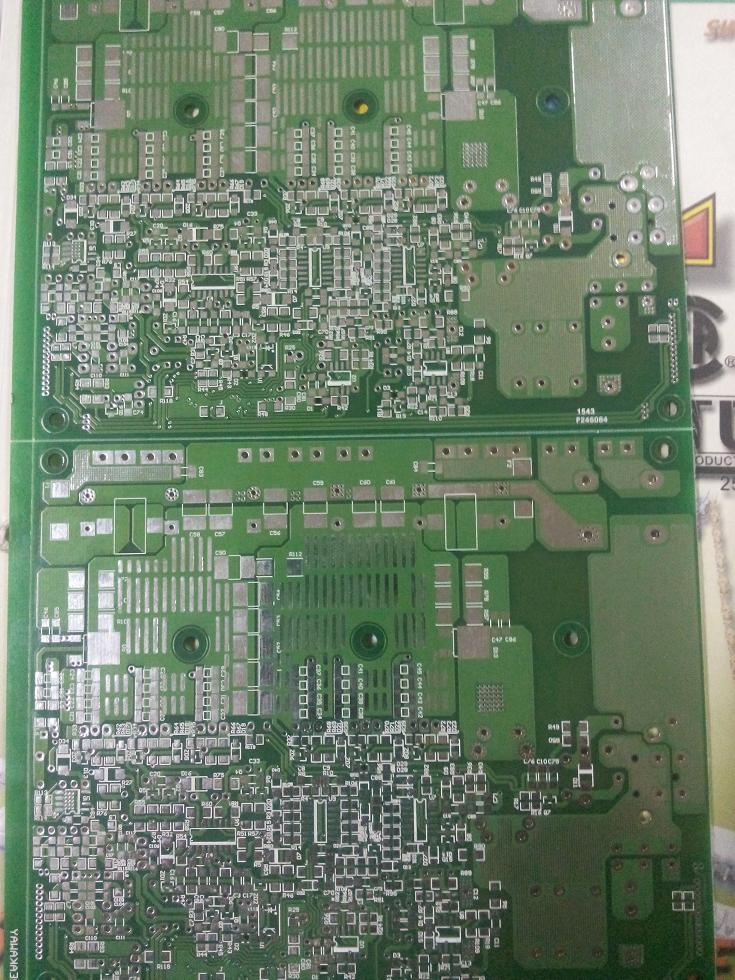

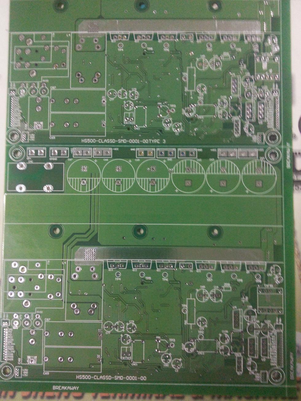

and the basic specs of the Class- D is as follows.Glad to see a design contribution again.

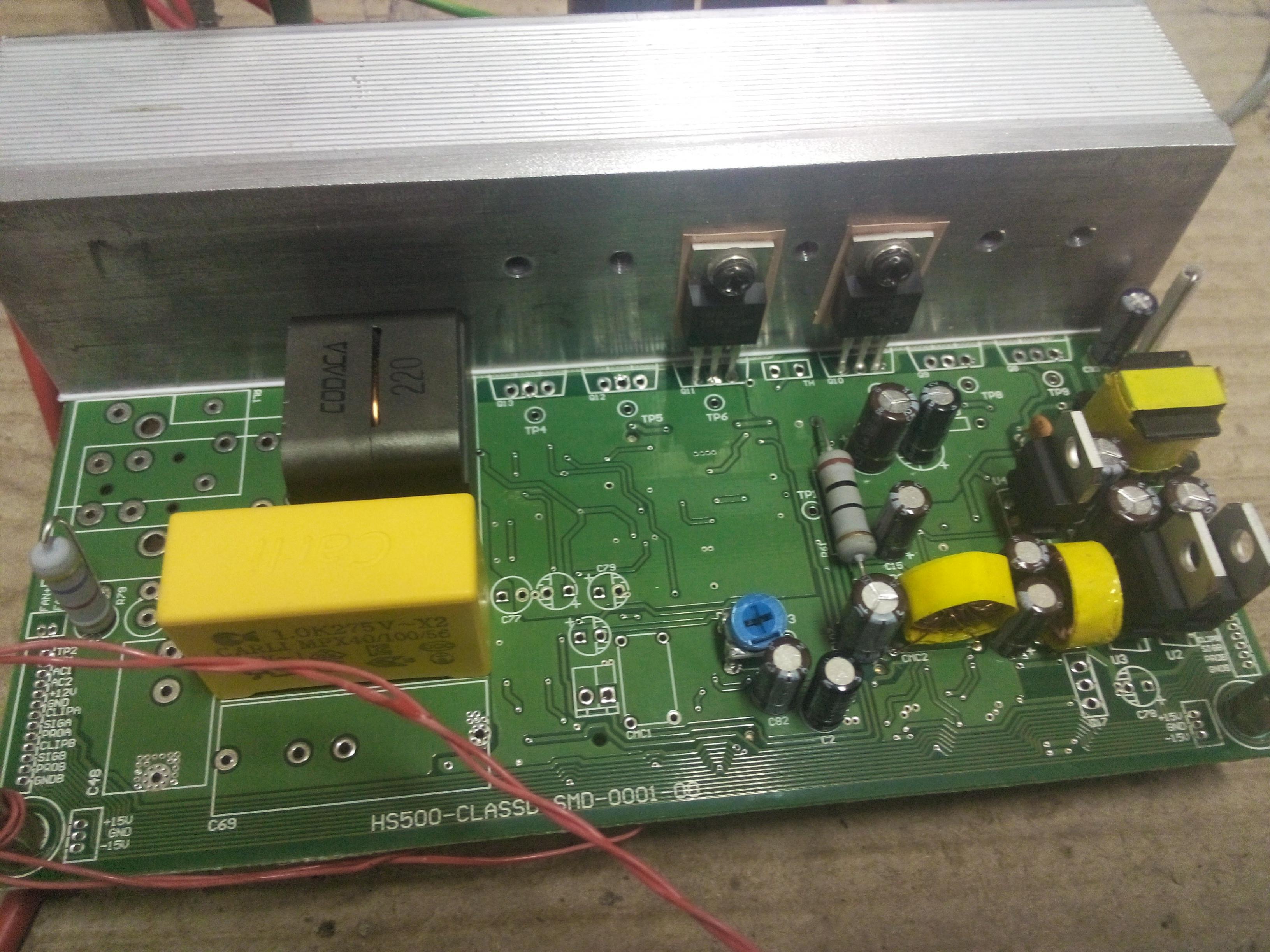

A first view to your PCB looks like you have spend some thoughts on keeping low the inductances of the most crucial loops - keeping fingers crossed.
Components:
- The picture of your older version shows the output filter choke with dual or
triple layer winding. Single layer is definitely preferable in terms of parasitic winding capacitance.
- You should have a look to the AC current stress of C90 and C92.
It is hard to judge without knowing your switching frequency + rail voltages + inductance of the output choke ... but seeing the target power and load impedance, it is likely that already the current ripple during idle is critical for average e-caps.
1. Switching freq = 380Khz
2. Intended Supply Range = +- 70-95VDC
3. O/p Inductor = 22uH
this is a self oscillating class-d amp based on the application note from IRF(IRAUDAMP9), no i didnt simulate it ,

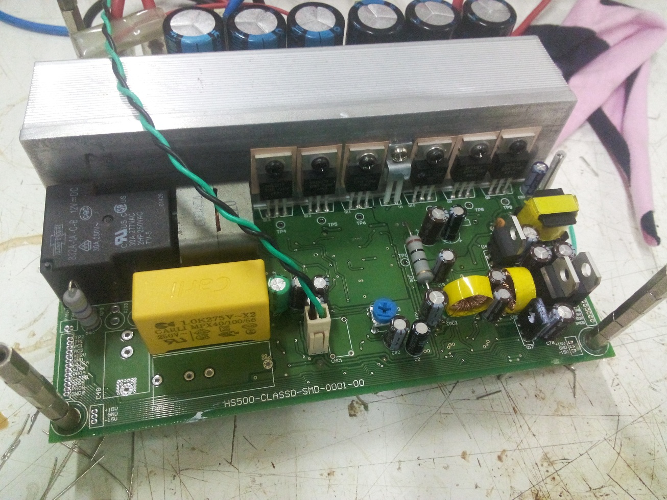

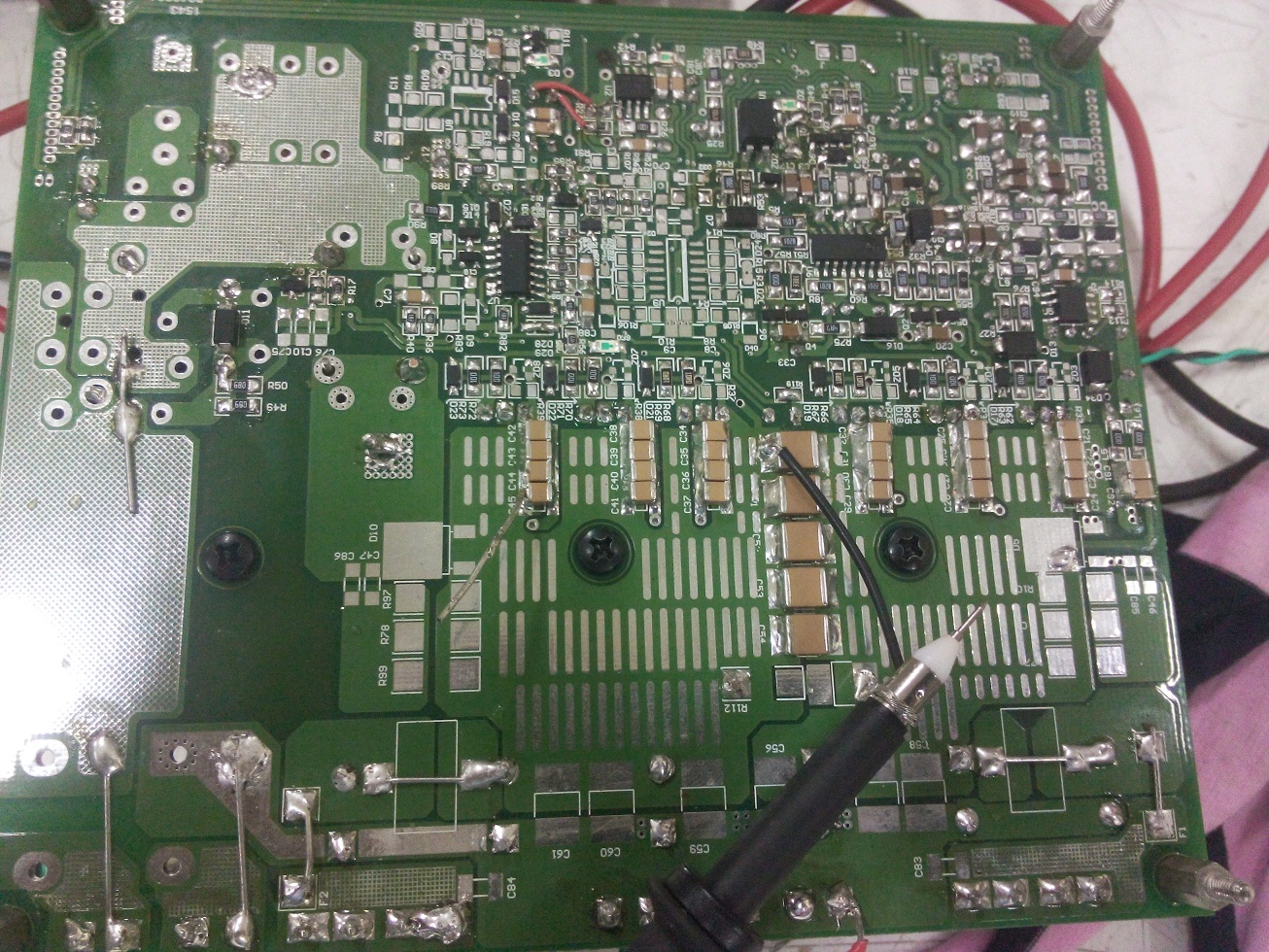

Completed assembling the power stage , and pulled 800W @ 4E , the amp seemed quite happy doing that. Uploading pics of the assembled amp top and bottom side. currently trying to set the OCP levels.
regards
regards
