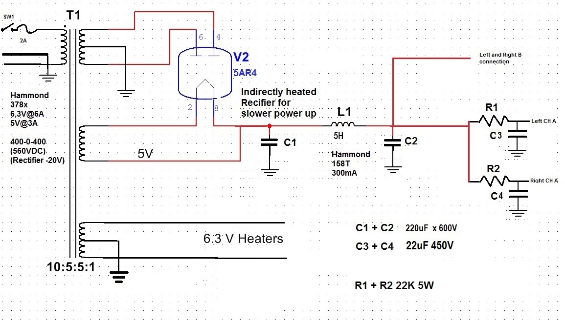

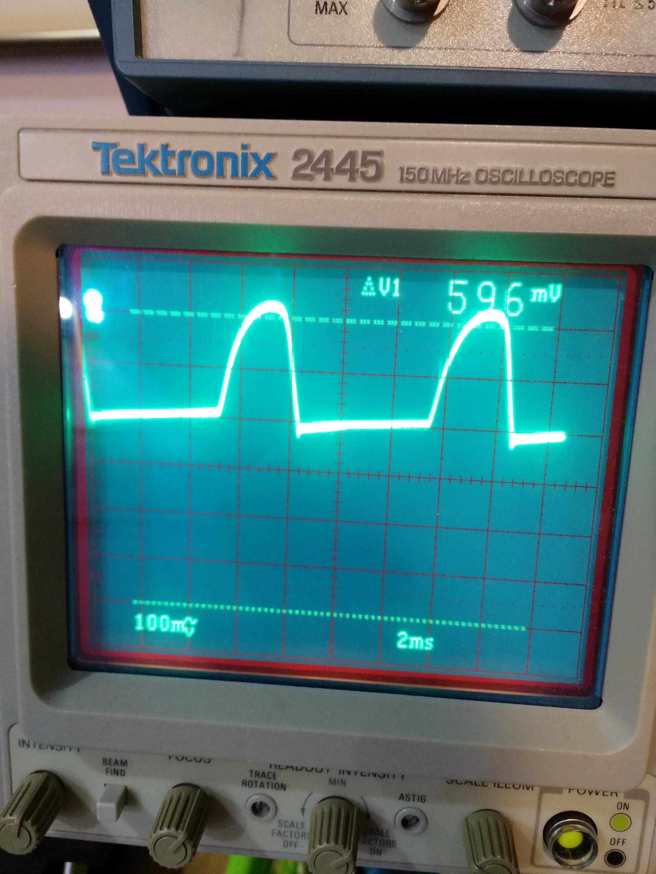

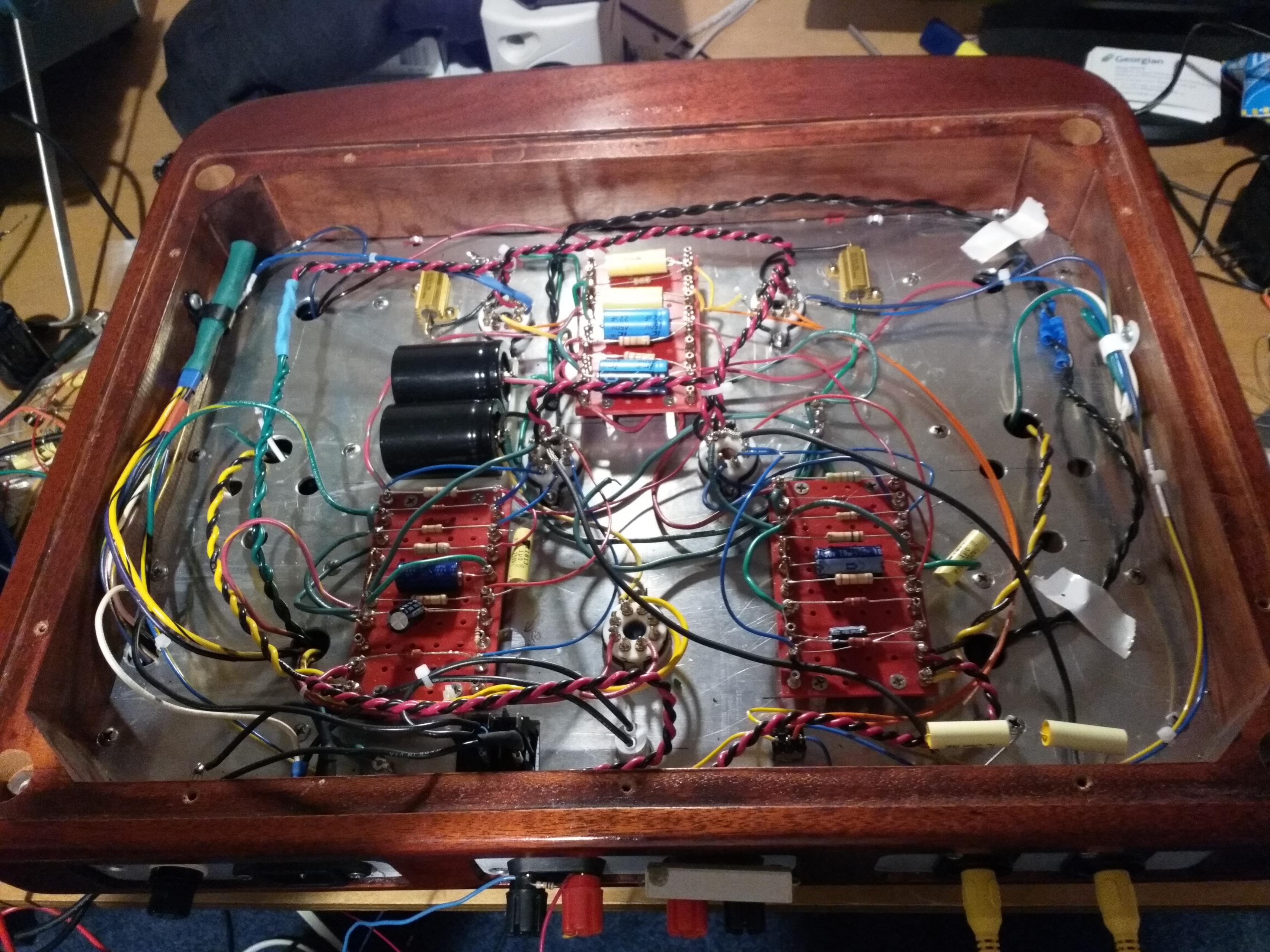

I am building a stereo SE Amp with 6SN7's and KT88's. I built the Amp one channel at a time and got them running great! When the second channel was finished it tested fine as well. When I hook up my audio system pre-amp I get 120Hz hum. If I only drive one channel its fine(short the other channel to GND), both simultaneously I get hum. The hum is interesting (attached) It looks like a capacitor charging curve and is inverted on the opposite channel. I have attached my schematics and a picture of the scope connected to the KT88 coupling cap. I thought I was good at electronics until this one. Any input would be greatly appreciated I have been at this a while. I'm missing something!

Ground loop. Place a ground loop breaking network between the internal audio ground and the chassis safety ground. (Anti-parallel diodes in parallel with a 4.7 - 10 ohm 3W resistor - size diodes for worst case fault current in event of a direct primary to secondary short in the power transformer, you can use a high current bridge rectifier if you prefer.)

Thanks everyone, I really needed the reminders to pay attention to grounds. I know that you probably answer the same question multiple times weekly but I appreciate your feedback. Ultimately I Pulled all my grounds back to a signal ground (this solved 85-90%) then I connected it to earth/chassis ground with 10 Ohm / 100nF Cap and diode network and that got it to showroom quality(undetectable hum/buzz by ear). The Diodes are a great idea to force the fuse to blow just in case signal ground changes significantly relative to earth ground. I will also drop the size of my tank capacitor to 60 uF as suggested but I don't have one handy just yet. Again Thanks!!

According to the diagram your FB is grounded.
