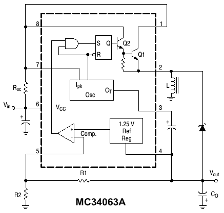

MC34063 switching regulators are found in nearly every car cellphone and USB charger. The application note clearly shows how to hook one up for negative output, and board layouts are provided, if you can't easily alter the charger layout.

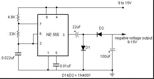

I've found a 555 circuit to invert voltage (Attach), Problem is it apparently drops a little voltage from the input. Can somebody please help me get around this, +14.5 Volts in I need -14.5Volts out for a few opamps . Many thanksEven the 555 will do the job

You can use Schottky or germanium diodes in place of the 1N4001s to help minimize the voltage drops, and add regulators to provide ±10-11 volts for the op amps.I've found a 555 circuit to invert voltage (Attach), Problem is it apparently drops a little voltage from the input. Can somebody please help me get around this, +14.5 Volts in I need -14.5Volts out for a few opamps . Many thanks
Try this:
MC34063A design tool
Just tell it the input is 15 and the output is -18 (and say 100 mA, 100 mV p-p ripple, and 33 kHz). Then hit the Calculate button. (You can then regulate the -18 to -15, with a three-terminal regulator IC circuit.) You can tell it to switch at up to 42 kHz, which should give smaller inductor and output capacitor values.
The results will show something like:
Ct=688 pF
Ipk=463 mA
Rsc=0.648 Ohm
Lmin=521 uH
Co=155 uF
R1=5.6k R2=75k (17.99V)
and it will give something like the attached schematic.
Make sure you also try specifying 300 mA instead of 100 mA, for the output current. You can use a range of component values, in some places. Entering 300 instead of 100 mA gives, for example:
