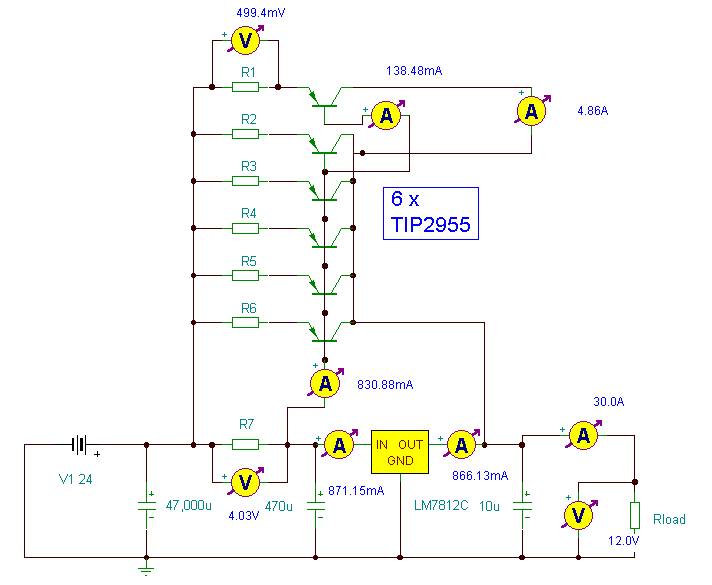

My name is Andrey.I found the schematic of 12 VOLT 30 AMP POWER SUPPLY on the Internet at the following link : Circuit Exchange International (CXI)

I am not an expert - have only basic knowledge in electronic. I want to build such a power supply and I have few questions about it. May be some one can help with the answers.
One of the author's concerns is the six power transistors TIP2955. In the case of a short on the "OUT" the six or at least some of them will be burnt. Does anyone has an idea about a simple schematic solution - to add to the schematic simple short circuit protection? And another question: If the LM7812 has built in "short" and "thermo" protection, why the 1 AMP fuse to protect the OUT of the IC LM7812 needed? Thanks

In reply to DUG's statement: I understand the purpose of the both fuses. But why the LM7812 needs a fuse if it has a built in protection?
I agree with you tomchr, that a fuse protection is not reliable. That's why I asked my original Q. how to protect electronically the power transistors.

PS abandon your 1st schematic! I doubt anyone has built that thing as drawn.
protection? And another question: If the LM7812 has built in "short" and "thermo" protection, why the 1 AMP fuse to protect the OUT of the IC LM7812 needed.
cuz it's a crude current dump circuit, depending on output loads (read reactive) and dynamic events like start up turn off and output shorts the helper PNP pass devices could drive high current back into the 3 terminal regulator. These current dumper schemes only really work reliably under steady state conditions.

If you go linear, there are better, cleverer options than the circuit you found, see here for example:
http://www.diyaudio.com/forums/powe...d-psu-using-pass-transistors.html#post4071001
Better regulation, lower dropout, predictable current limit, etc

I have just recently visited these two exact circuit configuration in this thread,
http://www.diyaudio.com/forums/chip-amps/261125-lm3886-problem.html#post4037783
As you read through you will find how I have discovered that both of these configuration suffer greatly in load regulation as more current is drawn form the regulator.
Since my circuit here was intended for up to 60v of input voltage I ultimately used the LM317HV basically as just a transistor and added a precision opamp and a volt reference to keep the output voltage in check.
The result was a very stable and very quiet regulator.
The final circuit as built is found here minus D1 it is not need and was only there to see what it would do and I forgot to delete it when I made the post,
http://www.diyaudio.com/forums/chip-amps/261125-lm3886-problem-2.html#post4073963
In the process of this design thread I had discovered a non-linear current limiting action of the Regulator chip itself.
You would think that if the voltage drop across the regulator itself was low that it should be able allow more current to flow through the device, But, this is not the case!!
At a higher voltage output settings, it limits the current output more so by dropping the voltage earlier than it does when it is set at a lower output voltage and drawing more current.
It is the opposite of what you would expect!!
By Using LTspice I found it to be necessary to use another driver transistor to drive the stack of paralleled output transistors in a darlington configuration in order to not exceed the current limiting factor of the regulator chip itself.
