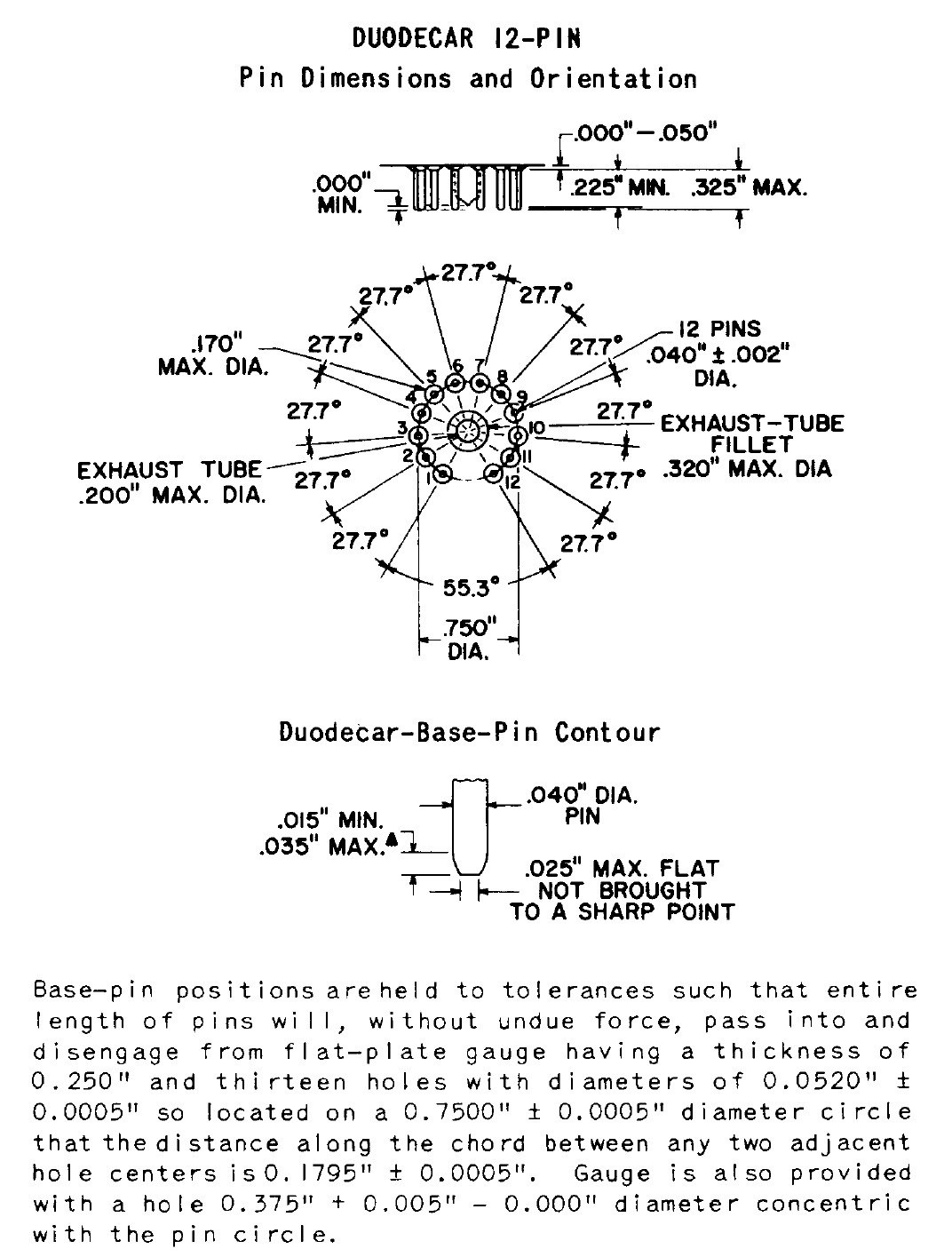

12 pin compactron pinout dimensions ?
The circle diameter that the pins are located on appears to be .75". I checked a 6JM6, but the pins are not located 180 degrees from each other, so they measure ~.790 - .040 pin dia. = .75.
Oddly, the Wikipedia entry says the pins are on a 27mm circle, for a B12C socket.

Yup, and there are different dims reported elsewhere, which is why I'm looking for a mechanical drawing.
The circle radius for a PCB mount socket won't work. I'm looking to connect the tube directly to pcb so spacing needs to be right on or there's risk of cracking the glass when plugging it in.

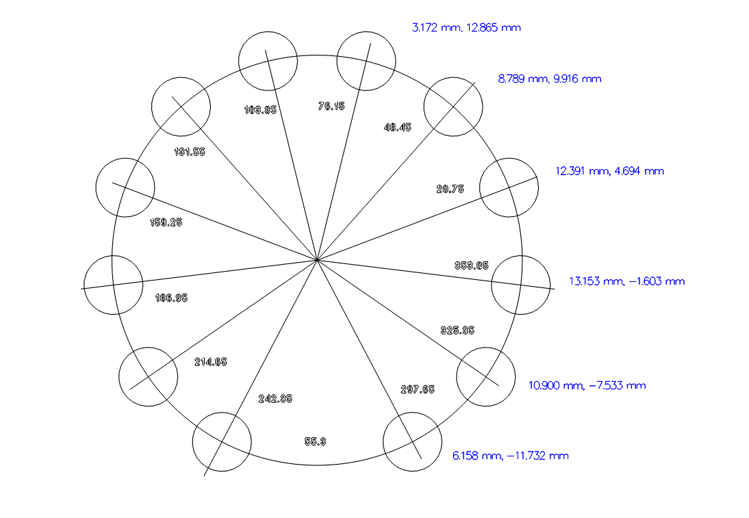

Hey guys ! Thanks a lot for taking the time to measure !
Still, one problem is getting the pin location on the circle. As Vinyl58 said above, the pins are not directly opposite each other through the center-line, but offset. So a drawing showing radius angle from pin to pin would help a lot. I've never seen one, but find it hard to imagine the manufacturers never published them. They've got to be out there . . . . .somewhere.
B12c Duodecar B12C base (IEC 67-I-17a) Compactron T-9 construction/E12-70 base
19.1mm (3/4") circle,
11x 27.7° then gap between pins 12 & 1
pin diameter 1.02mm

Thanks for posting that. The angle is the missing key to the compactron puzzle. No surprise, the Wikipedia entry wrongly states the pin circle diameter as being 27mm, when it's really 19.1mm.

Hey, thanks Payloadde ! That was the ticket!
OK, this is how i figured it out in ExpressPCB. Started with a large 5 in.radius circle > calculate chord length for 13 sided polygon > circles at chord length > lines from intersects to center > then add actual pin circle diameter (the little white one at center) . Later on I'll finish it with pads for pin sockets and post the file here. (Sorry BMike, I've haven't used DesignSpark.)
Thanks again guys!

Compactron was GE's trademarked name for the 12 pin duodecar base also used by RCA and others. All 12 pin tubes in the US have .040 inch pins. The pin angle is 27.69 degrees, 13 pins with one missing.

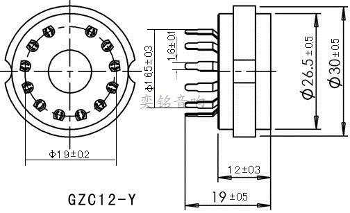

Is there a mistake in this drawing where DIA 16.5mm should be 26.5mm, since the DIA of pins is 19mm which is obviously larger than 16.5mm? Check the precision if you wish.
