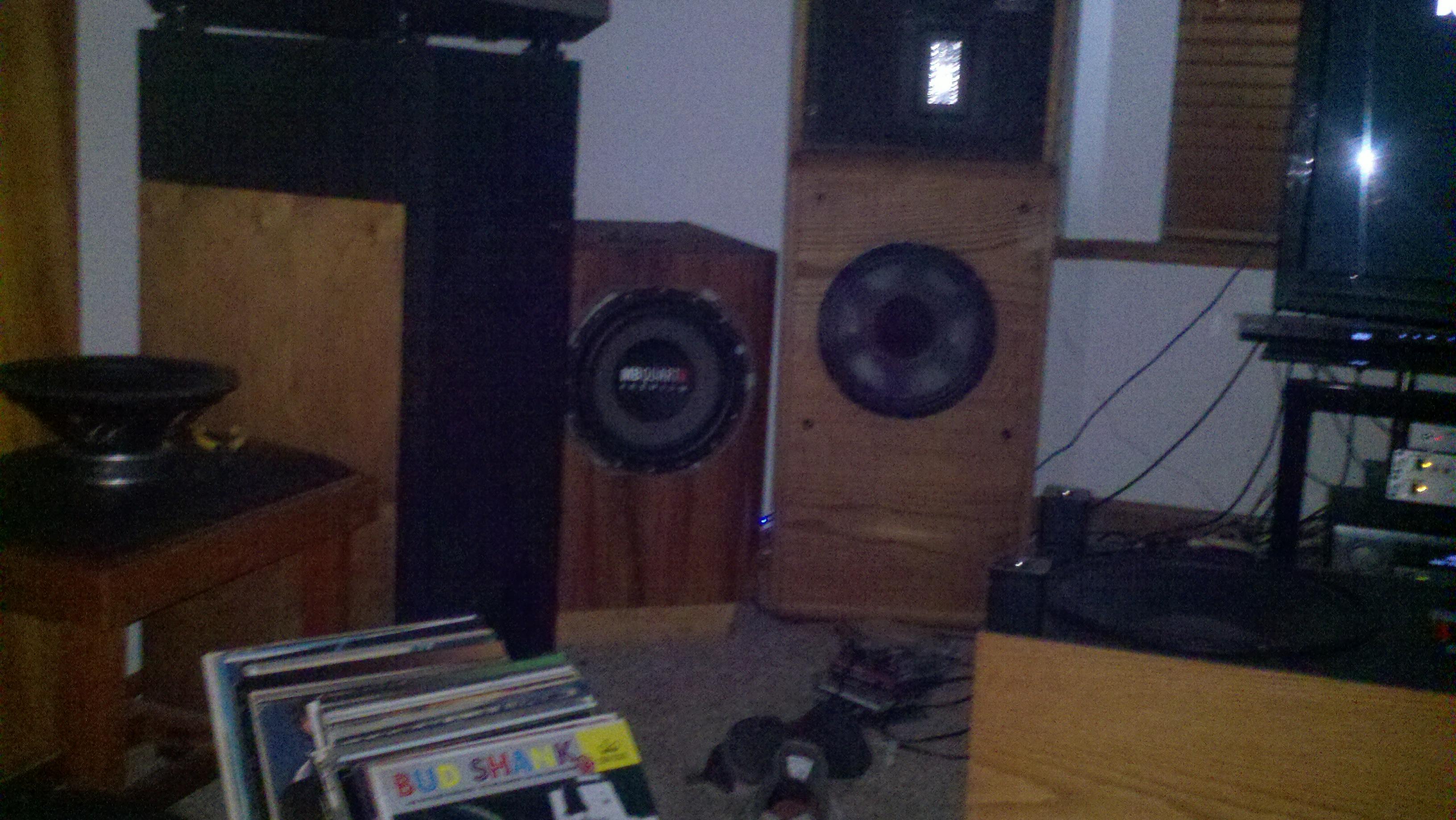

12 inch car sub in B&W 801 cabinets?

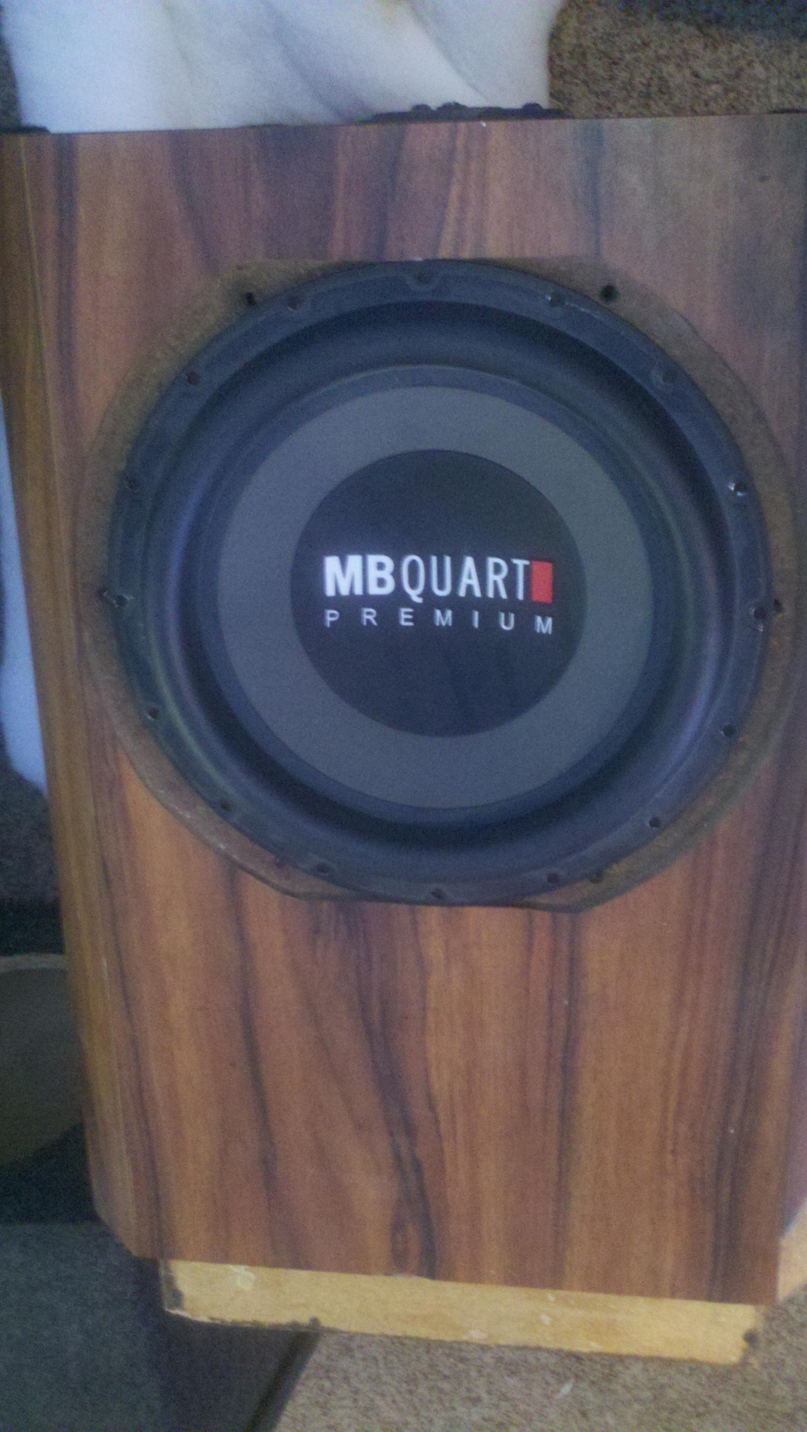

The MB Quart PWH 302 works fine in a sealed B&W 801 (clone) cabinet. Two should pretty much knock my socks off.

I got the second one going today. Two MB Quarts PWH 302s in B&W 801 sealed cabs now.
Pretty amazing bass!!! I am watching the new Netflix show with Kevin Spacey, and the bass in the intro sounds better than my old VMPS Larger. The cabs were basically free, so I have killer bass for under $200 total (not counting the crossover and the amp). This is a great woofer in a great box.
