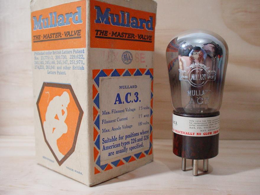

Looks very similar to 26, 1.5V filament
It actually is a British version of 26. It even says so on the box...

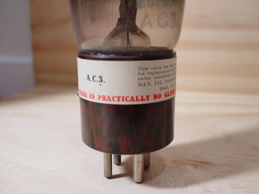

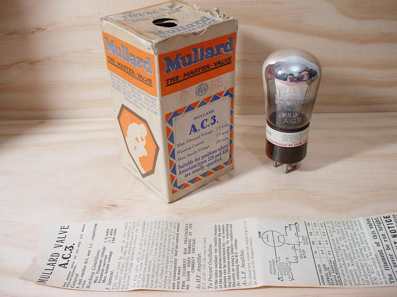

Here are photos of A.C.3, Carton, Wood-pattern base, and the plate structure (It's a mesh plate).
The carton design and Mullard's logo shows you what Mullard tubes originally looked like back in 1920s, quite different to the one that we normally come across these days.
