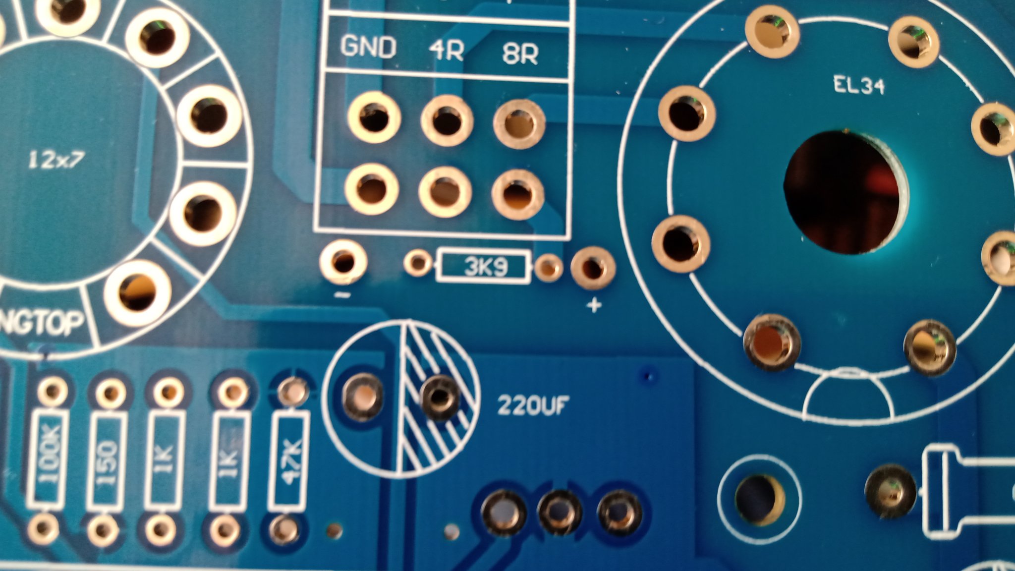

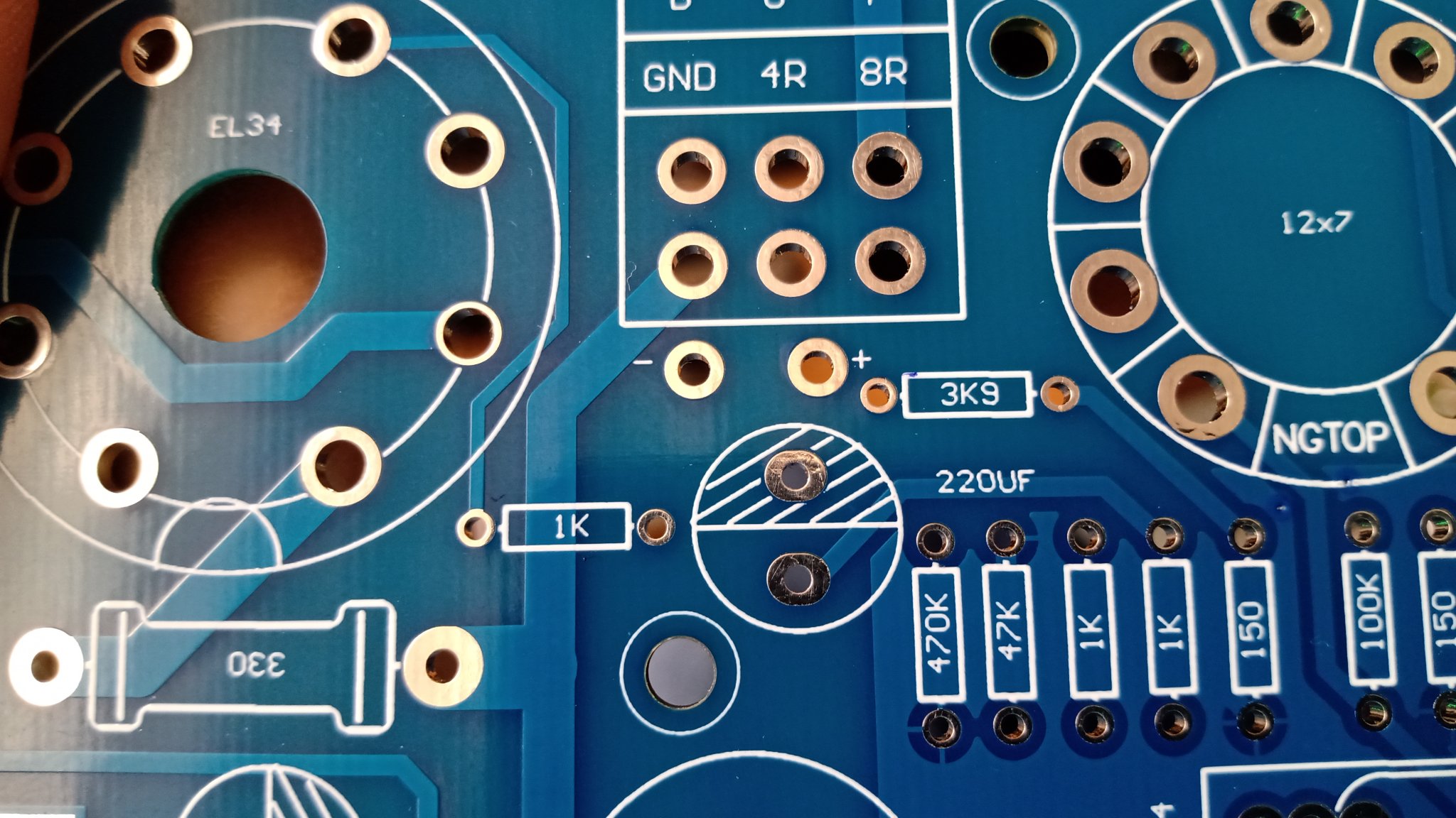

Hi all
I´m trying to build this Aliexpress amp kit. Checking the pcb I found two (+) and (-) points, possibly to measure voltage across 3K9 resistor. As far as I could learn this are the NFB resistors at 8ohm OPT tap. Please inform, what are the pourpose of this measuring voltage? Thanks in advance for comments and assistance
Caveat Emptor, buyer beware.
Sorry.
Hoping that a thread from 2015 that is not solved in 2023, requires some extra work on your part.
The PCB you have may, or may not, even be the original one.
Drawing out the complete PCB is a pain.
But it can help both now, and in the future if anything goes wrong.
