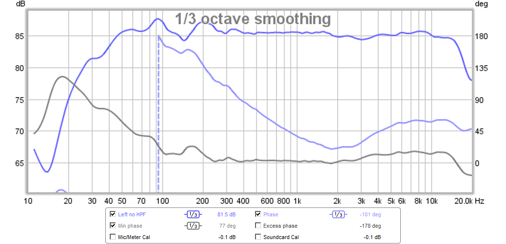

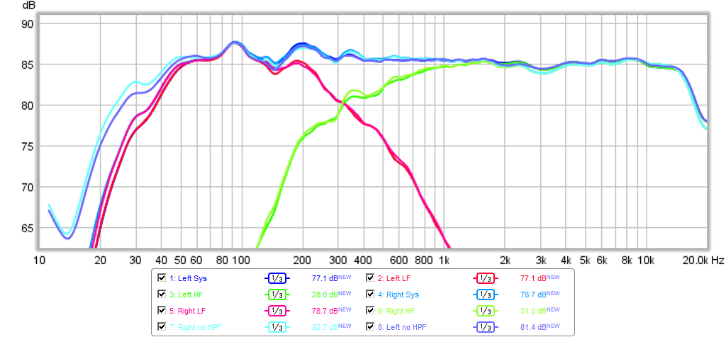

Here is the measured response (super smoothed to see where acoustic xo is located), and to see effect of HPF. This shows the individual speaker (left& right) measured responses at 0.5m overlaid on top of one another to check for parity between speakers (HF, LF, and combined). Without the HPF, the f3 is around 32Hz:
Here is the measured absolute and minimum phase. There are no phase wraps above 100Hz which is good. I measured a wrap at 1kHz on the left speaker yesterday and that may have been caused by stray inductance near the speaker cable which I cleaned up:

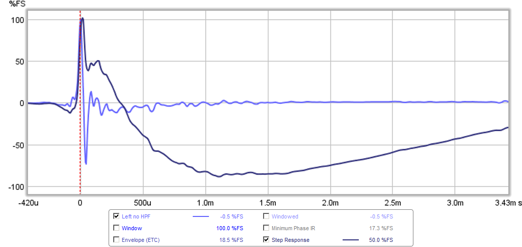

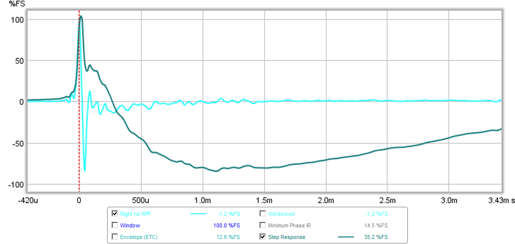

Here is the measured impulse response and step response for each side:
Left
Right

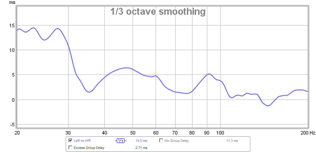

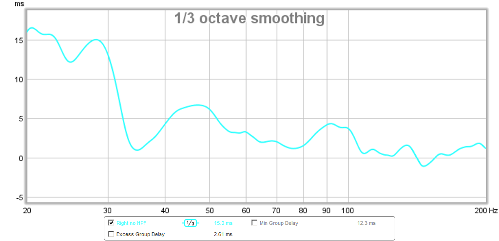

Here is the measured group delay for each side:
Left
Right

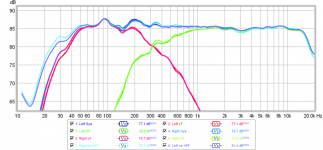

![487640d1433930977-10f-8424-rs225-8-fast-ref-monitor-10f-rs225-fast-tda7492-xo.png](https://www.diyaudio.com/forums/attachments/full-range/487640d1433930977-10f-8424-rs225-8-fast-ref-monitor-10f-rs225-fast-tda7492-xo.png)

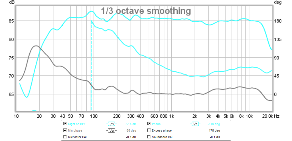

Left
![487641d1433930977-10f-8424-rs225-8-fast-ref-monitor-10f-rs225-fast-tda7492-left-phase.png](https://www.diyaudio.com/forums/attachments/full-range/487641d1433930977-10f-8424-rs225-8-fast-ref-monitor-10f-rs225-fast-tda7492-left-phase.png)
Right
![487642d1433930977-10f-8424-rs225-8-fast-ref-monitor-10f-rs225-fast-tda7492-right-phase.png](https://www.diyaudio.com/forums/attachments/full-range/487642d1433930977-10f-8424-rs225-8-fast-ref-monitor-10f-rs225-fast-tda7492-right-phase.png)

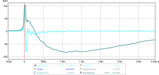

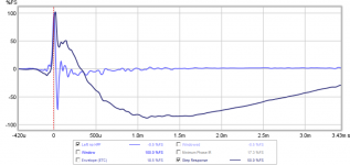

Left
![487643d1433930977-10f-8424-rs225-8-fast-ref-monitor-10f-rs225-fast-tda7492-left-ir.png](https://www.diyaudio.com/forums/attachments/full-range/487643d1433930977-10f-8424-rs225-8-fast-ref-monitor-10f-rs225-fast-tda7492-left-ir.png)
Right
![487644d1433930977-10f-8424-rs225-8-fast-ref-monitor-10f-rs225-fast-tda7492-right-ir.png](https://www.diyaudio.com/forums/attachments/full-range/487644d1433930977-10f-8424-rs225-8-fast-ref-monitor-10f-rs225-fast-tda7492-right-ir.png)

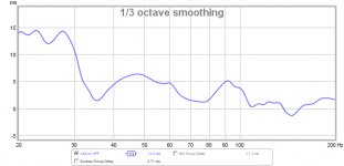

Left
![487645d1433930977-10f-8424-rs225-8-fast-ref-monitor-10f-rs225-fast-tda7492-left-gd.png](https://www.diyaudio.com/forums/attachments/full-range/487645d1433930977-10f-8424-rs225-8-fast-ref-monitor-10f-rs225-fast-tda7492-left-gd.png)
Right
![487646d1433930977-10f-8424-rs225-8-fast-ref-monitor-10f-rs225-fast-tda7492-right-gd.png](https://www.diyaudio.com/forums/attachments/full-range/487646d1433930977-10f-8424-rs225-8-fast-ref-monitor-10f-rs225-fast-tda7492-right-gd.png)
Overall, I think a pretty nice result and I double checked my listening levels at the listening position is 85dB with both speakers, so individually, I am running them at 83dB at the LP which is about 2m away. So actual SPL's at 1m are 89dB per speaker - still within range of reasonably low harmonic distortion numbers. The speakers are extremely well balanced left and right and I think this helps to give an excellent stereo image and solid sound stage. I can place the instruments in the jazz ensemble very well with eyes closed. I am going to lock down this config for a while and just enjoy listening to it.

I measured the above at 0.5m in front of each speaker individually. I haven't measured at LP recently but recall an effect of room modes and floor bounce. Obviously it won't be as flat below 500Hz but the HF's were very similar to the 0.5m data. I'll do a measurement at LP in the coming days and see how it looks.
The HPF allowed cleaner lower distortion bass and a bit more power but there was not much content down there anyway while the GD suffered.
This is probably what causing the phase problem in the lower bass. I forgot if Linkwitz has ever mentioned this HPF in his LT implementation. You can create a clip (such as the Norah Jones) to see if the problem is fixed.
