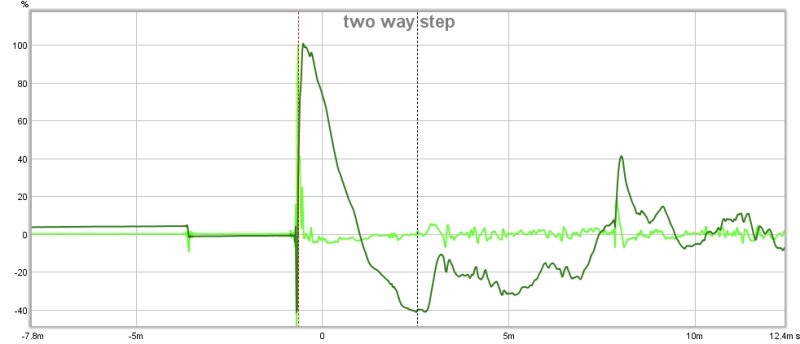

What setting do you choose to get a clean SR graph? mine looks pretty much like a raw impulse response
Click on the step response check box at the bottom where the legend is.

Yeah, I got that. I had to adjust the settings to clean it up though, it looked really noisy. I think I got it working
Read that Audiophile article on step response. Your SR actually looks decent - it is supposed to be a right triangle with a slope down like yours, the wider the decay the better. If your speaker has response down to 10Hz then the triangle would be about 100ms wide. When time alignment is not perfect the sharp leading spike is not aligned with the hump from the woofer and mids. You have reflections or diffraction edges near your driver about 3ms from tweeter.
Thanks! Yes, I know about the reflections. You can see the window(dashed line) that I had set. I figured the junk to the right is reflections.
Which is the sharp leading spike and which the hump from the woofers? I assume you mean how it slightly leans forward.
This is from a design from last summer and I doubt these are even final measurements, but more in progress. It's just something I pulled up to see if I could get the step to show in REW
