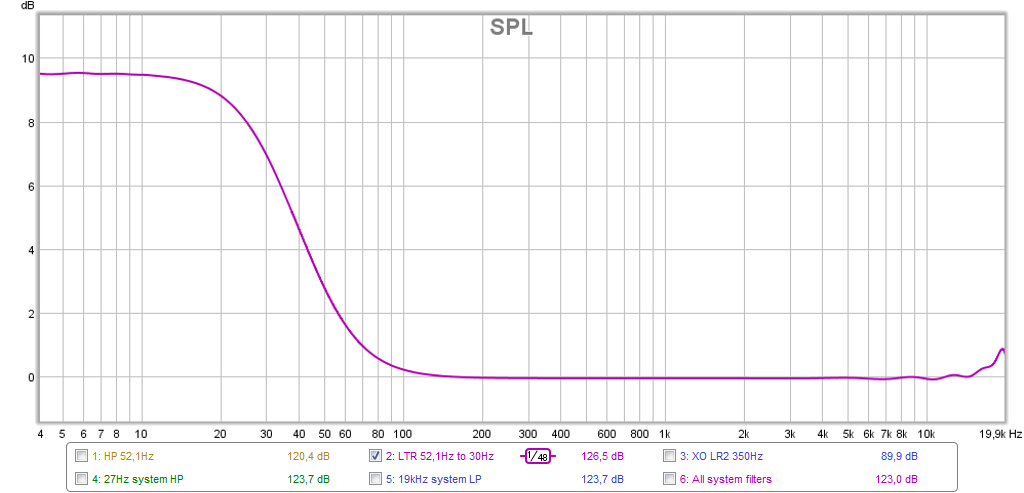

Electric linkwitz transform, the more low we transform the lower or less GD we get, but trade off is the higher gain needed the lower we like to transform, the actual one from 52Hz down to 30Hz takes out 9,5dB SPL in BW Q config.

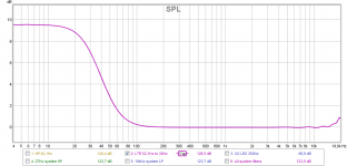

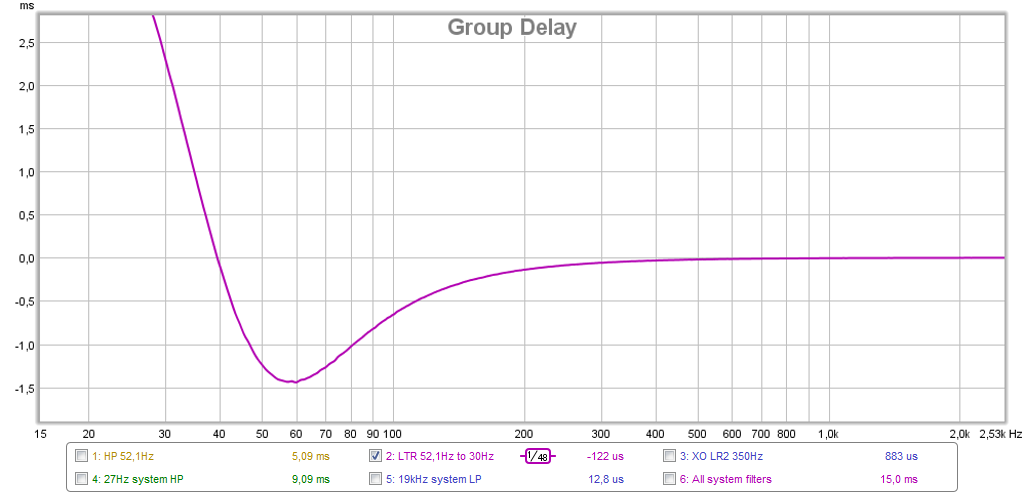

For info here is FR and GD for a linkwitz transform from BW Q at 52Hz to BW Q at 30HZ. The fun thing is from 500Hz down to 39Hz timing is faster than real time :rolleyes:.
Funny thing, the shape of the curve reminds me of the paradox of quantum tunneling and superluminal speed of particle penetration through a quantum barrier. Apparently, this is not any violation of physics... :)

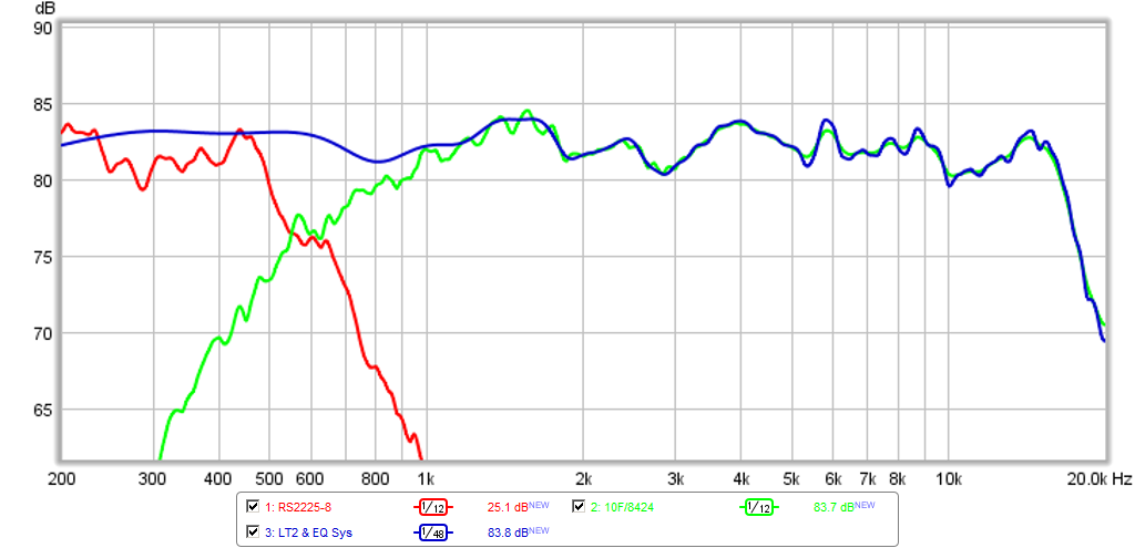

Fortunately, the RS225-8 is one of the flattest woofers in existence usable up to at least 2k. The 10F in the current Dagger starts falling off at 150Hz I think. So I can try the 500Hz 1st order and see what happens.
I did get a pretty deep null in 2nd order which went away when I flipped polarity on one of the drivers.
I think the TC9FD and TG9FD are hole-for-hole matches with the expensive 10F sibling. I could just plop it in and listen. However, the weaker motor of the TG9/TC9 require a larger volume than 1.1 liter to get a sufficient deep extension. XO may have to be set a bit higher back to 400Hz or so...
Although, as you say mp3 may be the limit so a lossless FLAC file may have to suffice, albeit very short FLAC clip.
The 10F might suit with 6dB/octave electrical filters, but the RS225 certainly does not. It has a massive peak in the third order distortion at 1200Hz that will not be properly suppressed if one switches to a first order electrical filter. You should stick with a 2nd order.

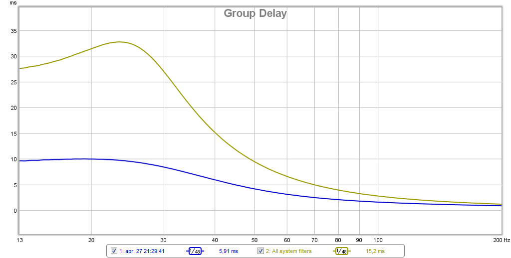

What i said about GD prediction in 8-10mS at 40Hz was some guessing looking at the system bandpass. Did a new run and see it could end up better but it depends following is true, that actual driver have TS data as printed in datasheet and actual box volume is tuned to exactly BW Q then at 40Hz says 5,9mS. Plot below blue is new prediction and olive with the old HP filter. Could be curious to hear data where real measurement ended up without the electric 27Hz HP filter.
Filters used for test was:
1. Acoustic high pass filter at 52Hz 2.order BW for model of sealed box.
2. Electric linkwitz transform at 52Hz BW down to BW at 30Hz.
3. Electric LR 2.order at 350Hz XO filter.
DSP setup for filters testing is same as explained #10.

Again, thank you for the great analysis. My internal box volume truly is 24liters but then there is some bracing and RS225 self volume so I am guessing closer to 22 liters when all is said and done. However, doesn't the pink fiberglass stuffing change the box Q as well as some wall flex of the XPS walls? I can measure the box impedance with the wonderful DATS tool and see what the impedance sweep provides. The RS225-8 measured parameters were close but Qts a bit higher than spec. IIRC I measured Qts of 0.43 vs spec of 0.38. Fs was close as well as Vas.

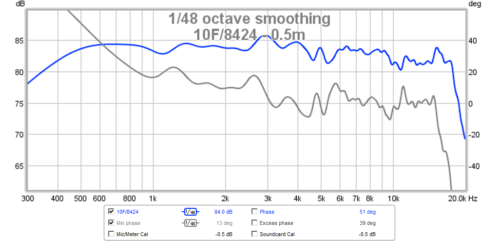

Here is the trapezoidal baffle:
Compared to offset rectangular baffle:
479717d1430079914-10f-8424-rs225-8-fast-ref-monitor-10f-8424-rs225-8-fast-lt-eq-4ms-gate-fr.png[
