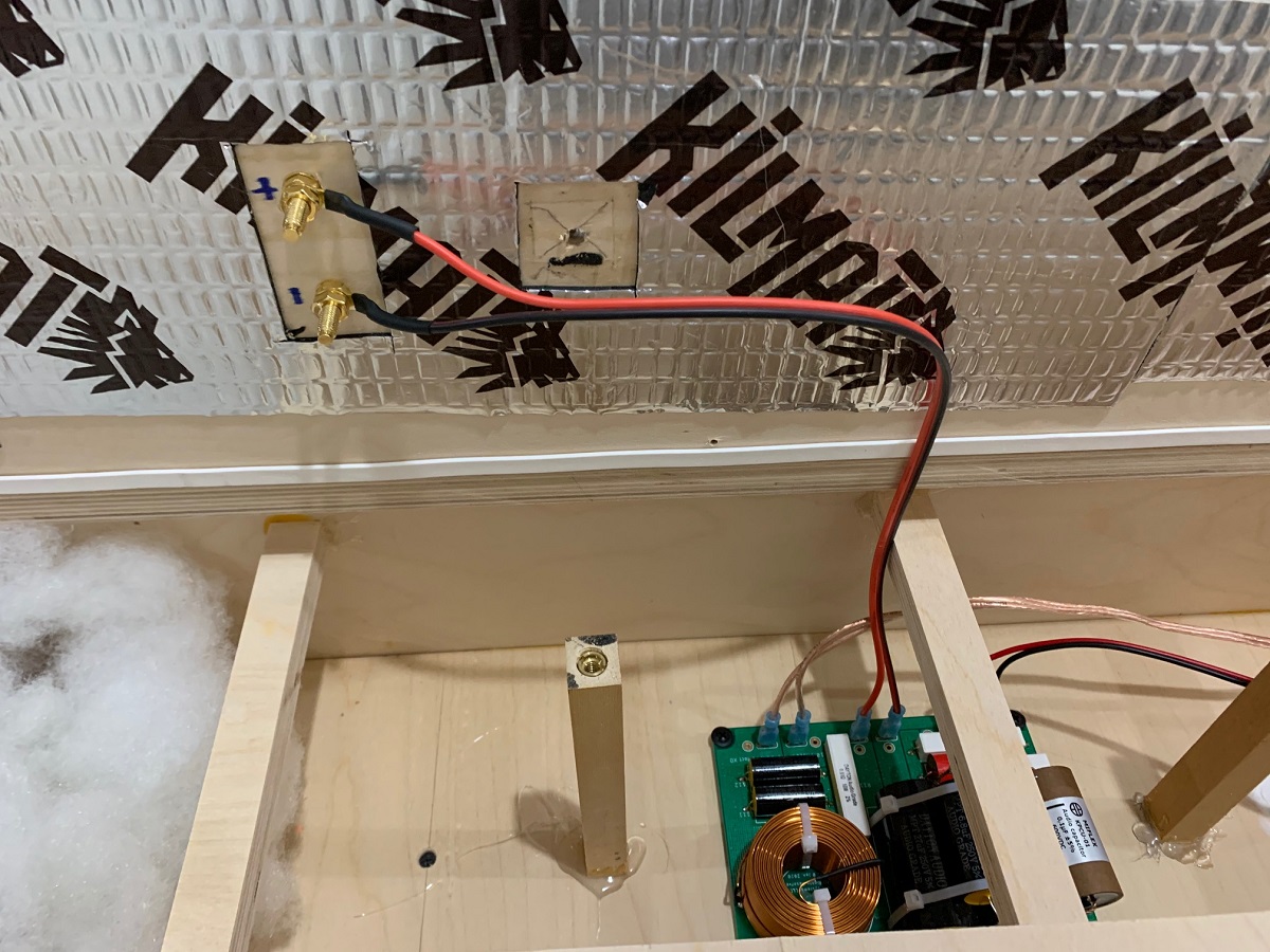

The FAST TL's are up and running! Installing drivers, crossovers, and binding posts, and adjusting stuffing takes surprisingly longer than you would think! About 4hrs. The new 10F/RS225 FAST TL's are playing very nicely. Will let them break in for a few days and give some impressions then. They sound very good so far.

The bass is totally adjustable to one’s tastes by adjusting the stuffing. I have stuffing in the closed end up to the woofer, then a small loose amount right at the top of the turn. The rest of the line is empty except for eggcrate foam lining. Adding 5x more stuffing at the top hairpin essentially killed the bass from the TL. So you can really adjust it exactly from 0 to max. Max is pretty thumping - like having a subwoofer almost but better since it’s more defined and not mushy.

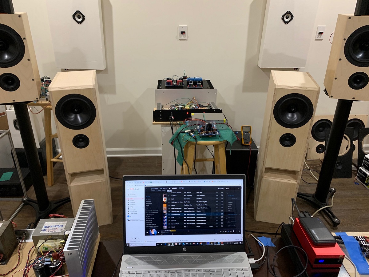

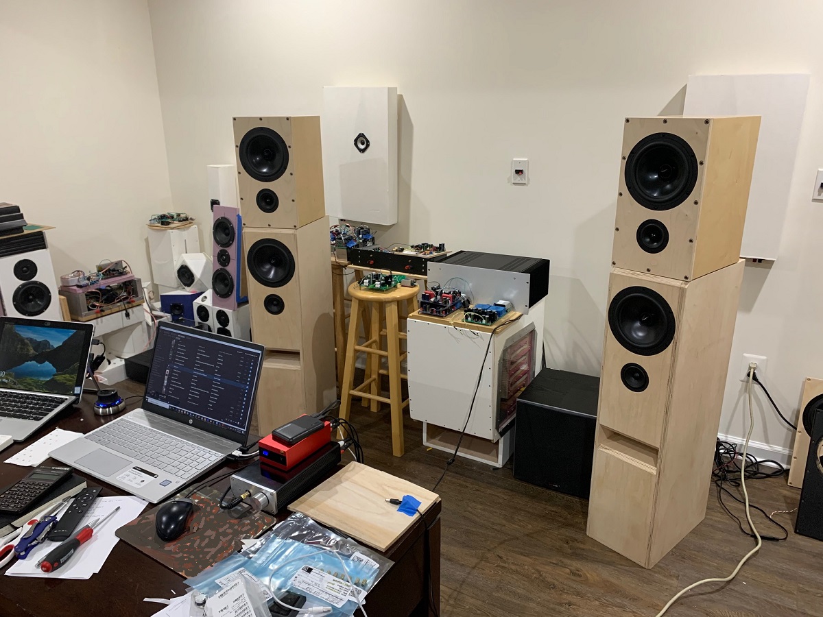

Regarding the height - my normal speakers are about 12in higher. This height is different, actually interesting effect of making the soundstage lower. It’s not bad at all. I will listen to it at this height for a few days. If I add feet it will probably be metal outriggers that add 2in or less. I find that the mass of the speakers is pretty substantial and I do not fear it tipping over even without feet.
The location of the vent port serendipitously doubles as an excellent handle to transport the speaker without bending over. Very convenient.

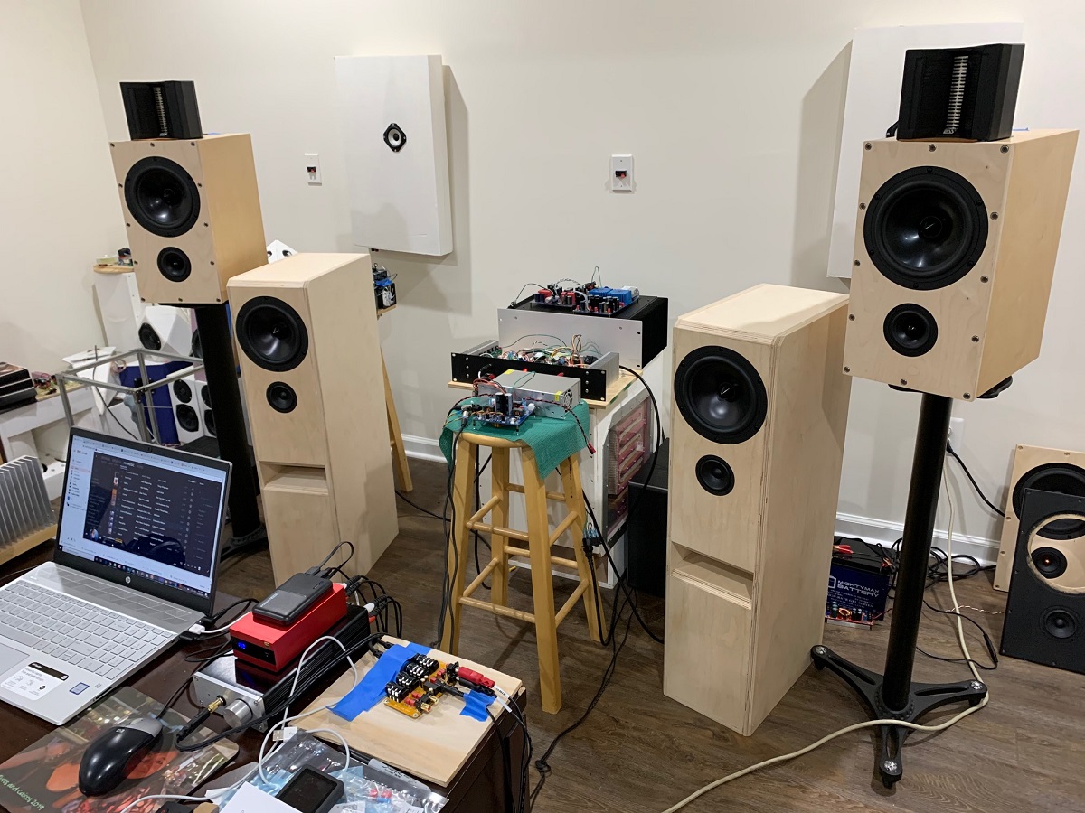

Well I solved my lack of floorspace for two sets of FAST speakers with the FAST Doublestack. :)
attachment.php
I have been listening to the new 10F/RS225 FAST TL speakers continuously for a few days now and I think I have enough info to give a listening impression. These speakers have given me a reason to embark on a process of rediscovering my music collection again because they are transformational speakers - they made what was already great about the 10F/RS225 FAST in a sealed box, about 10x better. It is not simply the extra articulate bass, but rather the whole midrange opened up because the RS225 is not pushing against a sealed box, but able to freely articulate the very important band from 50Hz to 2kHz where a huge amount of content is located. Songs which I thought I knew well because I have heard at least 500 times, was simply breathtaking or jaw droppingly great. I mean, the sound is stunning. I have mentioned this before - very few speakers stun me and force me to stop what I am doing and really listen and feel connected in a visceral way to the emotion and depth of the track. This is one of those speakers - it is truly special. The other thing that makes it 10x better is the effortless way it has power and dynamic range. I can listen to Beethoven's 5th by the Berlin Philharmonic in Ultra HD and get the softest to loudest notes, and the speaker never distorts. I can play Metallica or Ronnie James Dio and it never gets congested, I can play hip hop and it cranks out the SPL without distorting while kicking up the thump in a clear and effortless way, I can then listen to delicate chamber orchestra and the nuances of the oboe and flute are all there. The power reserve and clarity in the bass just feels so good. Higher SPL levels are achievable without stress - it seems like it gained and extra 10 dB of headroom. When playing hip hop the cone barely moves yet the punch is loud and clear, no distortion. All genres from pop, jazz, metal, instrumental, classical, folk - they all sound amazing. Some examples of music I listened to include: Omer Avital, Stan Getz, Tracy Chapman, Infected Mushroom, Natalie Merchant, Yuri Honing Trio, Massive Attack, Diana Krall, Black Sabbath, Neil Young, Ahmad Jamal, Dio, David Guetta, Beethoven, de Saint Colombe, J.S. Bach, The Who, Cassandra Wilson, 2Pac, Suzanne Vega, Anne Bisson, Queen, Metallica, ZZ Top, Norah Jones, Pearl Jam, and of course, Sade.
