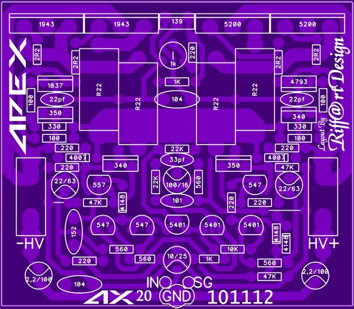

Ax 3ef
test condition :
5A 2x32ac,
1pair output,
bias 3v with remove pot + R220 and add parallel 220+560 on B to E Qbias.
load 4R spk.
sound is very clear, at low freq this AX is detail & stronger than B500...at least that's what I heard...
do I need to reduce bias sir?

if this is from ax14,why the 2sc4793 and 2sa1837 drivers are not at heatsink between output transistors? charging two output transistors is more difficult than one...
this 3ef is Ax20 sir...if this is from ax14,why the 2sc4793 and 2sa1837 drivers are not at heatsink between output transistors? charging two output transistors is more difficult than one...
If the drivers on +-50Vdc are operating at a bias current of 2mA then each has an average dissipation of 100mW. The average dissipation will go up a bit, if quiet music draws more than 4mApk through the driver/s.
The average dissipation will go up a lot, if the music draws hundreds of mApk at low duty cycle. Expect the dissipation on loud music averageing -20dB below maximum power, to increase maybe threefold compared to quiescent.
i.e. the driver dissipation could be ~300mW when playing loud in the domestic environment.
To220 drivers can operate for ever at an average dissipation of 100mW to 300mW without an added heatsink if the ambient temperature inside the amplifier is reasonable.
What is not reasonable is: Ta= 100degC due to outside temps of 40degC and nil ventilation for the heated air inside the amplifier.

thnks AndrewT you are absolutely right...If the drivers on +-50Vdc are operating at a bias current of 2mA then each has an average dissipation of 100mW. The average dissipation will go up a bit, if quiet music draws more than 4mApk through the driver/s.
