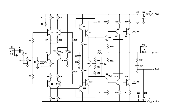

Q7 Q8 are 2SA1943 Q15 Q16 are 2SC5200. Are there any errors? 34 — ImgBB

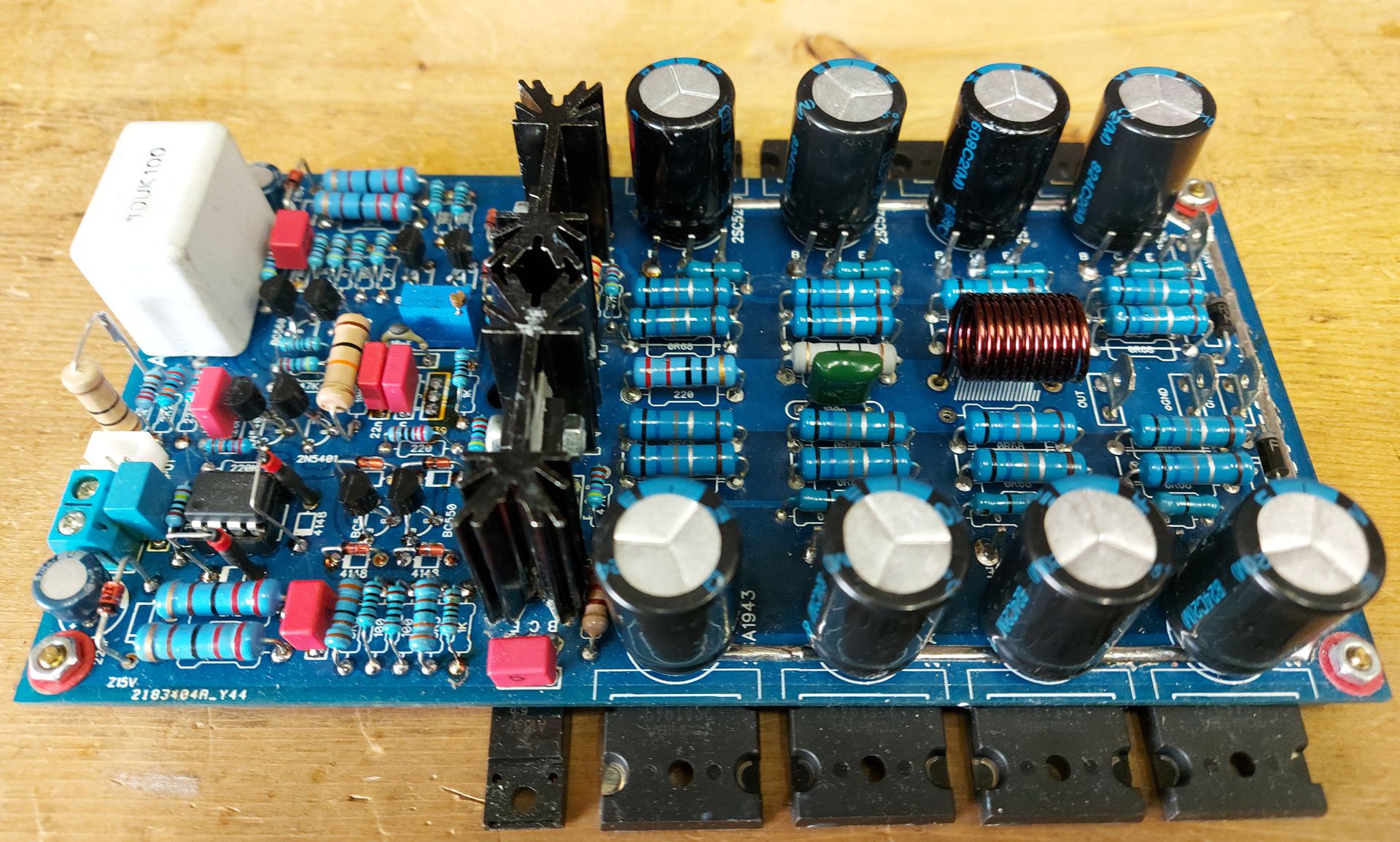

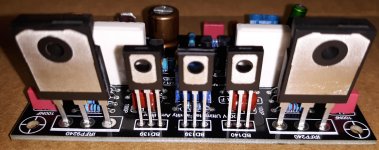

Hello, APEXAUDIO. Thanks for the good decision. SR200! True, the size of the standard fee was small for us. We have developed another version of the PCB. Your fee. They worked everything first on the simulator. Assembled and launched. For a year he has been working without complaints. Everything is great!
apexaudio SR200 users
SR200. There's a little nuance to this decision. Diodes D3 and D4 it is better to close in heat shrinkage from light ingress. Standing at the entrance LF411. Stability is increased. Otherwise, sometimes floats zero at the exit. And it's worth it iron. Checked on 8 collected different boards.

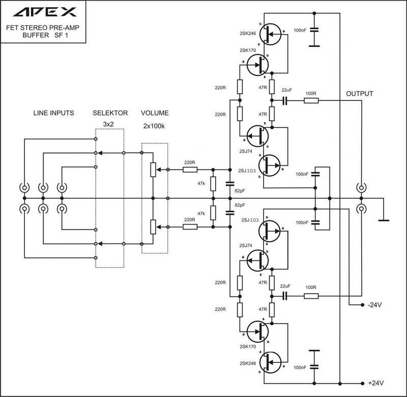

All fet buffer

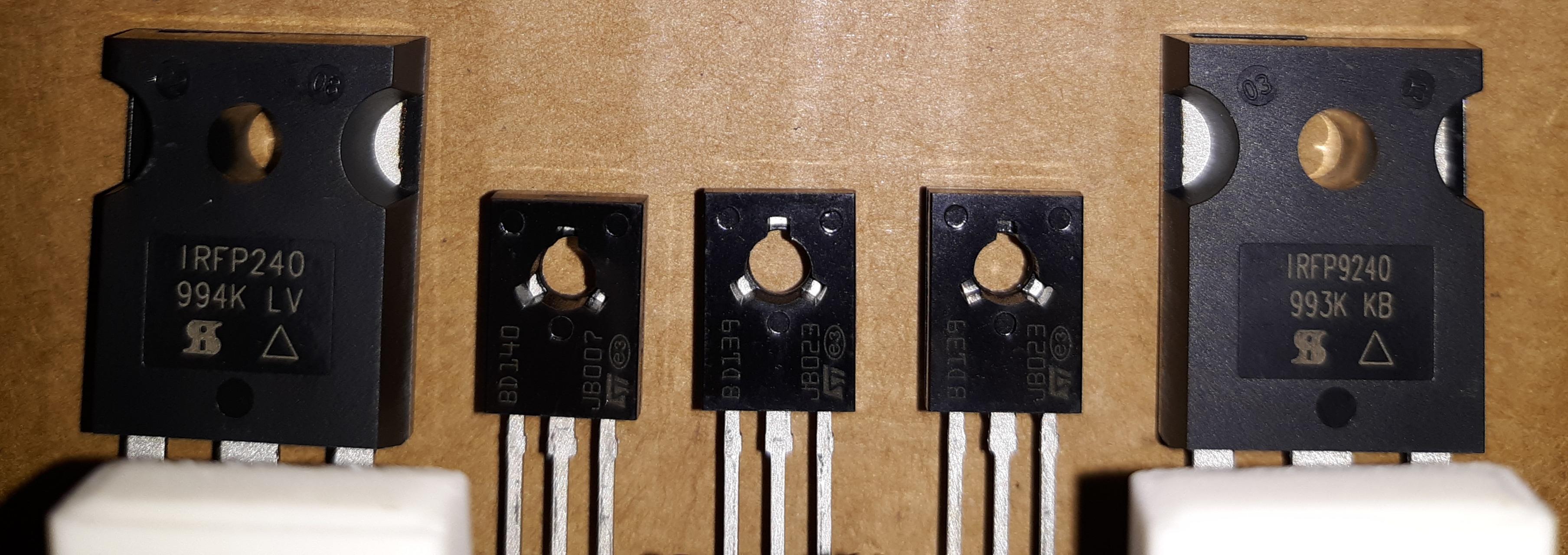

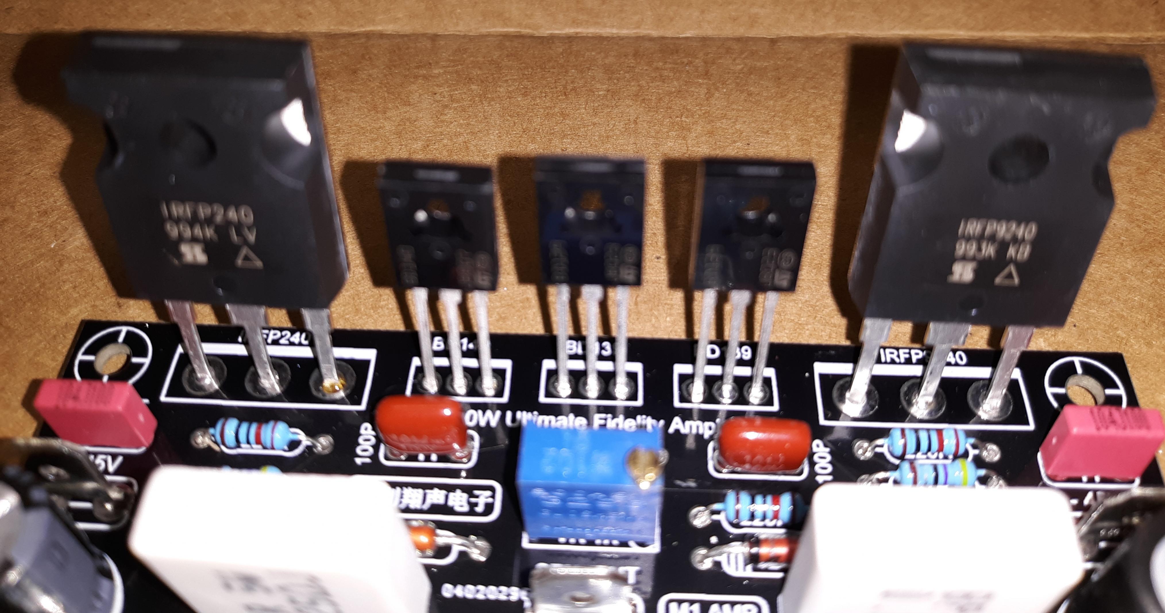

Before I turn on this (FH9 based board) can anyone post pictures (front and back) of genuine Siliconix/Vishay IRFP240, IRFP9240? (And ST BD139/BD140?) Or compare my photos with your known real devices from authorized distributors.
I have attached photos of what came with the boards. I am hoping to determine if they are "genuine"/safe before turning it on.
I was also planning to initially test at a low voltage. Would it be a good idea or bad idea to initially turn it on with +/-15V from LM317/LM337 board? I ask since I have run into too many "weak" (fake) power transistors.
If you think they are iffy I will take a slower route and get genuine outputs and drivers from Mouser or Digikey.

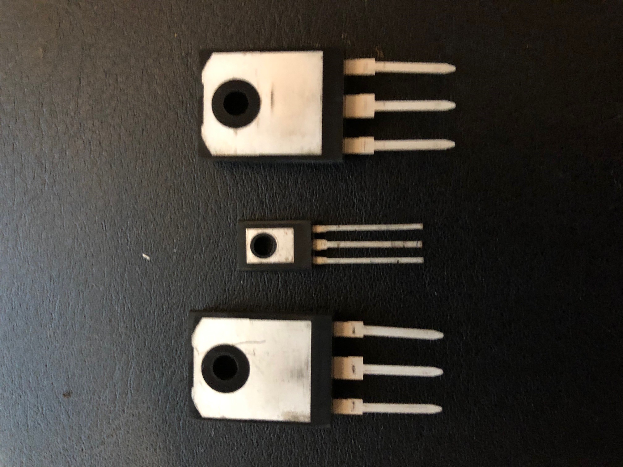

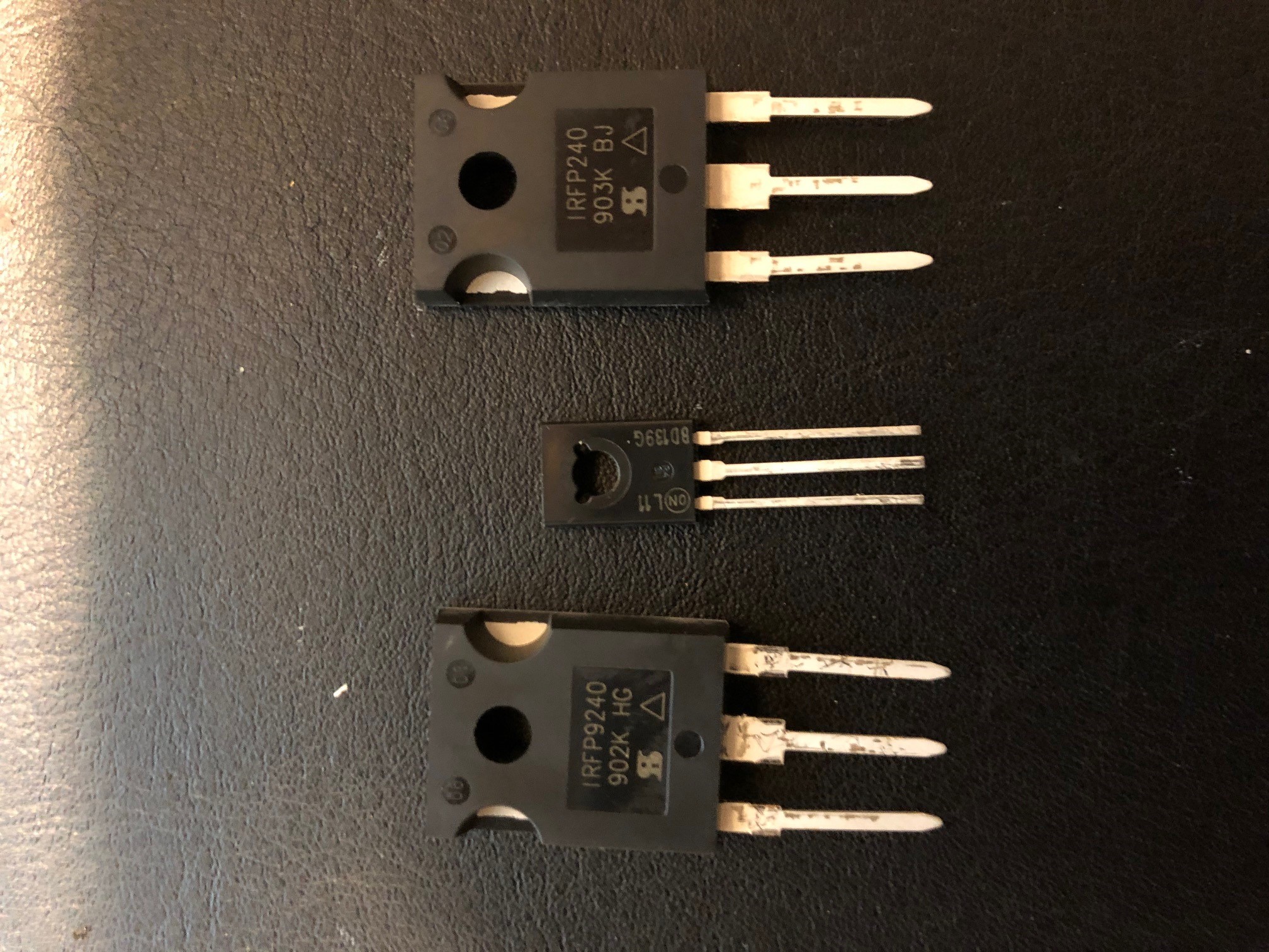

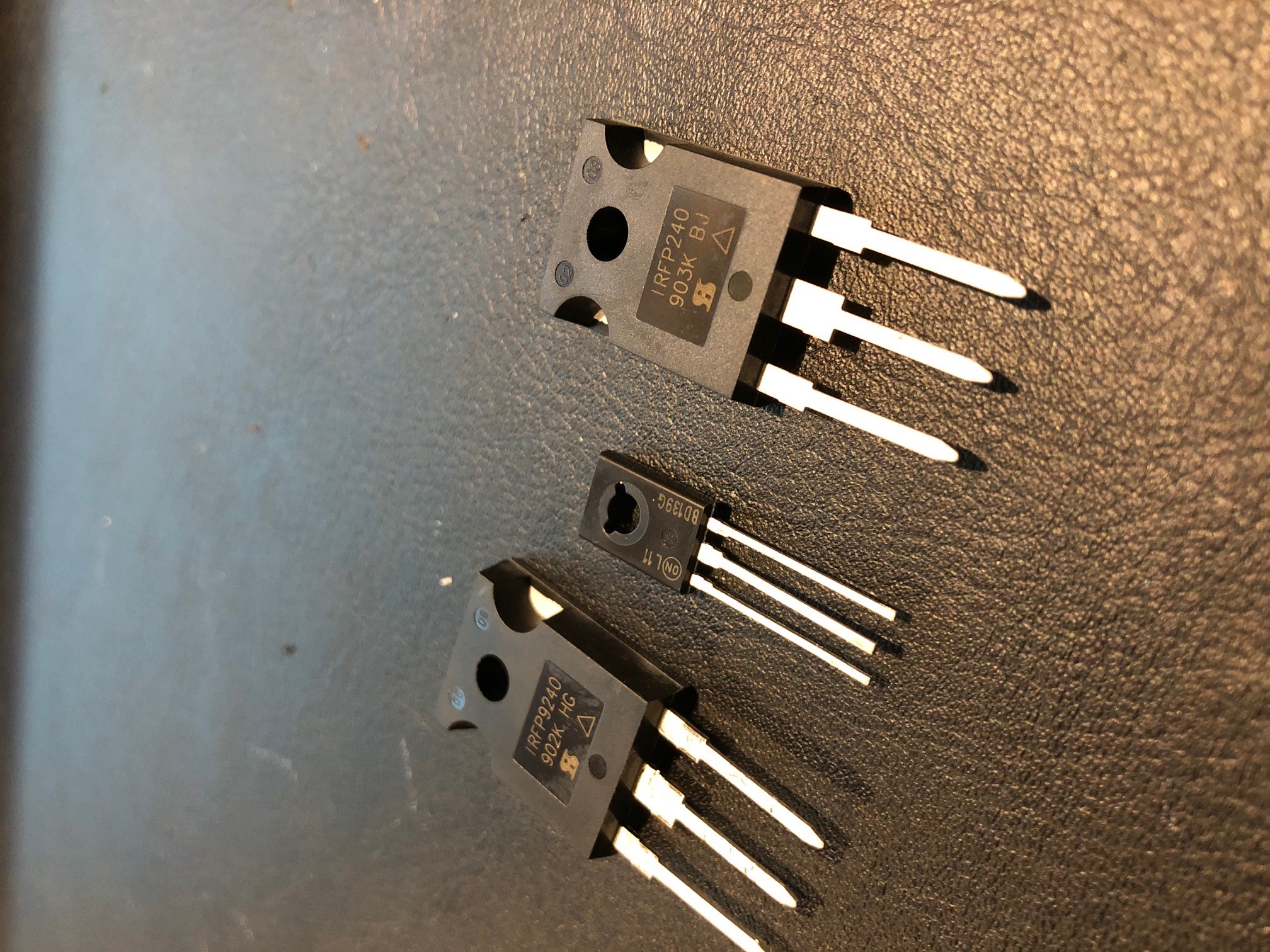

The Mosfets look real (match my Vishay's from Mouser) and I don't have ST BD139, mine are ON Semi from Mouser. Posted pics of the one's I had on hand.
Only the BD139/140 backs look different, the ON Semi's I have are square corners (I checked the 100 (4 different orders) I have and all the same square corners for BD139 and BD140)
I don't think BD139/140 are so expensive to need fakes, but use a DBT to bring it up and you should be able to tell very quickly if the bias or offset is unstable.
I have built 6 FH11 (same design with 2-pair of outputs) and the bias is rock-solid from start-up to hours of listening.
