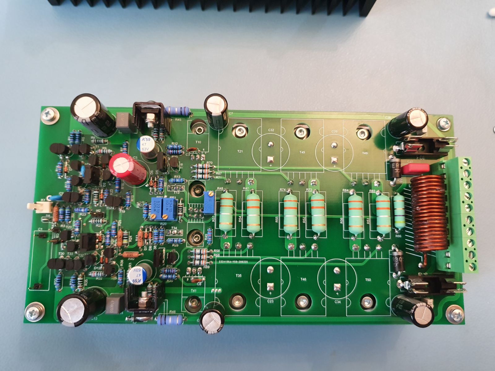

I have this sprint file.

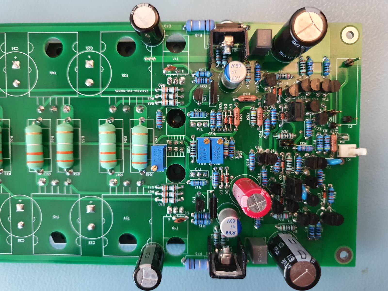

I received A40 boards from PCBway. Looks like an older version.
Is it the same circuit as the new version with a different layout?
Is there a BOM for this version?
Thanks in advance!
Add: Pic of board. The components are numbered but no values.

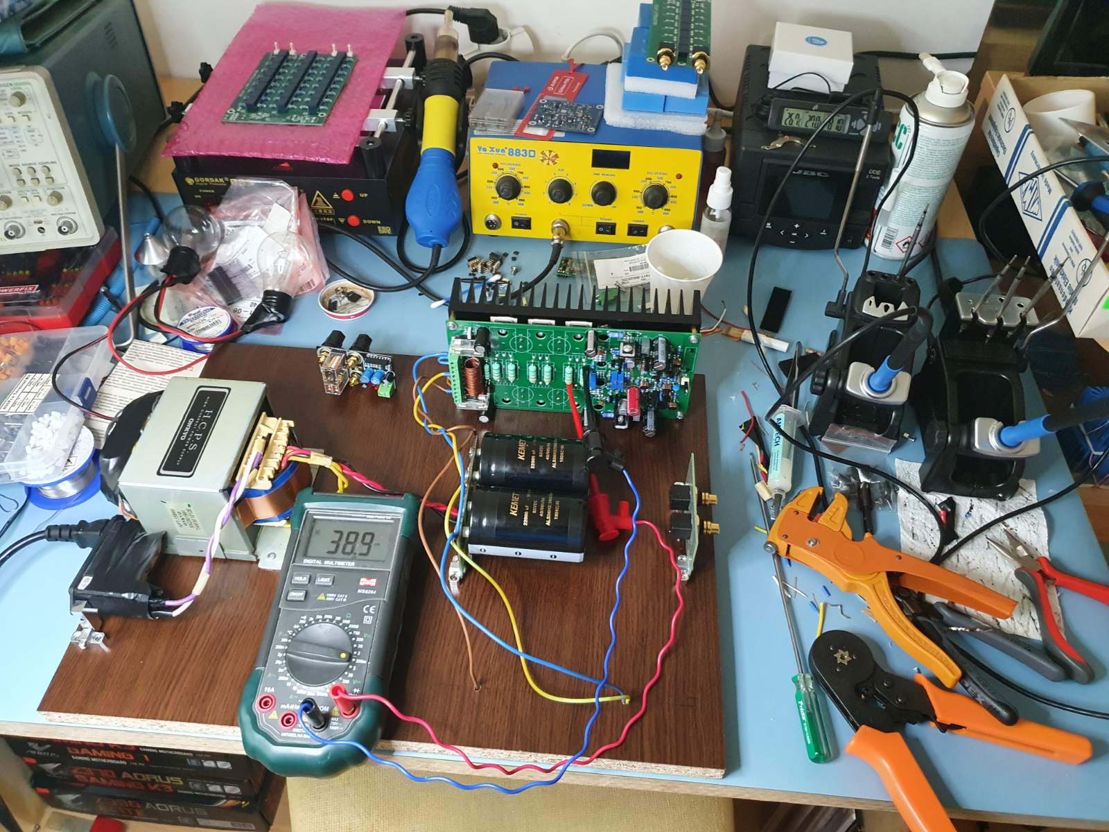

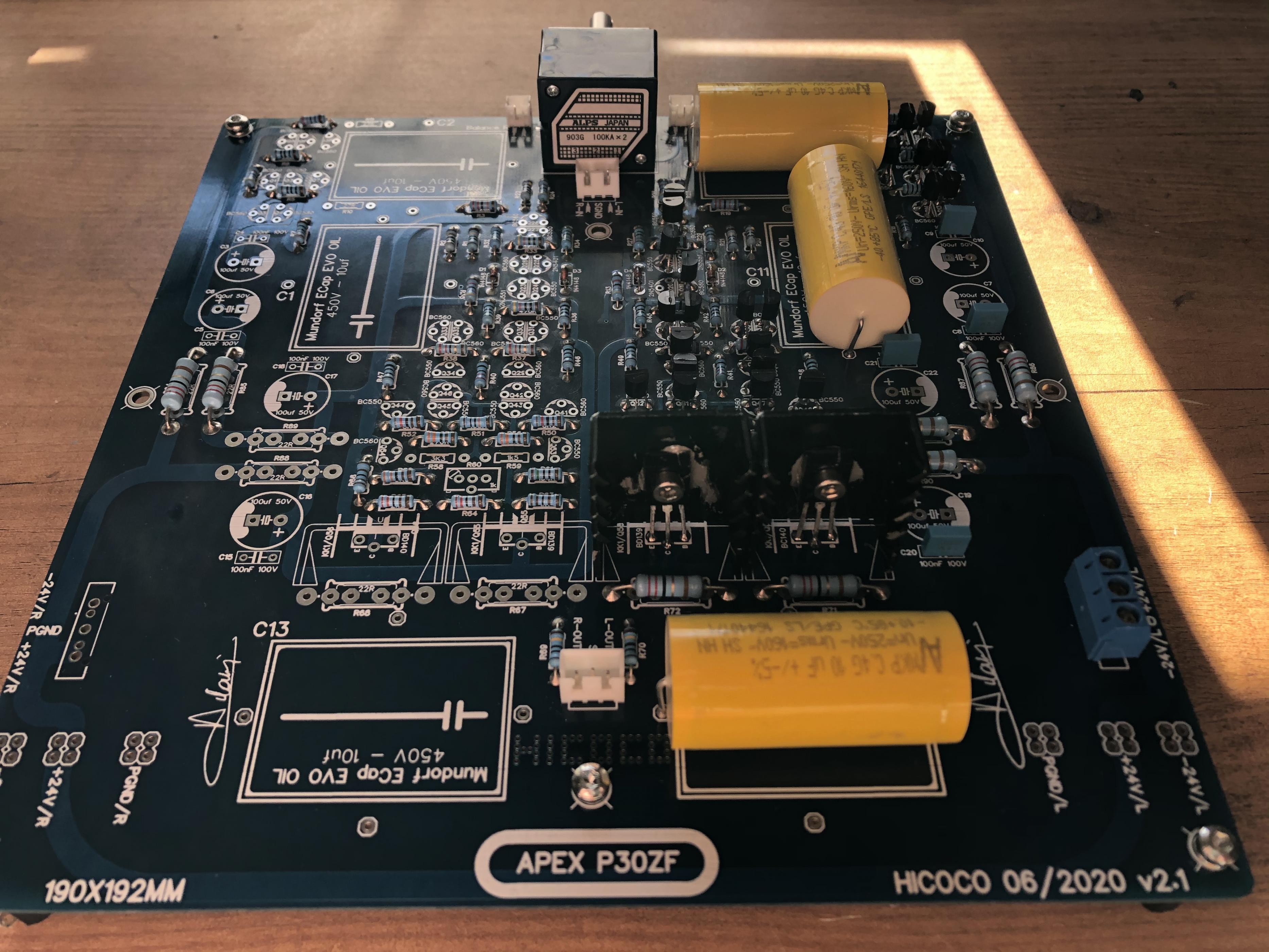

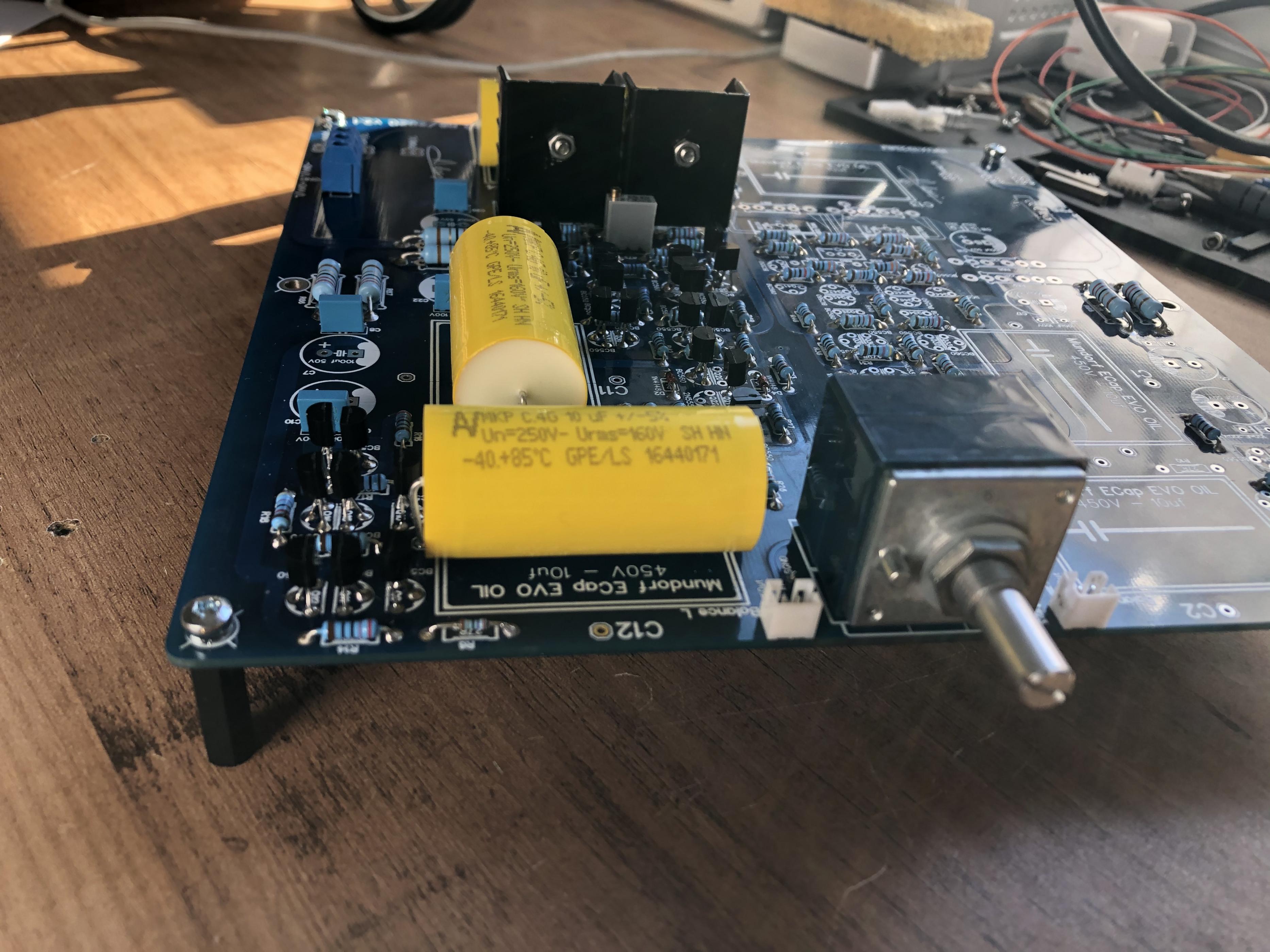

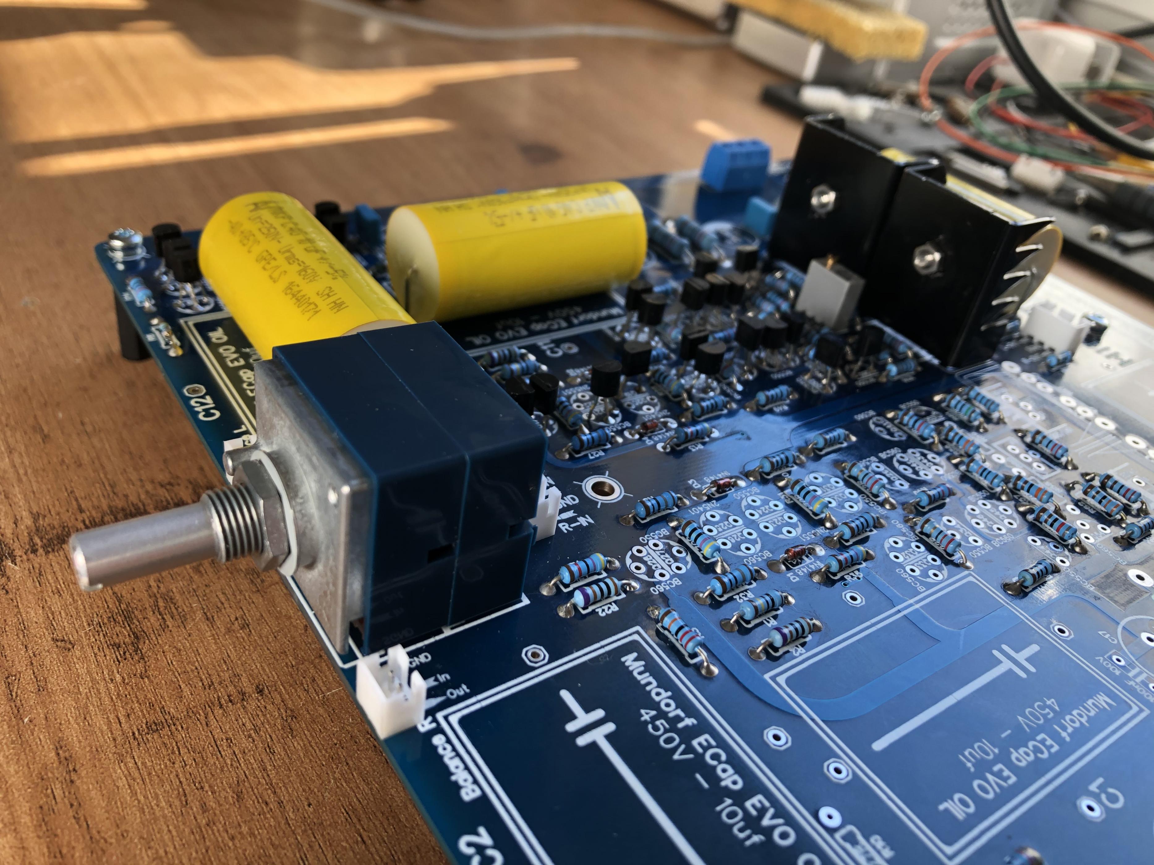

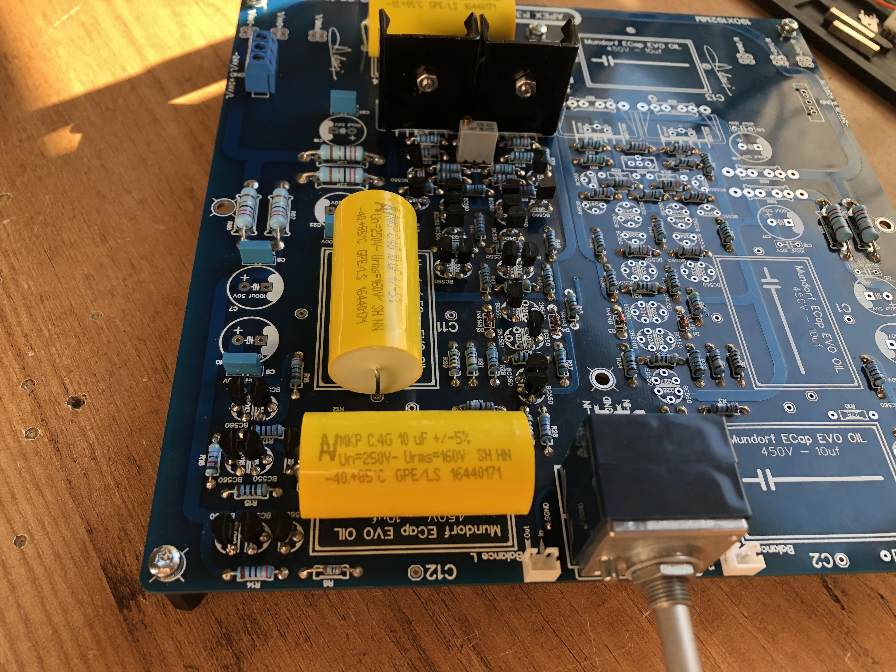

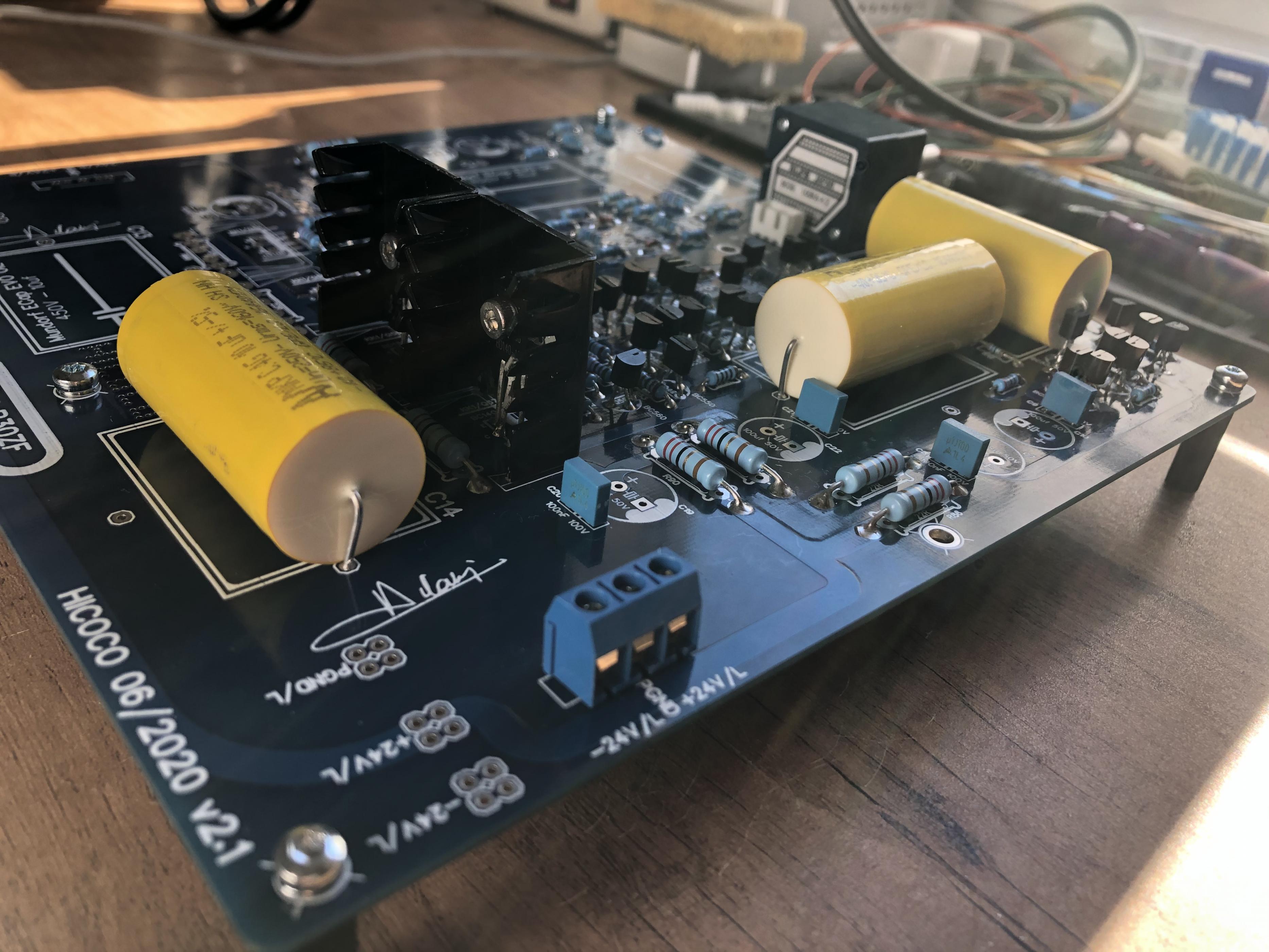

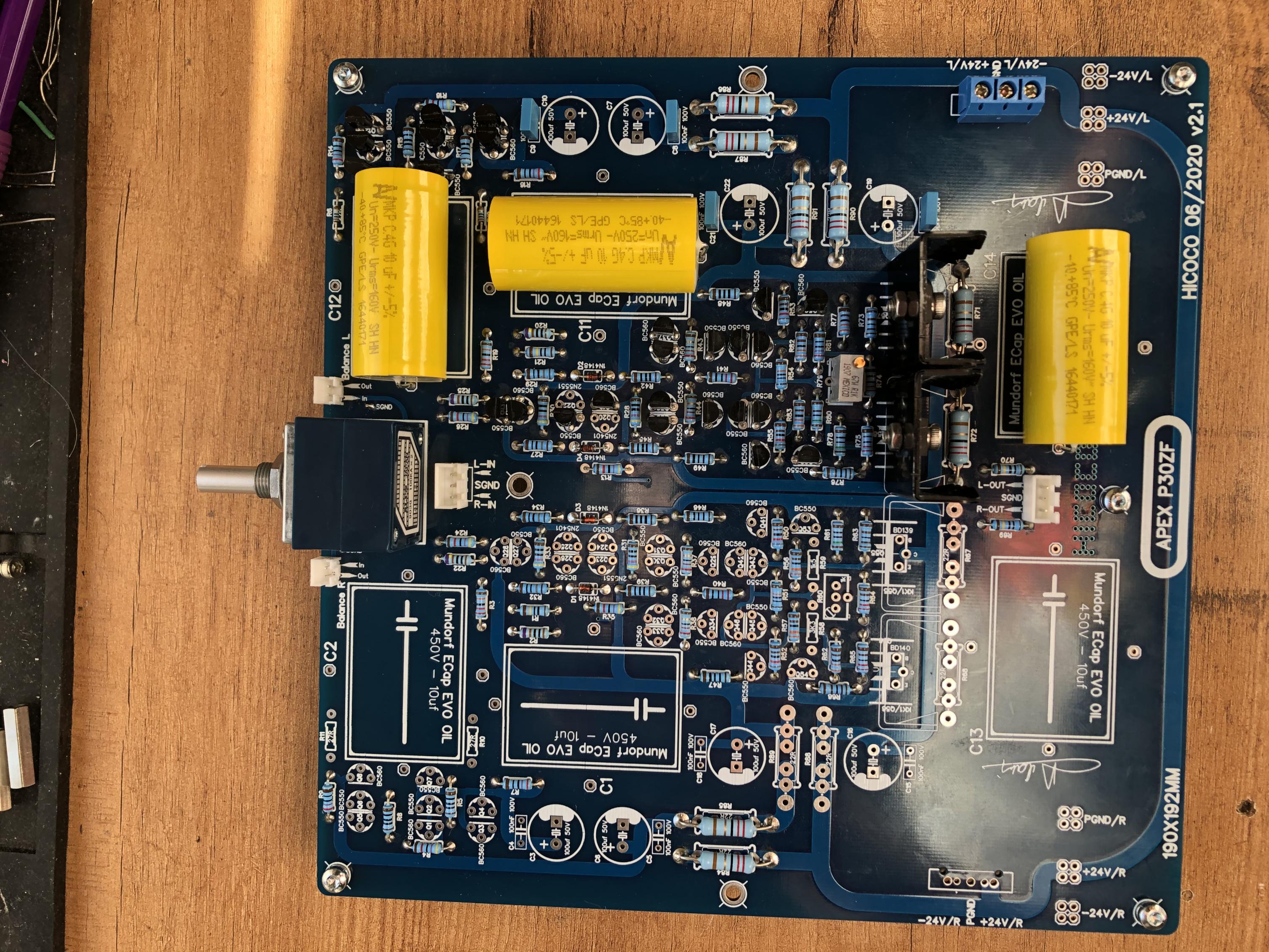

P30ZF allmost ready.
The left side is allmost stuffed and soldered, waiting on the last parts 2n5401 and 100uf, should arrived this week.
I will powering up soon.

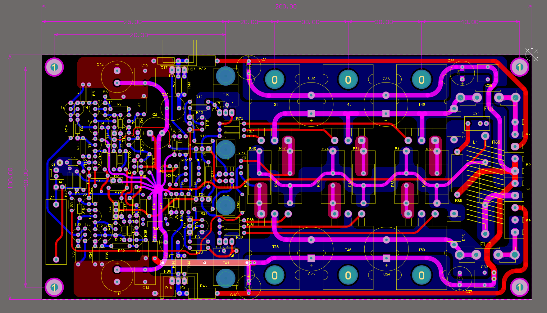

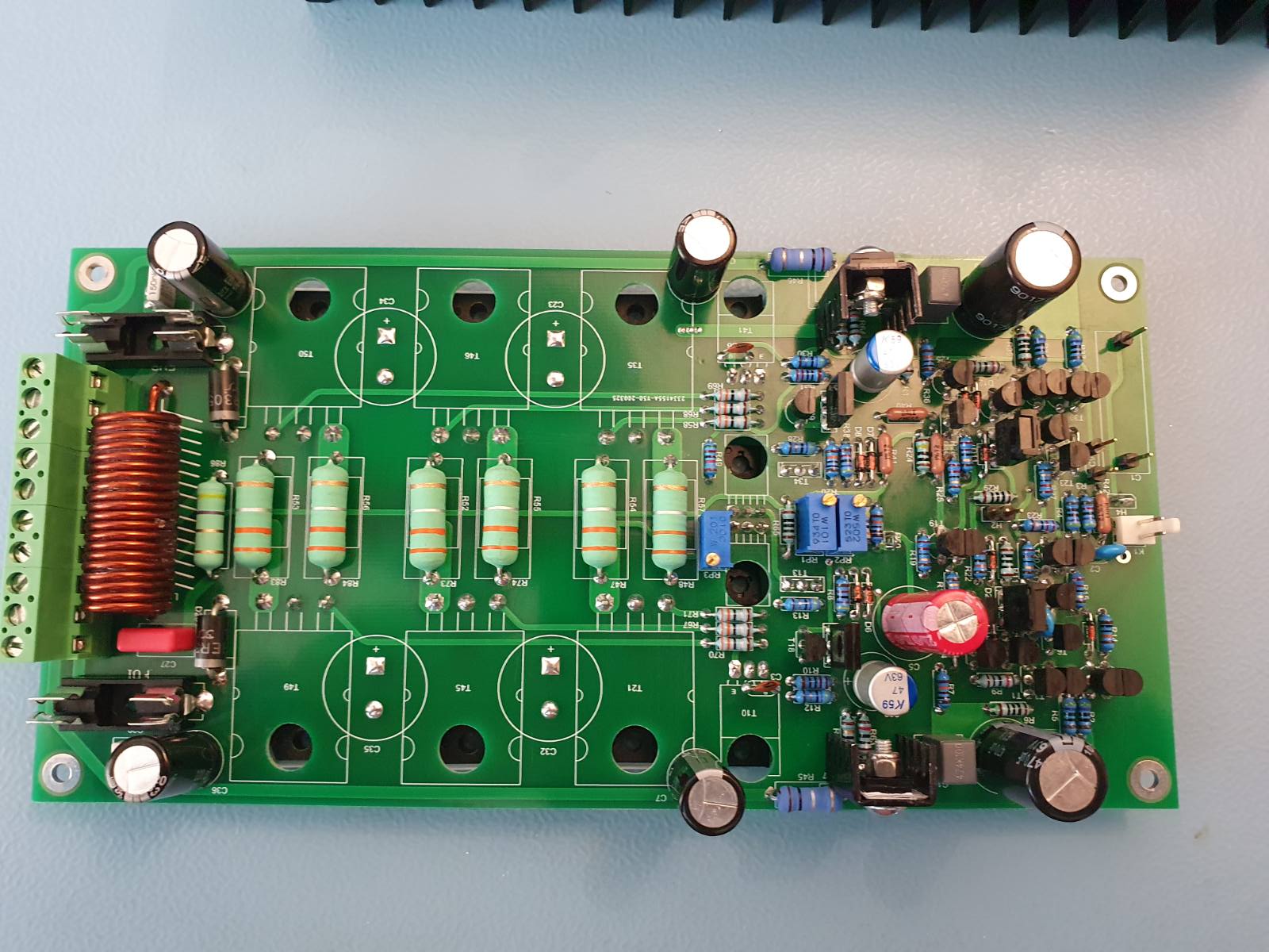

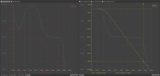

Hi. It's modificated version by my friend. This board has no ground loops and shows better values on spectogram. If I find the schematic will post it.

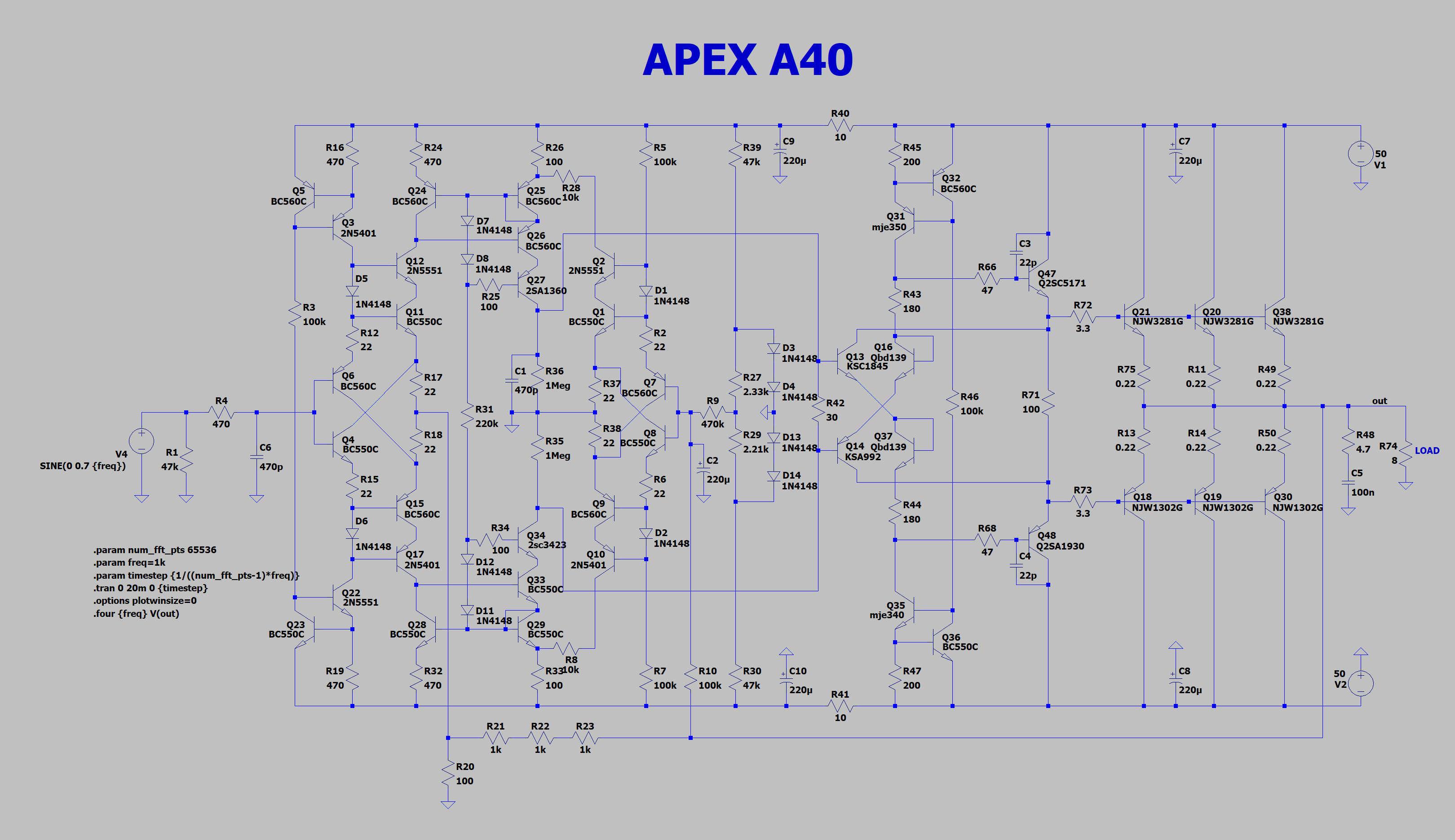

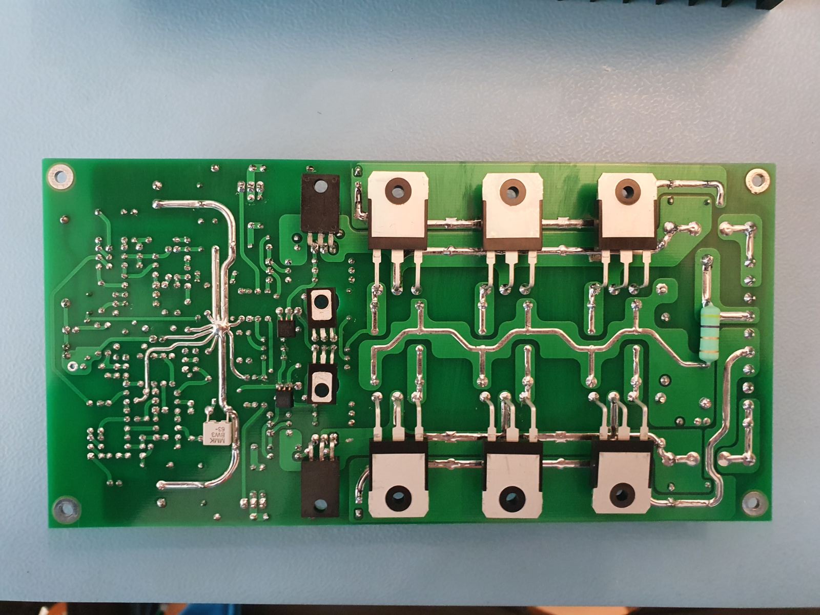

Hi, I attach the schematic here.
C9, R49 are optional. Use them only if you have spectrum analizer to set them.
For R50 use wire bridge.

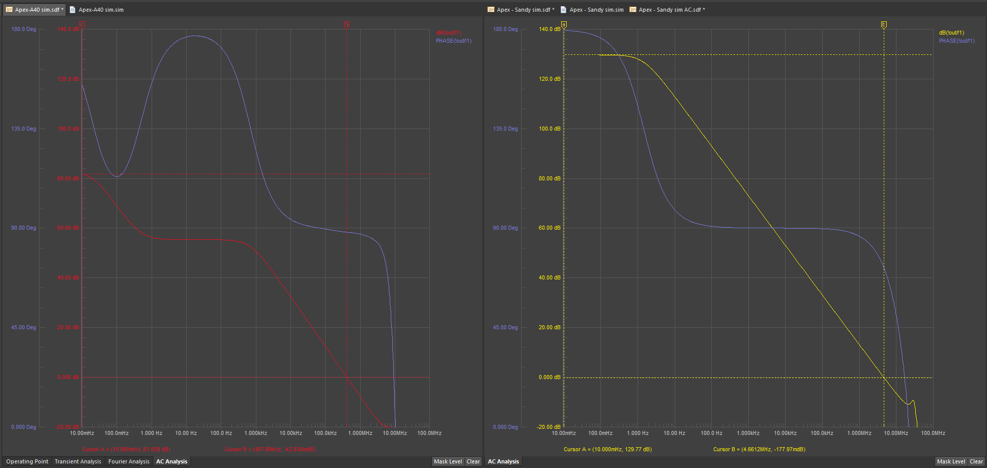

I strongly recommended to use KSA1381/KSC3423 in VAS instead of NJE350/350 for better OLG and 10db better THD.

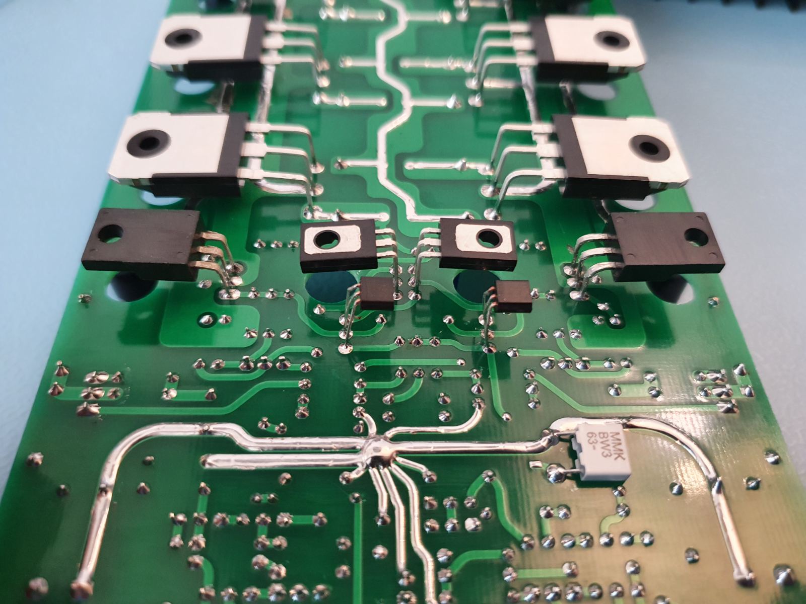

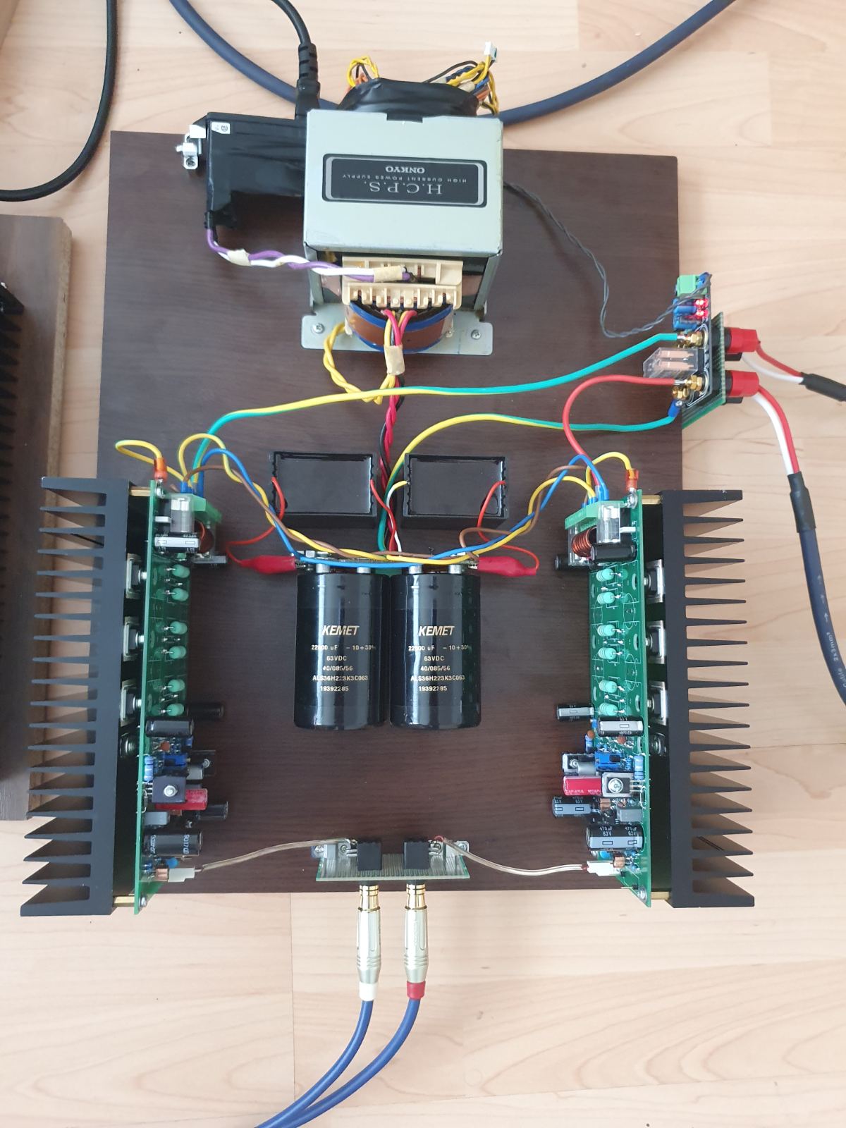

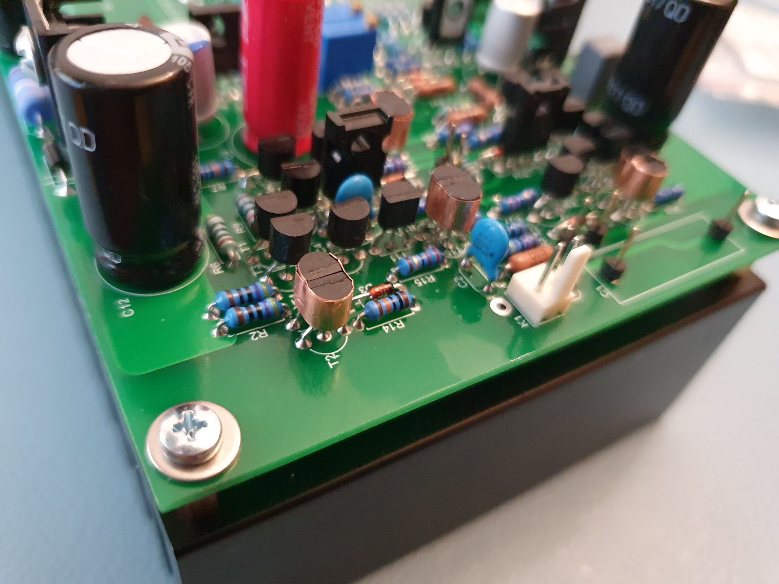

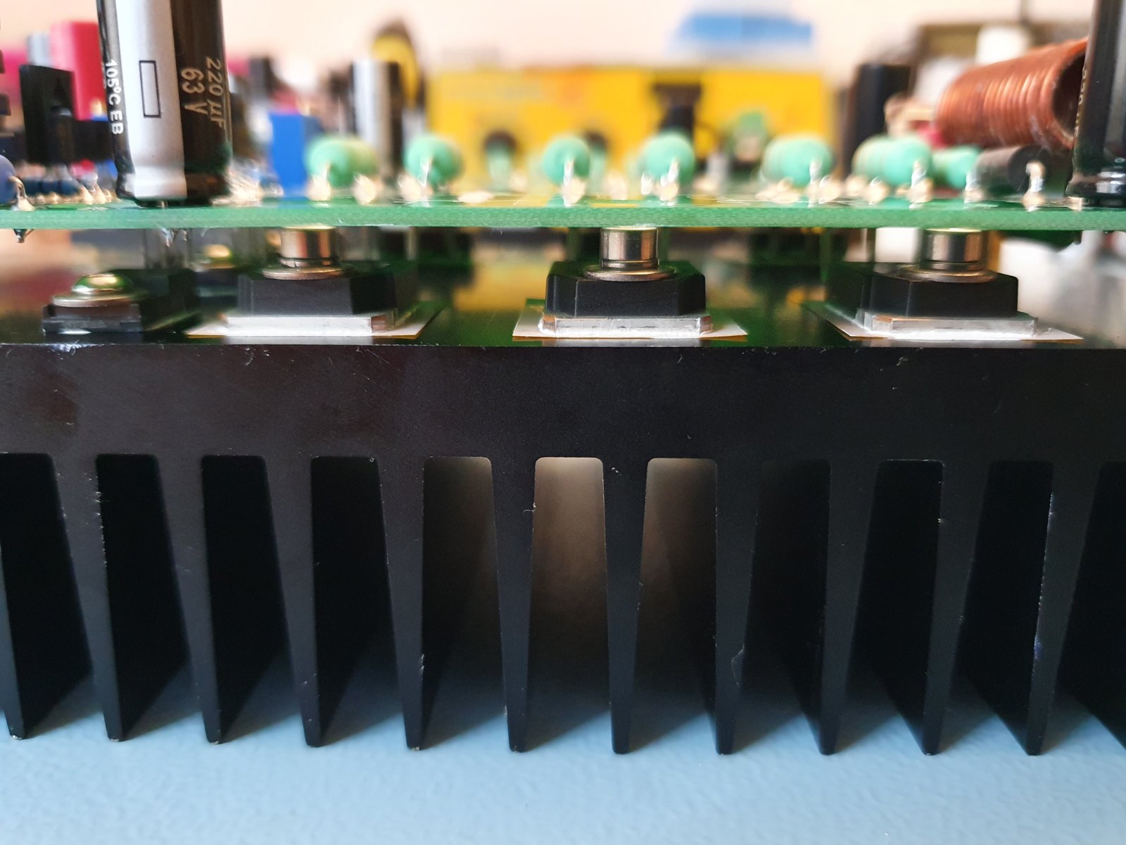

And some pictures:
Looks very nice, can you share files/gerbers with us ?The left side is allmost stuffed and soldered, waiting on the last parts 2n5401 and 100uf, should arrived this week.
Other pics of the Amp.
Yes i will !!Looks very nice, can you share files/gerbers with us ?

Did you solder on top of the solder mask or was there a way to avoid to have the mask on specific traces?
In the second case where did you order your board from?
https://www.diyaudio.com/forums/att...amplifier-viber_image_2020-06-05_20-22-09-jpg
@ r_jik45
I ordered the PCBs in JLCPCB.
I open the solder mask on the high current planes and tracks, and also for the star ground connections. After that i add tin in the open places.
To add solder mask opens there is two ways in altium. The first one is manual draw (place line) in topSolder or bottomSolder layer and draw on the tracks. The second way is to sellect track and from propperties add manual Paste Mask Expansion width.
