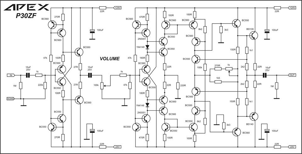

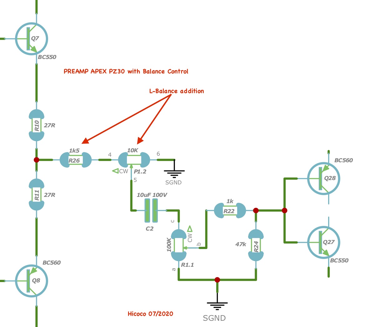

I have add a balance control to the P30ZF, Is this schematic modification is correct ?P30ZF

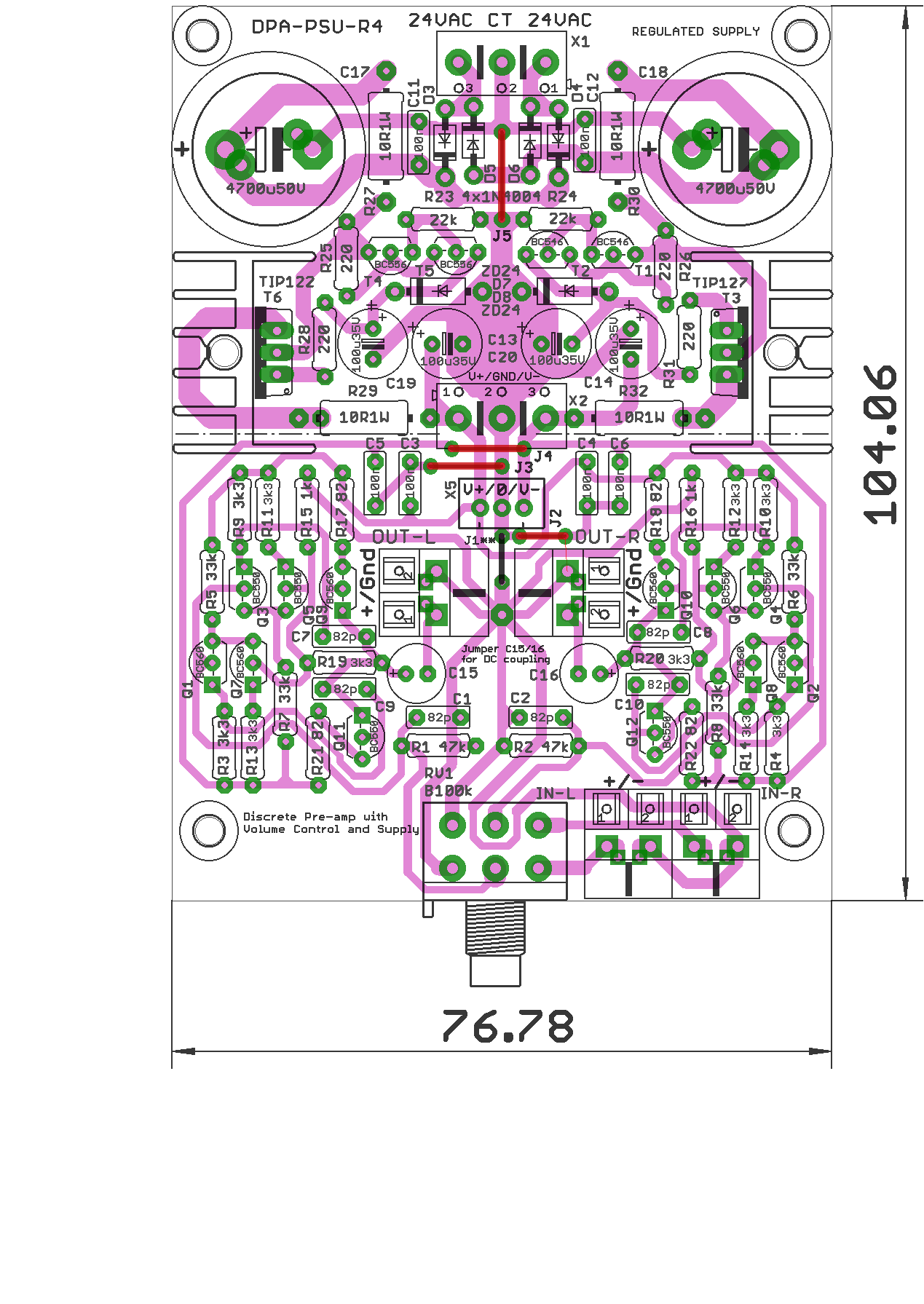

I checked and I actually used a modified version of the above layout. I really just simplified a little as Alex had designed it with two different sets of holes for the resistors and caps. I removed the extra holes to make it easier to etch and drill. I am adding those file here.
These are also for toner transfer. I you need photo sense files let me know.
