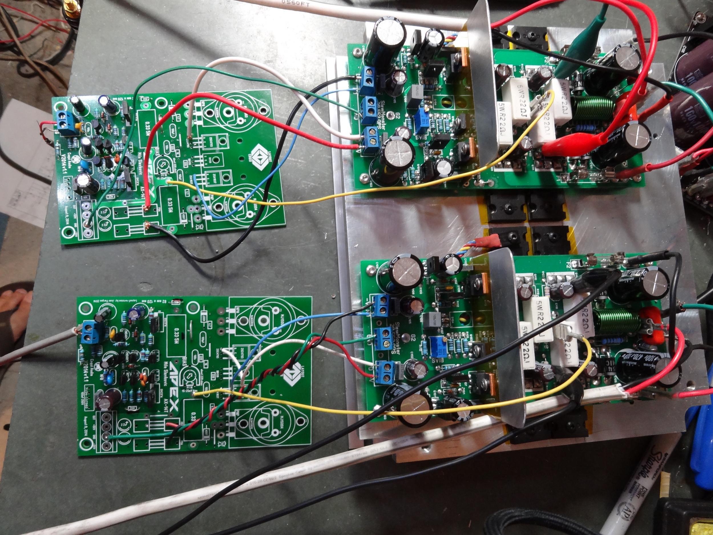

I understand where you are coming from. When I first started building DIY amps I bought a big transformer that was too big for the amp I wanted to build. That caused me to build a Leach Superamp so I could us it.
As and example, the Honey Badger recommends +-60V and it has three pair of outputs. I would suggest if you want to use that PSU that you already have that you use at least 3 pairs of outputs. The AX14 will easily handle that. I built an AX14 as an IPS and put it in front of a Slewmaster OPS and it was stellar.

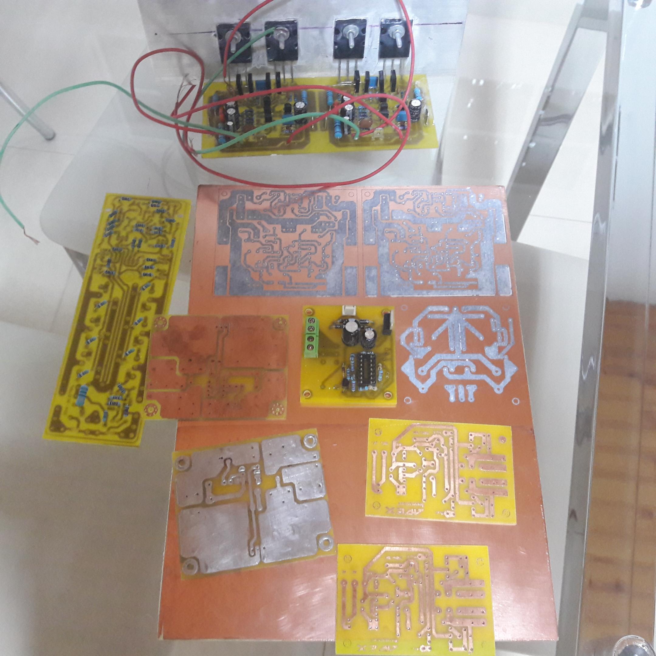

I know I ask a lot of questions to the forum and I never posted any pictures of my DIY, just out of curiosity to hear the sound, I'm assembling apex AX 11 and AX11 layout by Bimo / Prasi, the AX 20 because in the multisim simulation the AX20 was perfect, I'm riding SR150 too, I will still record SR200 and SR250. All this to put an end to the curiosity of what the sound is like. Together in the apex photo ON / OFF, soft start, PSU preamp ZY18 and PRO stereo.
I thank Mile and colleagues on the forum for the layouts.

hi clpk ,what method do you use for tinning your pcb?

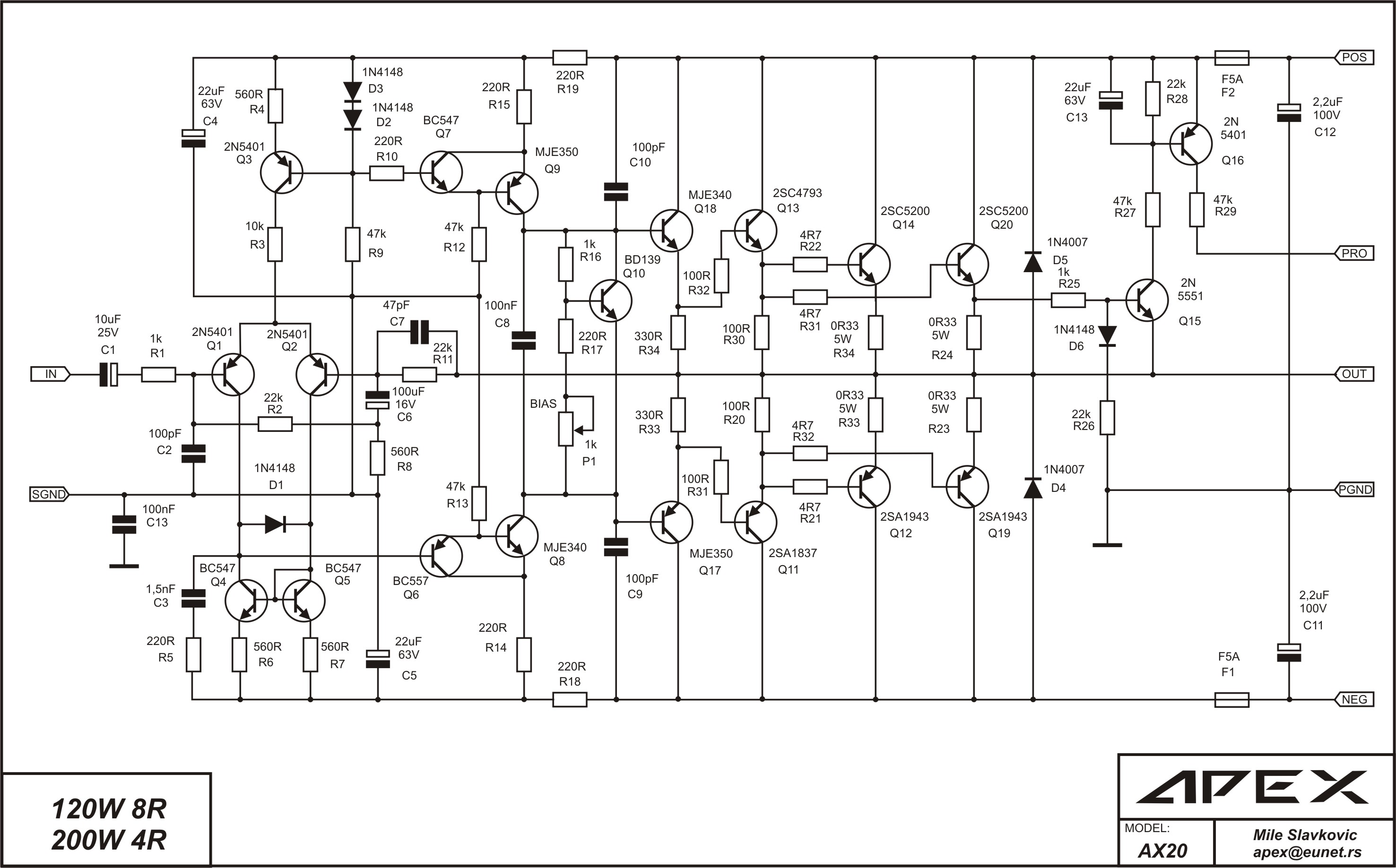

I spread a thin layer of soldering resin on the PCB so that the tin can spread on the copper and then melt the tin with the soldering iron and spread on the copper with the soldering iron. Take care not to overheat the copper, it can detach the copper from the plate.
Greetings
greetings too and thanks for the quick reply , the method takes a lot of time , i wish there was an easy quick diy method , maybe applying varnish will help the copper not to corrode:confused:
