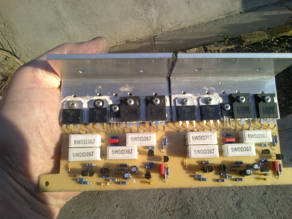

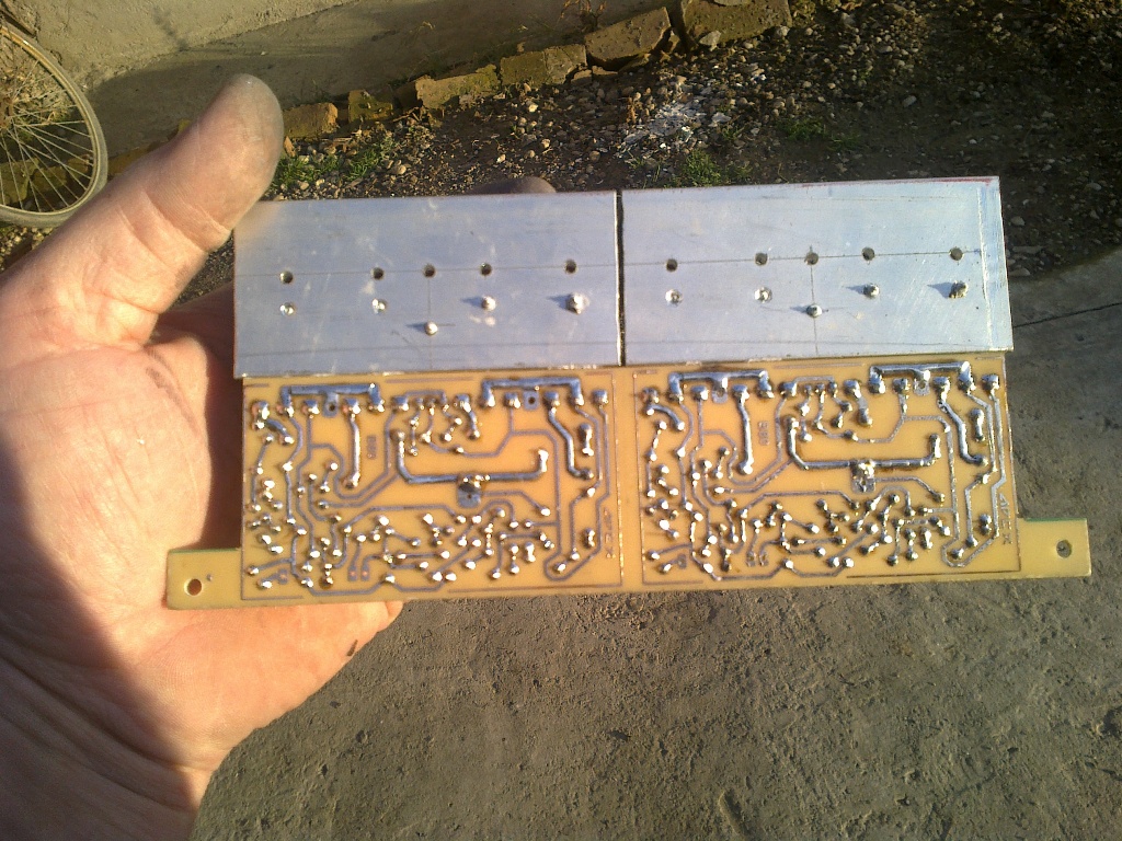

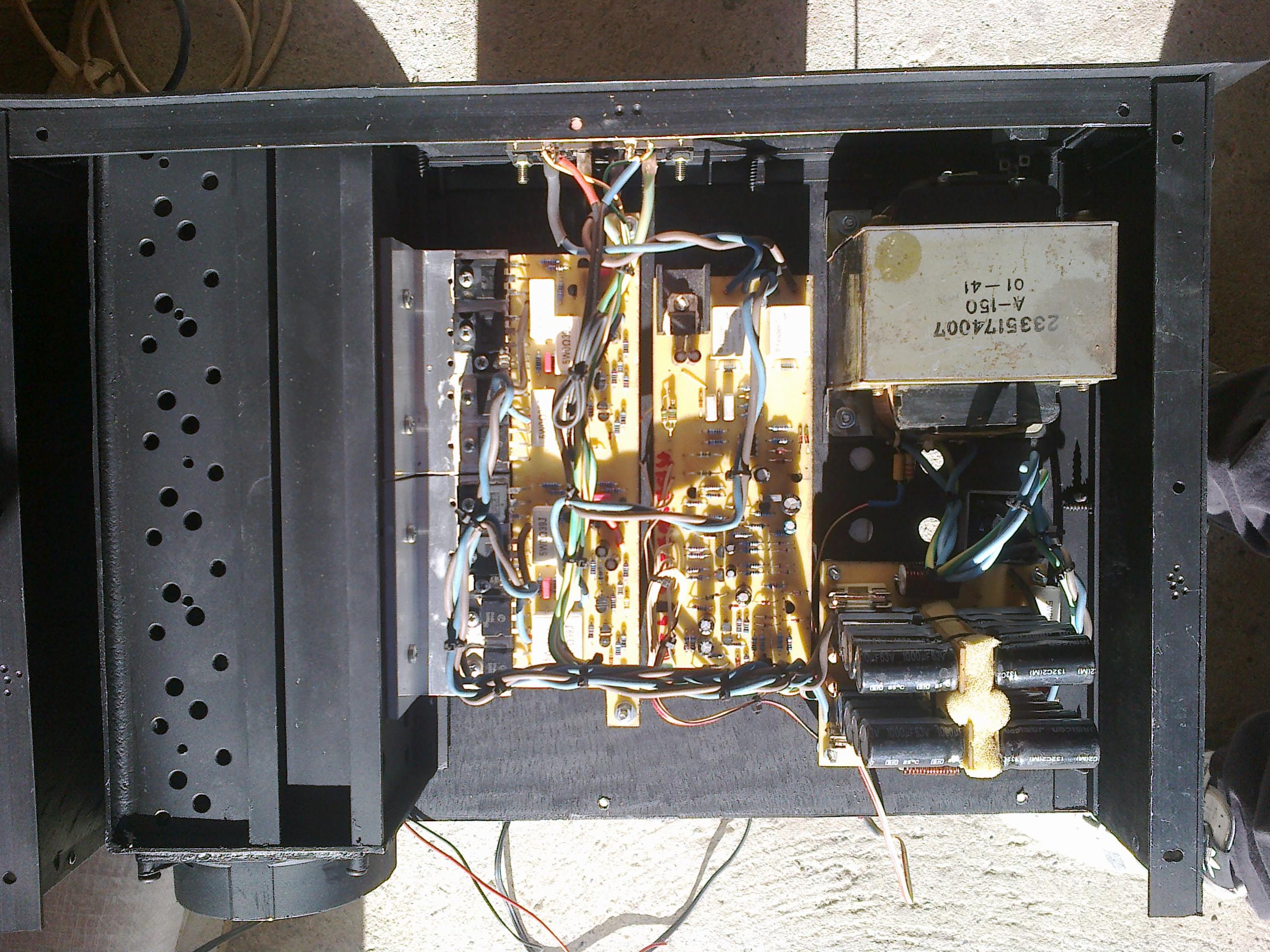

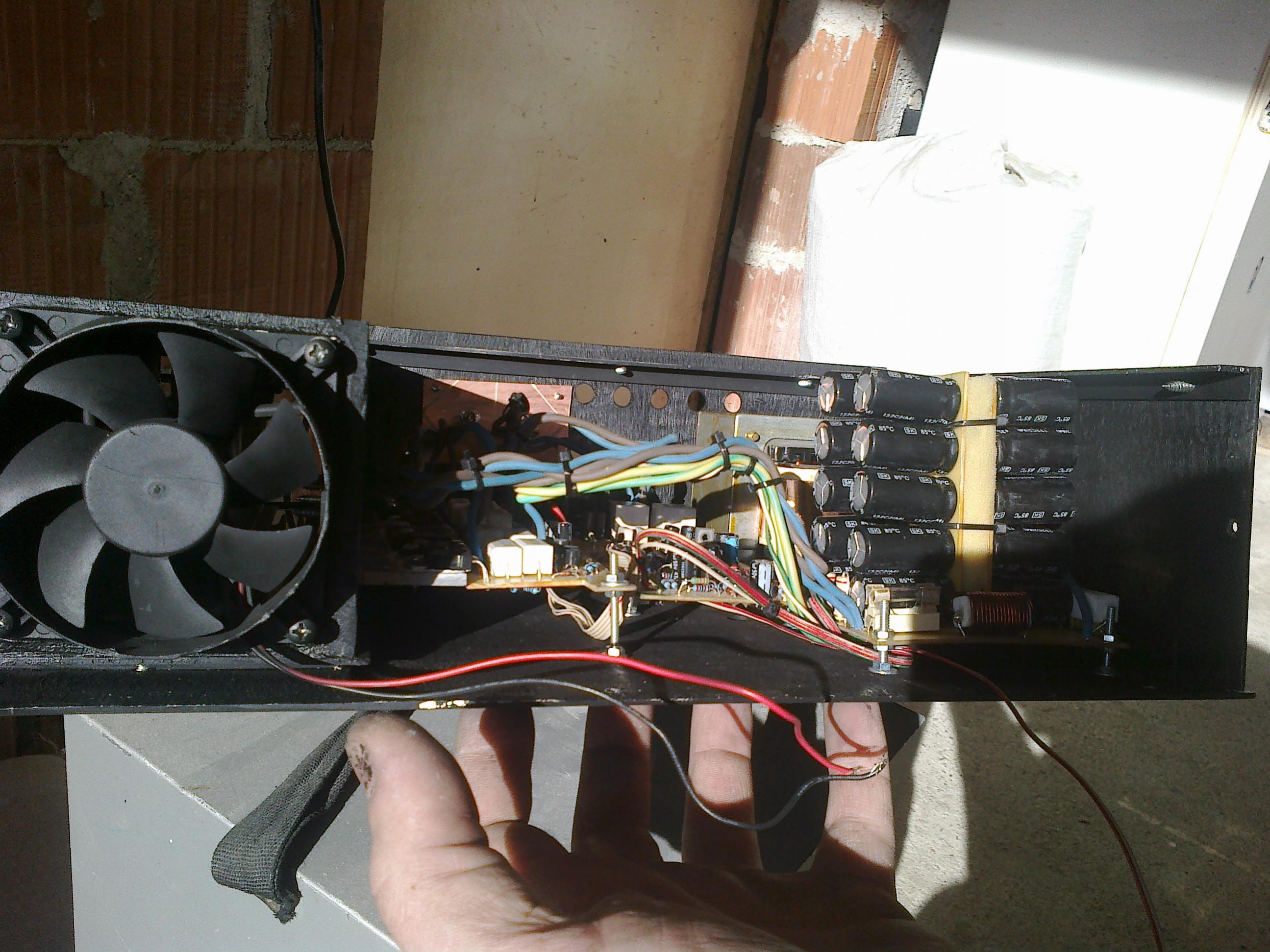

One more thing-i was listening this amplifier yesterday whole day,and in a few moments in a few songs i was pleasantly surprised how deep can it go! One thing is for sure-this amplifier that i have built deserves a proper transformer and more than 10 000uF per rail in PSU,to get it´s maximum performance although it sound good as it is. Cheap and very very good amplifier-I RECOMMEND IT!
(copy-paste from "150W MOSFET Amplifier with IRFP250x2" page 13,posts #121,#122,#123,#125,#126,#127,suggested by APEX)

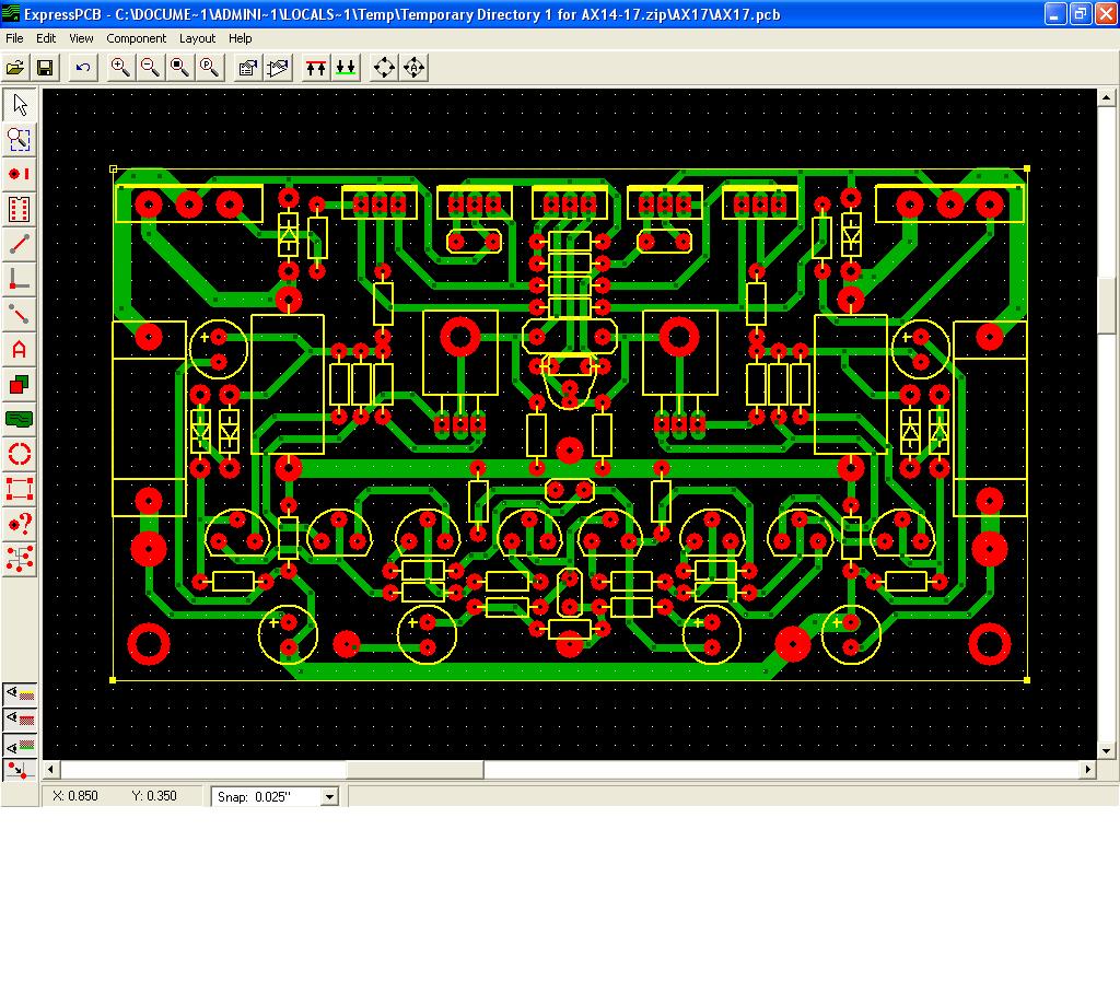

In schematics AX17 ...
Why use such a powerful transistor for Q9/Q10 like MJE340 ?
Collector current of Q9 is about 4mA and the dissipation is ~ 0,3W.
Can I use 2SC2705 (150V, 50mA, 800mW) instead ? Is special for audio VAS stages.
Many transistors can be use for VAS, MJE340/350 is just easy available parts.

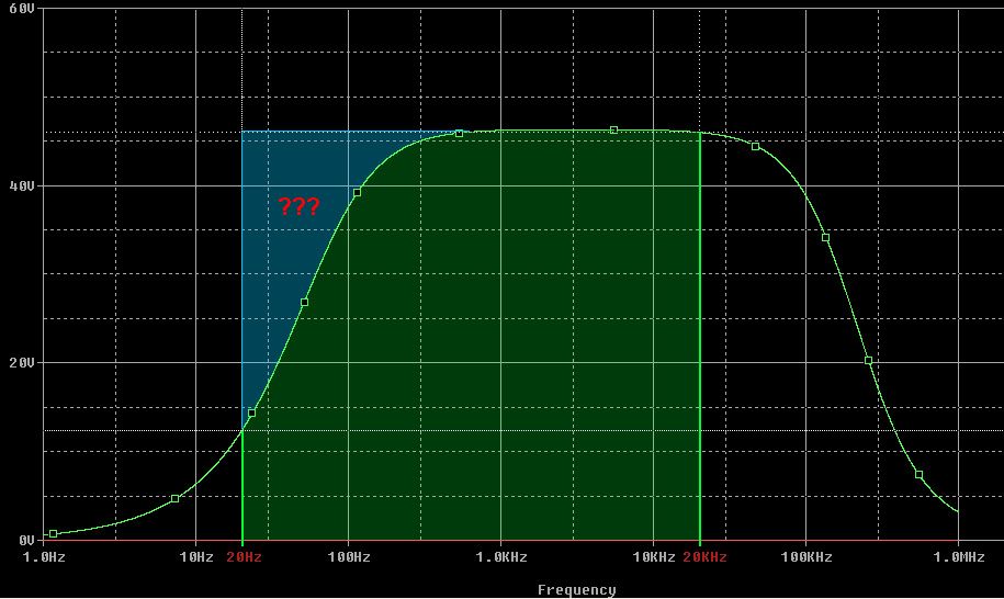

I simulated the AX17 schematics in Orcad Pspice and the bandwidth looks like this.
What's wrong ? Has someone real measurements on this ?
Replace C6 100uF with 1000uf
