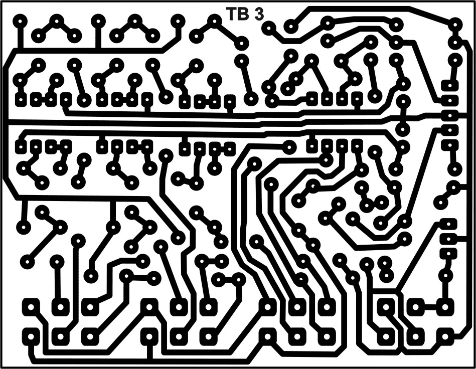

Hello sir
I have completed fh9 amplifier but i am confused how to set bias and how much.my power supply is 30..0..30 volts ac trafo.@ 3A thank you yours masood
set the multi meter on milivolt dc, connect the meter probes to emmiter resistor and turn the bias pot until you get the 15mv reading, now connect the probes to other and measure the reading it should be approximately same.
Thanks rehman
Which prod of meter put at emitter resister and other prod where will put .please mention where positive prod and negative prod.thanks
