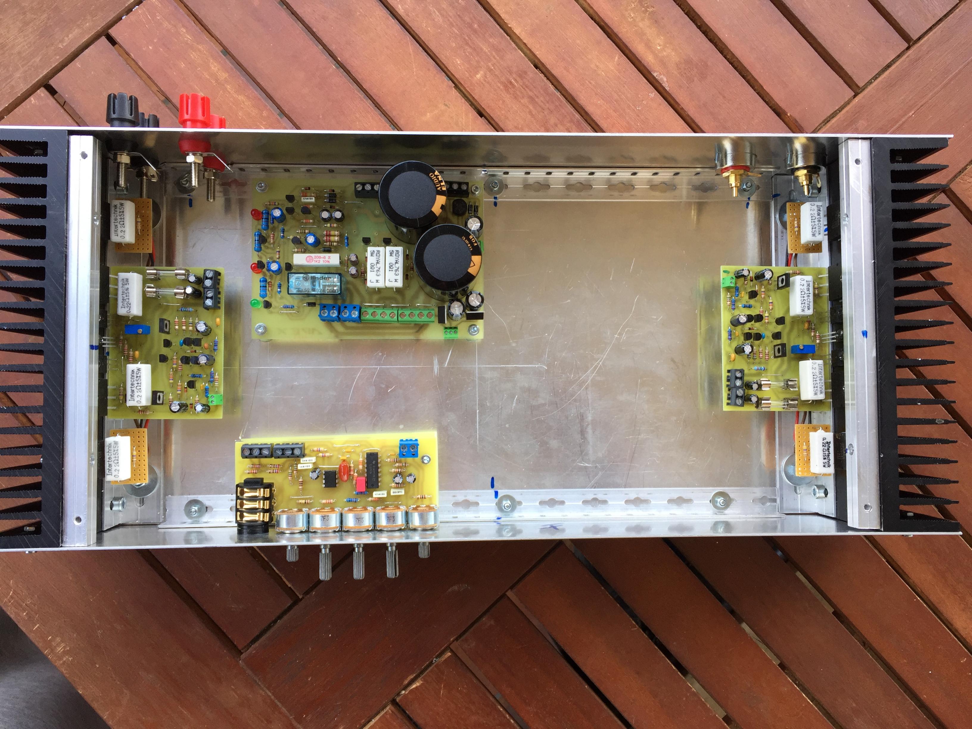

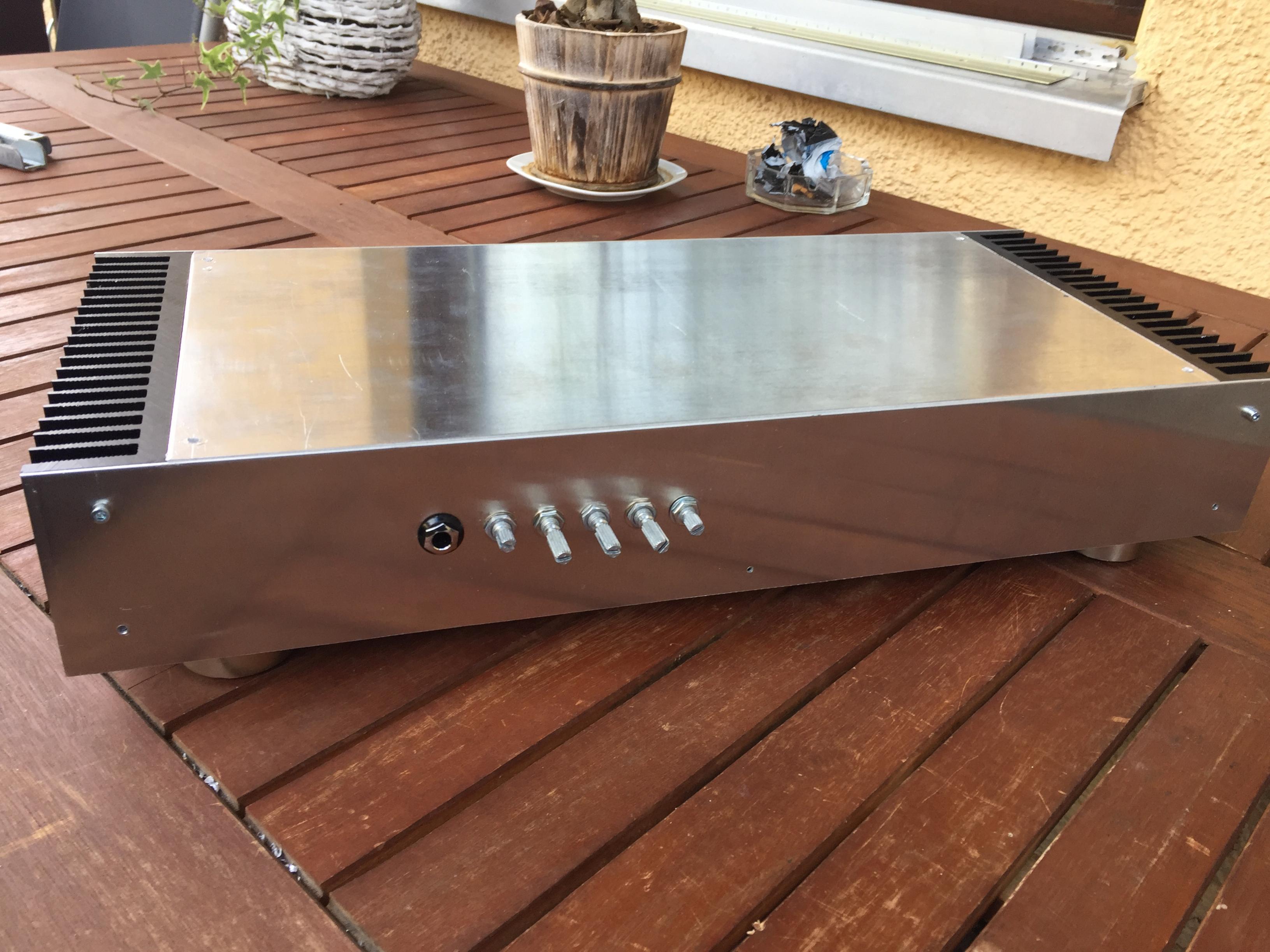

Nice!my work
I'm waiting for the trafo
What is the heatshinks and where you get these?
Conrad Electronic Shop >> Elektronik online kaufenNice!
Thanks but what is the type?

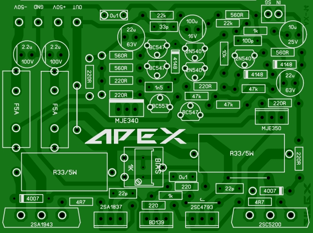

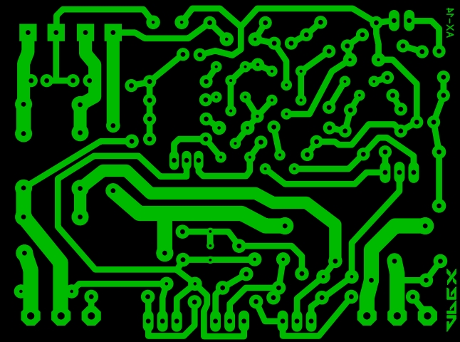

Query about PCB layout of AX-14
Hello DIYers
This sprint layout file is from dear sir vargasmongo3435 here is a link
100W Ultimate Fidelity Amplifier
Can anybody build AX-14 Amp with following PCB layout?
Is everything is ok on this layout, I think 2SC4793 Emitter Track is to close to 2sc5200 Emitter terminal.I am going to make two chanal(Stereo) on 35-0-35VAC/400VA transformer, for getting 100Watt on 8Ohm load.if PCB IS Fine please help if somebody build AX-14 with this layout.
Best regards
Profilkühlkörper 1.06 K/W (L x B x H) 75 x 200 x 40 mm Pada Engineering 8071/75/N
Ok thanks!

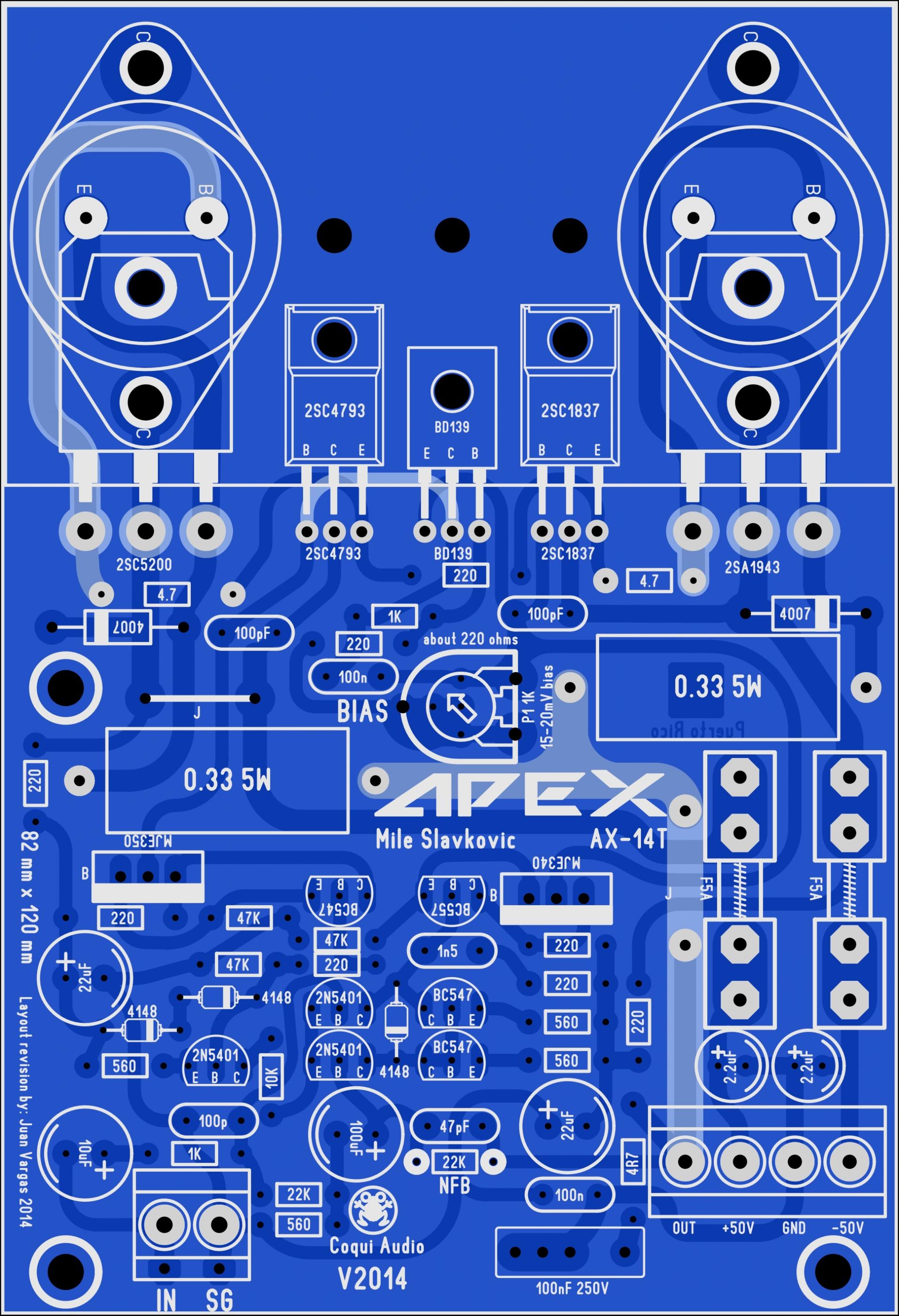

Hello sir vargasmongo3435
Thanks for replay
I found your sprint layout file for AX-14 with original 2sc5200/2sa1943 on( page no 143 and post #1421) can that PCB is ok. I want your thought on that PCB layout you make from apex layout.
best regards

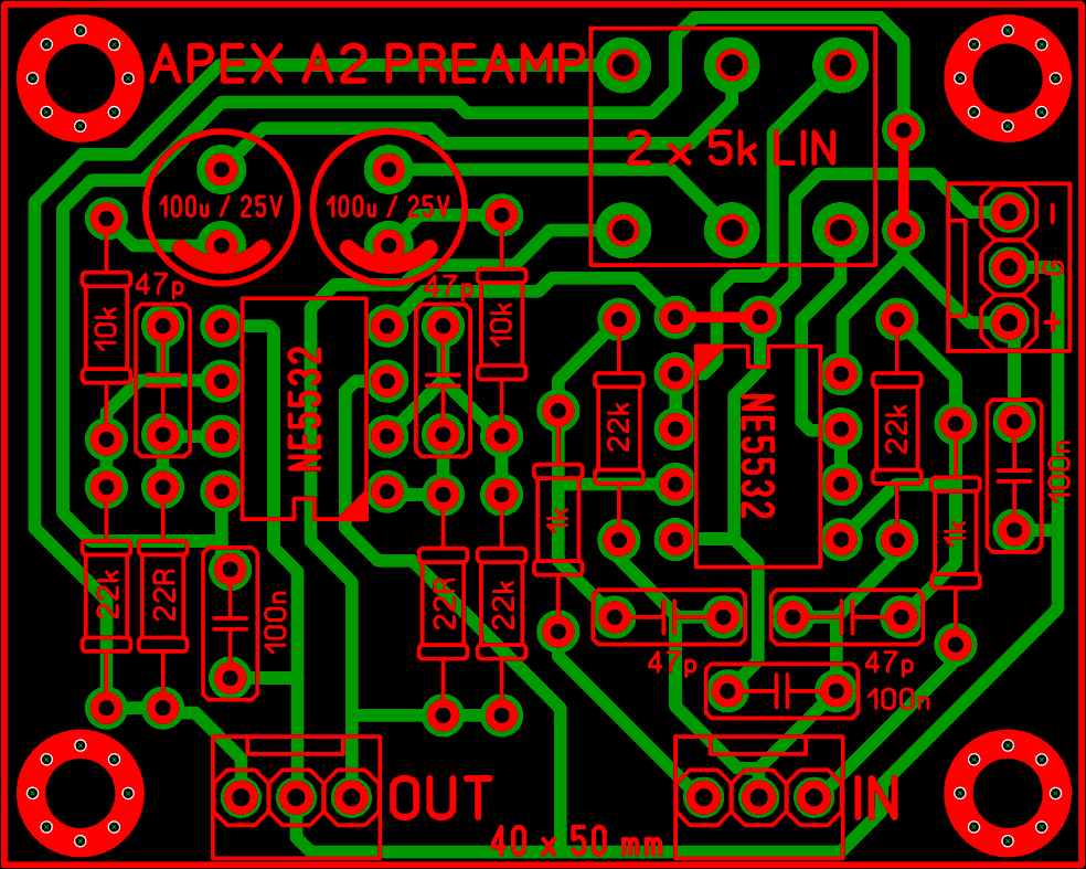

Hi..olafk,can i replacement the pot.with 50k because 5k hard to find on my country.thanks
regard
Which circuit are we talking about?
regards Olaf
can i substitute the pot.5k with 50k because in my country this part is so hard to find it.I am so sorry for my question,i am talking about preamp like this
i am sorry my bad english.
regard mantrieSolder
