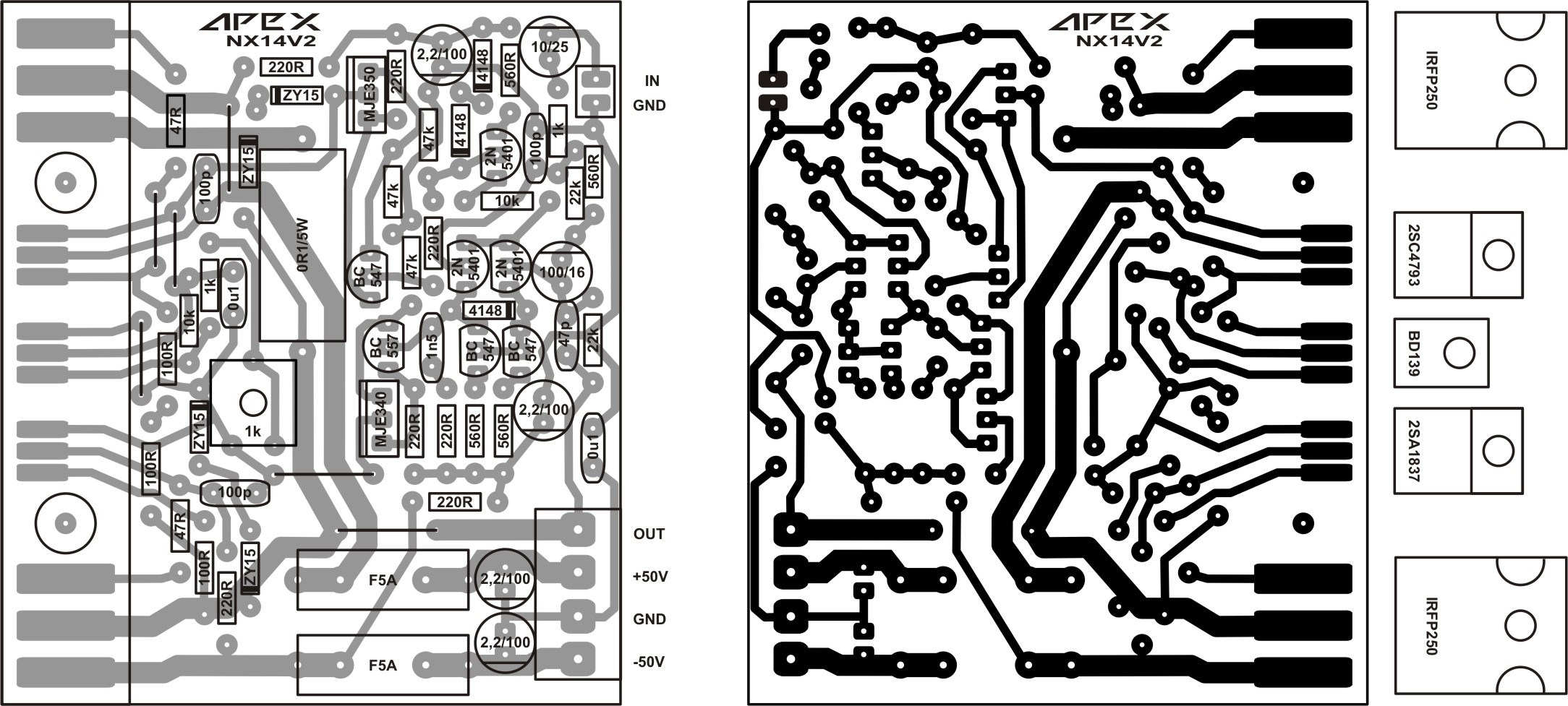

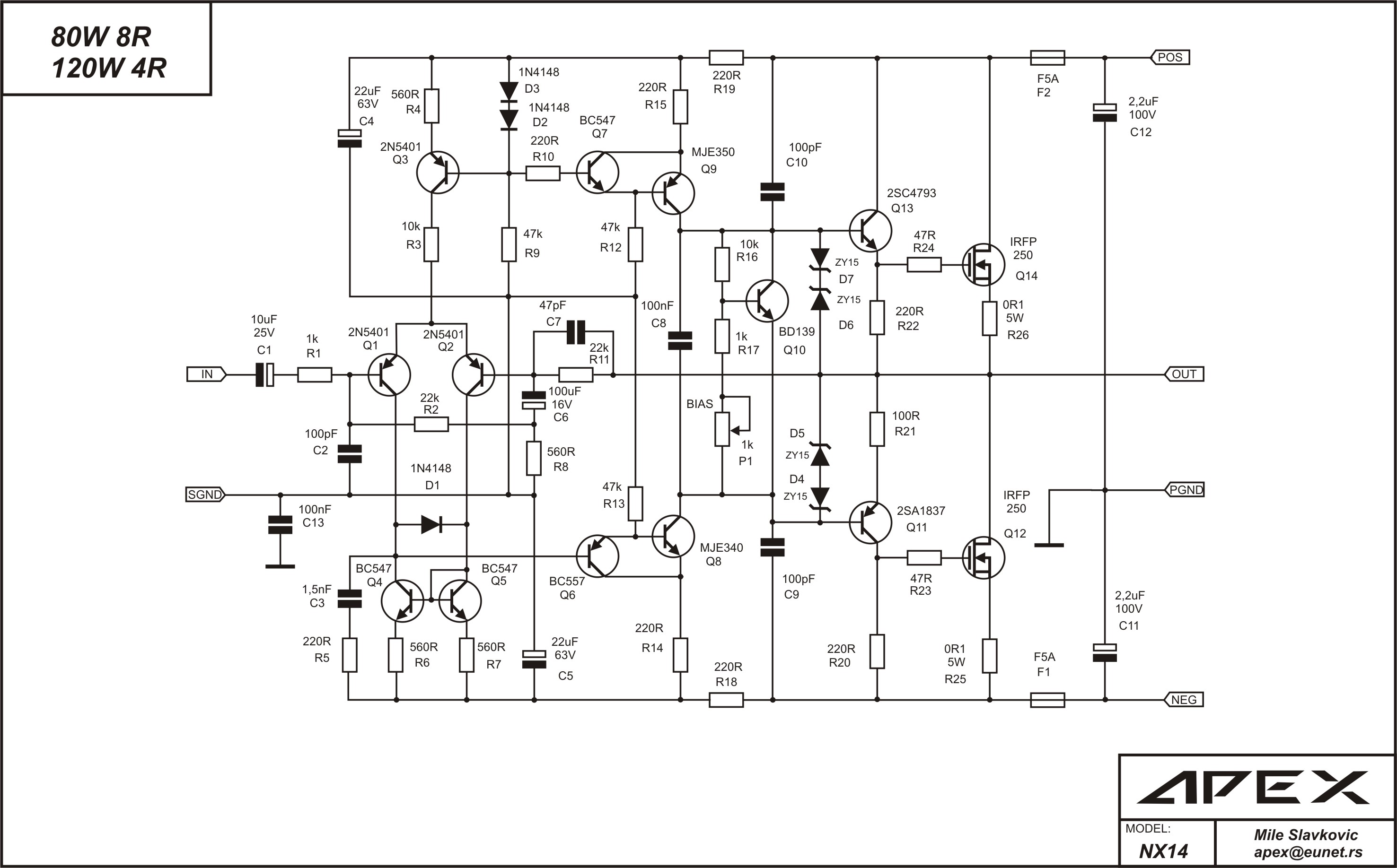

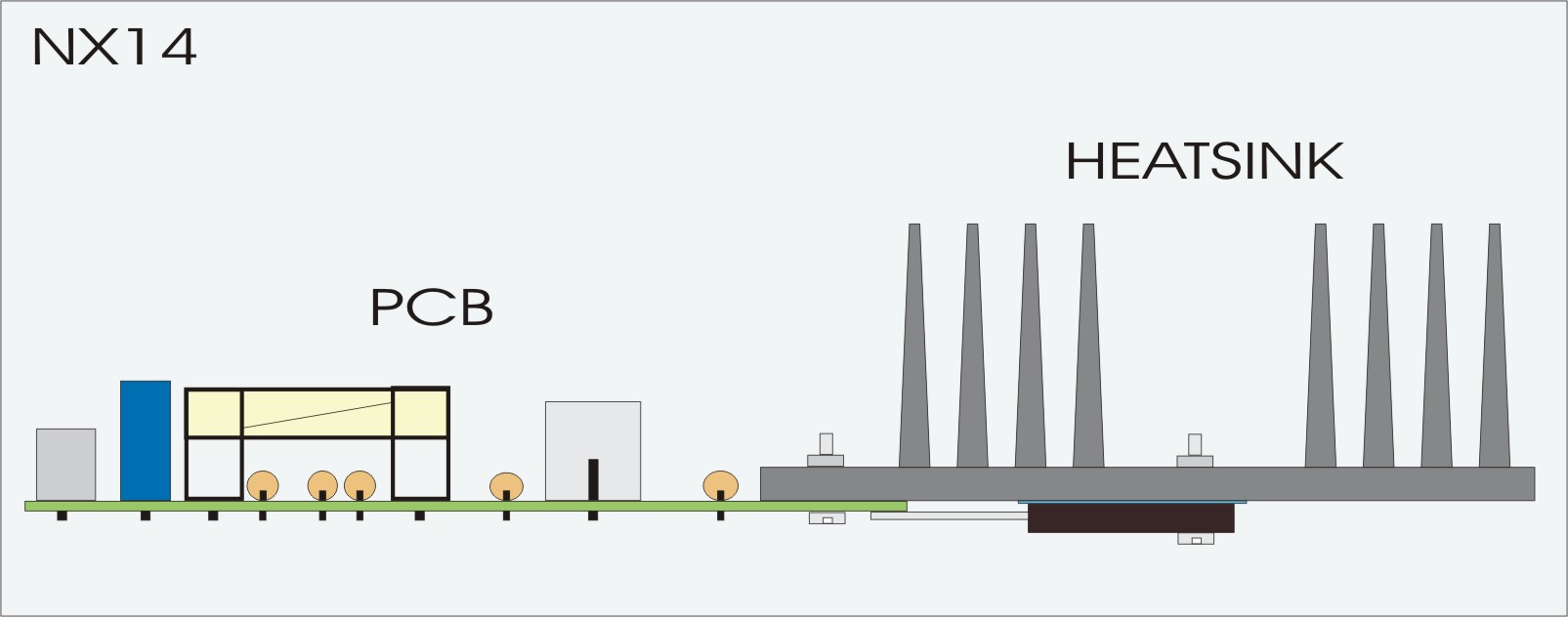

Hi apex, thanks for reply. i replaced bias resistor R16 (1k) with 1.8k, R 17 (220) with
470 ohm and analysed AX14 circuit with spice. now all nodes showing proper Voltages
and currents. expecting your technical explanation. thanks again.
No need to change value of R16 and R17, just change value of variable resistor P1 (0-1k) to get about 2,2V on Vbe multiplayer Q10 (BD139),
Regards
:)sir mile,
do you have pcb design for this NX14?
please share
