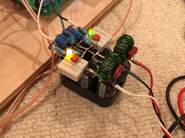

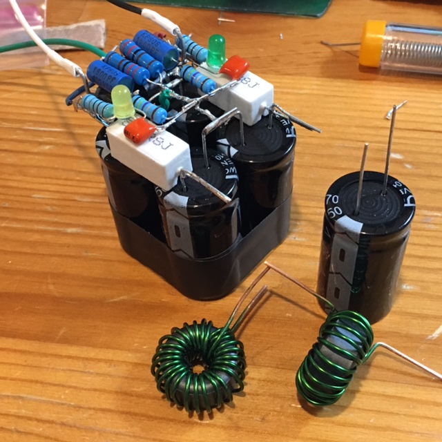

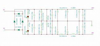

Making progress with my next PSU. Running some simulations on it for a CRCLC. Adding some Dx style filters right after the bridge to filter the diode switching noise. Those are hand rolled inductors 18ga (ferrite core) coming in at about 0.5mH. This whole point to point is kind fun for PSU's - certainly more compact than a PCB.
Any schematic?....can you post picture of makeing...how gnd and lines are connected.? Thank you.
This PSU uses filter elements similar to the Dx PSU, but I changed it to a 3-bank CRCLC type filter.
The diodes I am using are labeled 10A10 (big fat leads).
The new PSU works well. With amp connected but no music ripple for 35v is 5mV. It was 36mV with last supply.

Thanks for the complement. It looks like a spacecraft from Star Wars. The diode bridge is soldered in a square frame block and sits on the back.
Ahh... I kick myself for selling my analog scope 6 years ago before I got into DIY. This was measured with Fluke 101 in ACV mode.
I noticed a subjective (audible) improvement with reduced low level 60hz hum. Placing my ear against the woofer - I can barely hear hum. Before I could hear it slightly (not terrible by any means). This makes sense as 5mV is much less than 60mV (-20.5dB improvement - my previous post said ripple was 36mV was a mistake, it was 60mV). The rest of the music frequencies are not any different but perhaps there is an improvement in fine details that give better imaging.
I am glad I tried making the PSU as a P2P though as I am looking for a compact format to place in a rather small enclosure with the already very compact stereo FX8 50mm edition.
I tested this new PSU with my new vHEX amp last night (heatsinks came in) and it also sounds fantastic. No audible hum at all with ear pressed to speaker cone.
