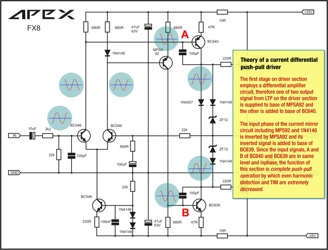

I consider that the push-pull driver stage does the trick mostly. A further step to understand the magic of FX8 (and AX11) see the attached picture.
