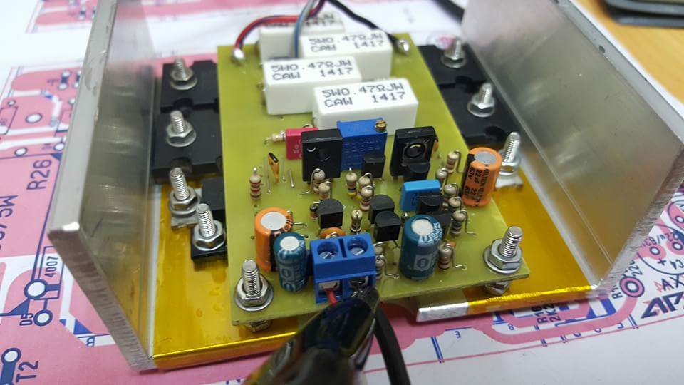

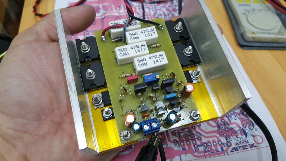

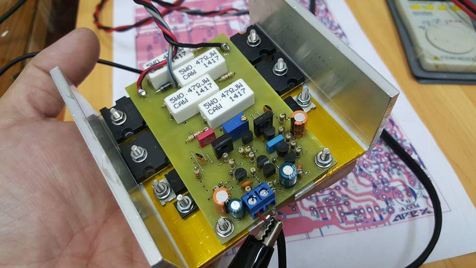

Thanks... speaker connected on the (OUT)
very nice! where is pgnd connected?
Input GND should connect to star GND and PSU or Power GND.
yes. very elegant design. can you educate a newbie on your ground connections? does signal ground connect directly to star ground...then rca input ground will also connect directly to star ground? thanks.
ok. i see the alligator clip now. im guessing that goes to star ground. thanks.

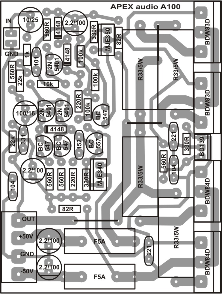

Here's the file for you to DIY.
https://www.dropbox.com/s/m8qma092ijh7vuu/AX-14 Ver. 2.0.rar?dl=0

Thanks everyone i'm glad you like it..
Hi Wiljj78,
Nice layout.
Mr. Miles's schematics/ layouts always have separate power ground and signal ground. and i/p ground has to be connected separately to PSU star ground.
Have you run into any hum issues with your layout?

Not at all... The amp is playing crystal clear and dead silent..
ok. great!
