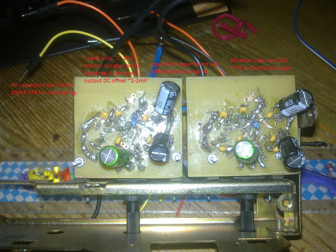

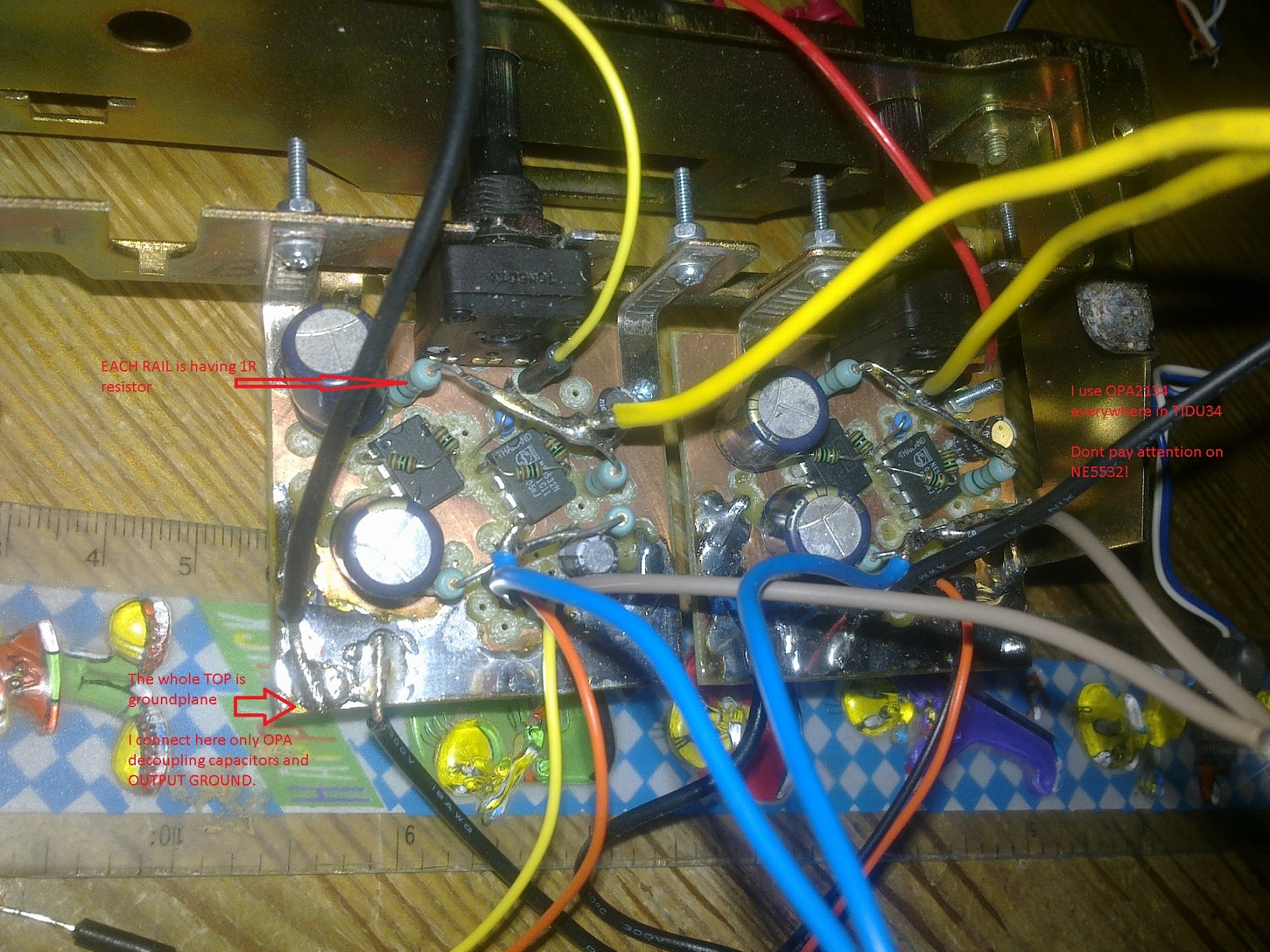

I have played with TIDU34 project for about a year now.
Using OPA2134 and NE5532.
You can get very nice results with LM317 type psu. Its all about the design.
For noobs, i recommend not to use any regulators if you don't know how to make good PSU decoupling networks.
For example, original non-modified design from tidu34 pdf last page sounds good with LM317/LM337. Use 220uf ~250mR ESR@ 100Khz cap on regulators output.
Decouple every opamp psu pin with 10uf 35V miniature Nichicon PW series capacitor(~1.1R ESR@100Khz @ 25C). I used x7R 100nf caps in parallel with 10uF too but not sure if they were needed. It was all done very closely to opamp pins on prototype board. Use ceramics everywhere on feedback networks , COG type works best.
So i modify the first one, add WIMA MKT and TANTALUM as replacement of opamp psu decoupling... FAIL... sound was worse...
I build another one with WIMA 100nf MKT and Electrolytes as paralleled OPA decoupling, again sound is bad.
In next pictures, its the 5th TIDU34, on the PCB now.
It sounds BAD with LM317/337...But, when psu is replaced with simple TRAFO-CRC filter, the sound becomes VERY NICE again.
Modified the input filter... removed the capacitor, replaced 3.3nF with 1nF COG. Resulting in more detailed sound and better bass response.
(22uF ceramic vs 10uF electrolytic made no difference for me in tidu34 signal paths).
USE 100R output isolation resistor. And DONT USE WIMA MKT's and whatever random capacitors in decoupling networks
As i have no noise on the output with simple CRC PSU and offset voltage is 0.1-0.4mV, i will stay with CRC. Even with 50mV DC input voltage(without input DC blocking capacitor), i still have 0,1-0,4mV DC on TIDU34 output.
OPA2134 everywhere.
6th Texas will be build on the PCB again using 1st TIDU34 10uf decoupling techniques, LM317/LM337 PSU and 5th texas input filter modifications to get most out of it.
EDIT: 1-2mV was with NE5532 replacing the last two opamps in TIDU34 schematic. BTW, NE5532 is actually more neutral sounding, OPA2134 more agressive.
