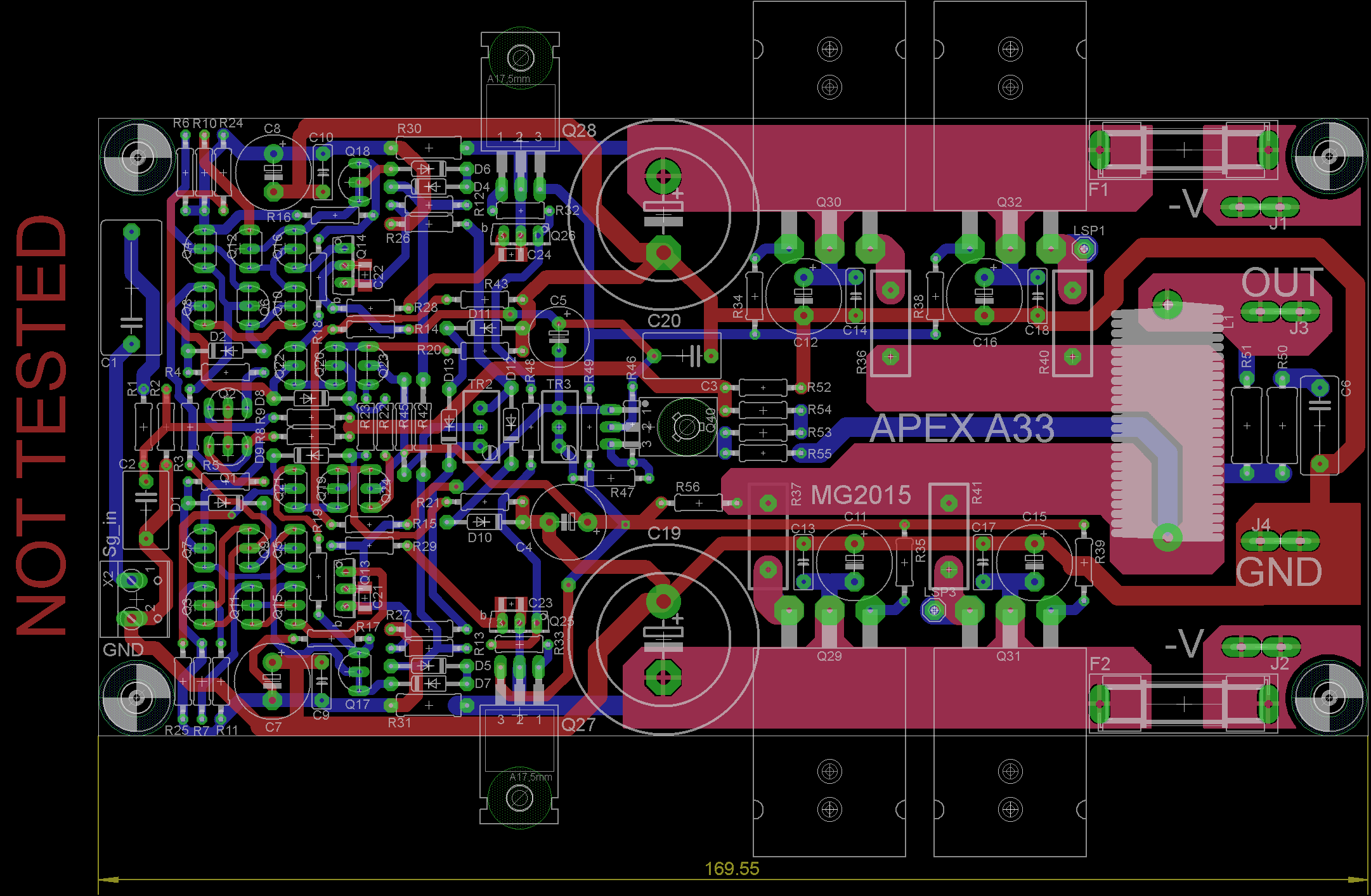

Sorry, must be my ignorance. What is CMS pads wore?
No still4given me sorry for may bad english; Its means that i added cms footprint.

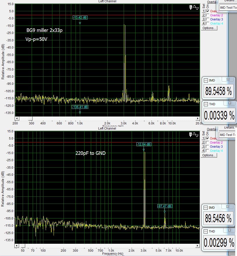

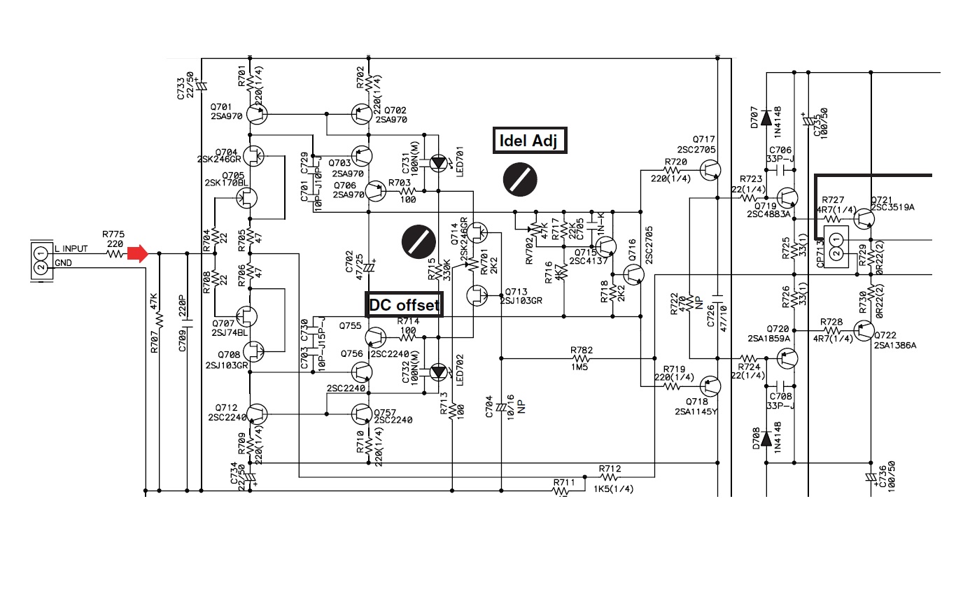

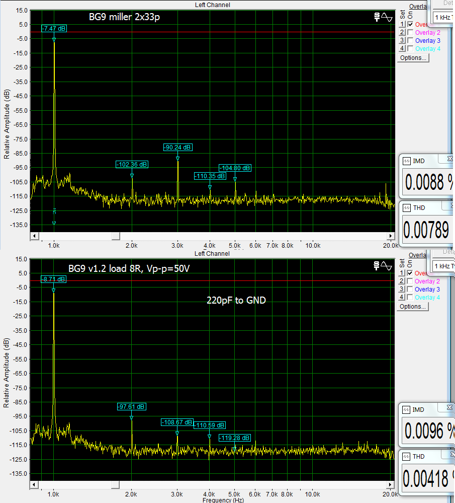

Some time ago I have made very similar marantz kind of amp. I have spent lot of time on it, measuring and listening.
I think better is to keep the caps on the predrivers than putt Miller compensation at the VAS.
I persume I know why Marantz didn't used Miller caps at the VAS, I have done some tests and please take a look how the harmonics spectrum looks like with Miller compensation VS compensation cap connected to GND.
With compensation cap ''GND'' connected , haromics spectrum, IMD products and sonics is way better.
Terry
Yes I mean the 470p cap. If all is good enough it is not required of changing it but test can be made in some free time.
Terry
Yes thank you, I prefer shunt compensation better tnan miller.

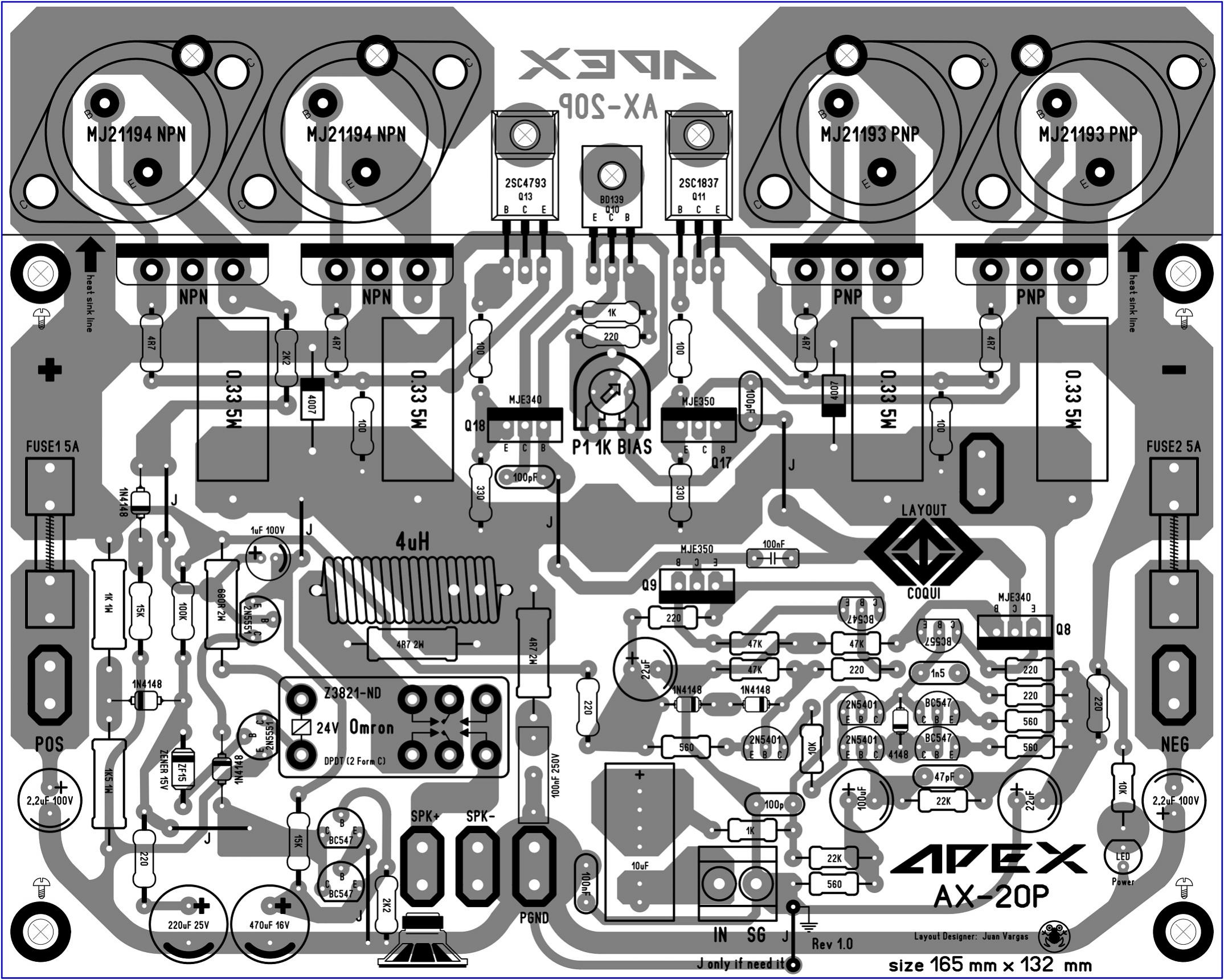

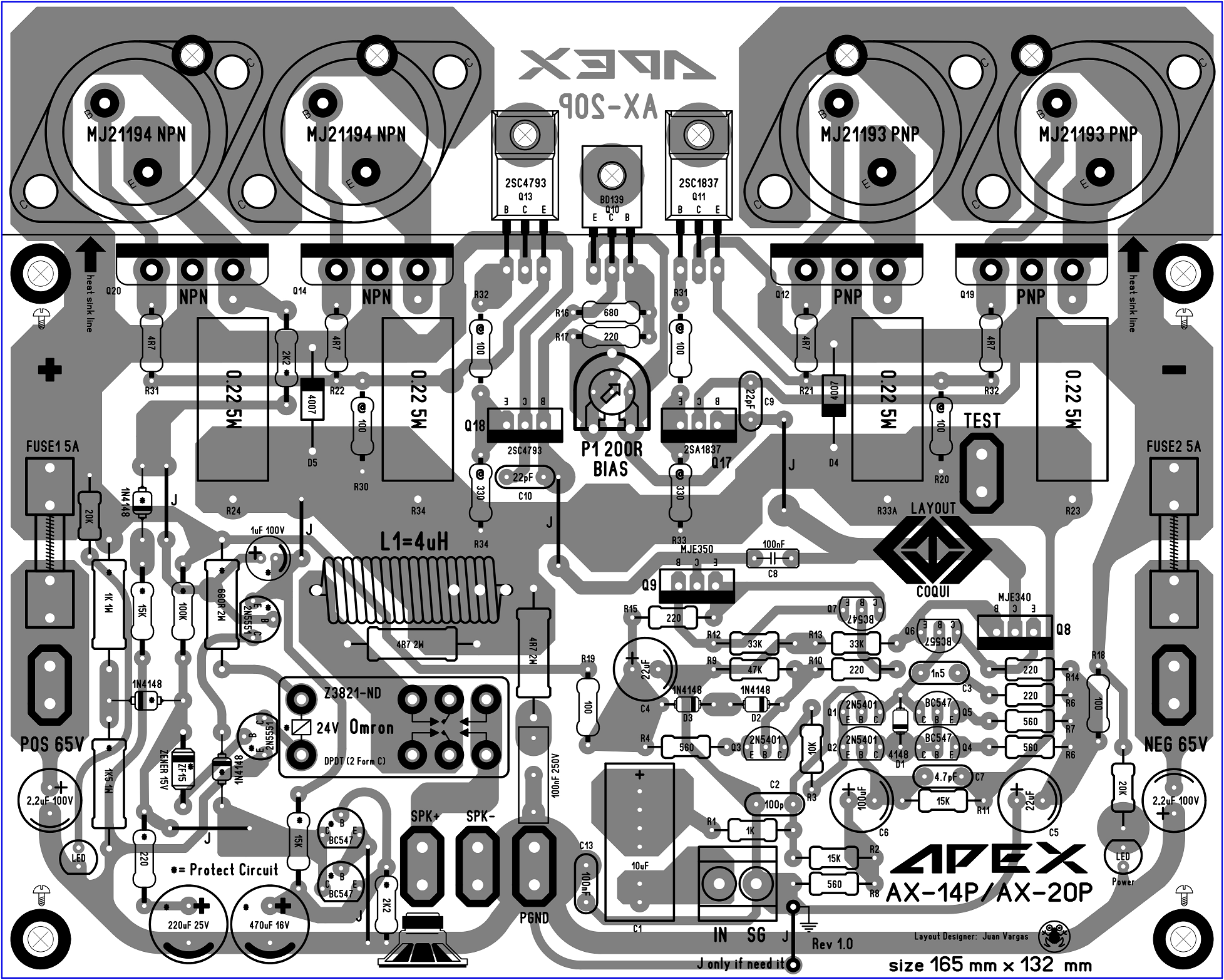

Hello guys
I know the AX-20P is not a new subject but I would like to post here the changes of this layout to turn it from AX-14P to AX-20P I'm almost done with it this take time so I will continue checking to make sure all is correct
Regards
Juan

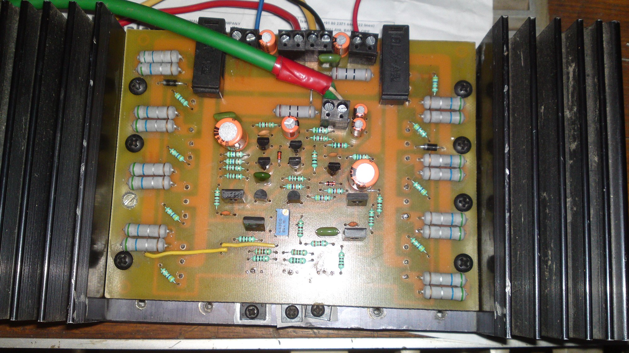

Thanks Juan for making AX-20P.
I did made 4 pair version of AX-20 for old yamaha amp. Its still running and my friend loves it.
Regards
Sonal Kunal
really nice sir :) Yamaha fusion :D
yes I still checking for errors I'm not done yet here is the last image of the AX-20P :)
Regards
Juan
