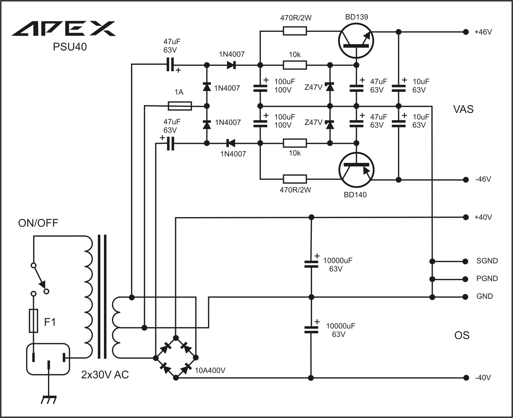

100R feedback resistor must be connect to input gnd (SGND) not to PGND...

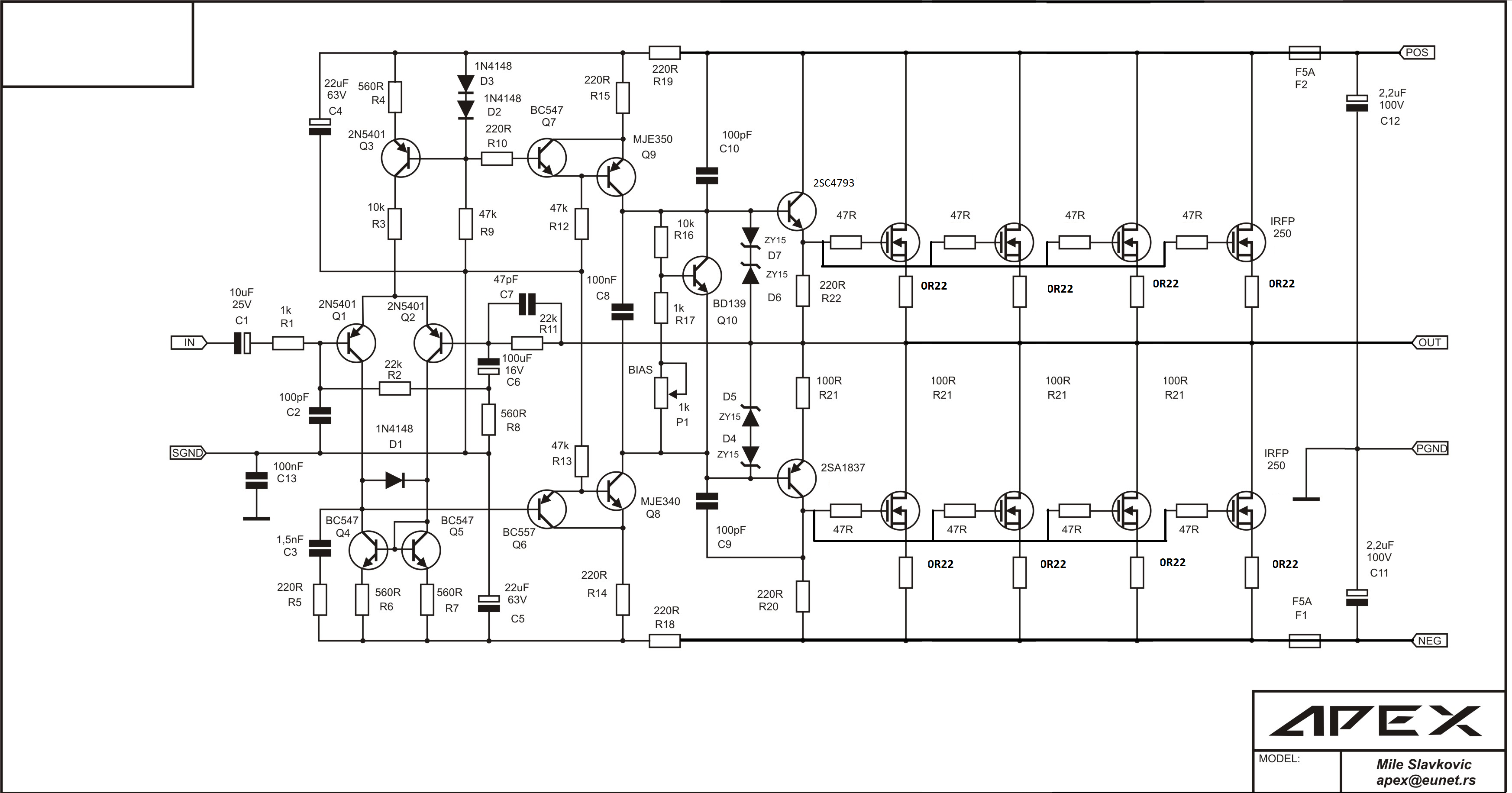

I want to make nx14 with 4 pair output FET(irf460). Please check is there any changes required in schematics? View attachment 454489
No changes,

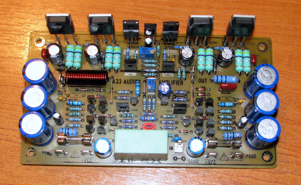

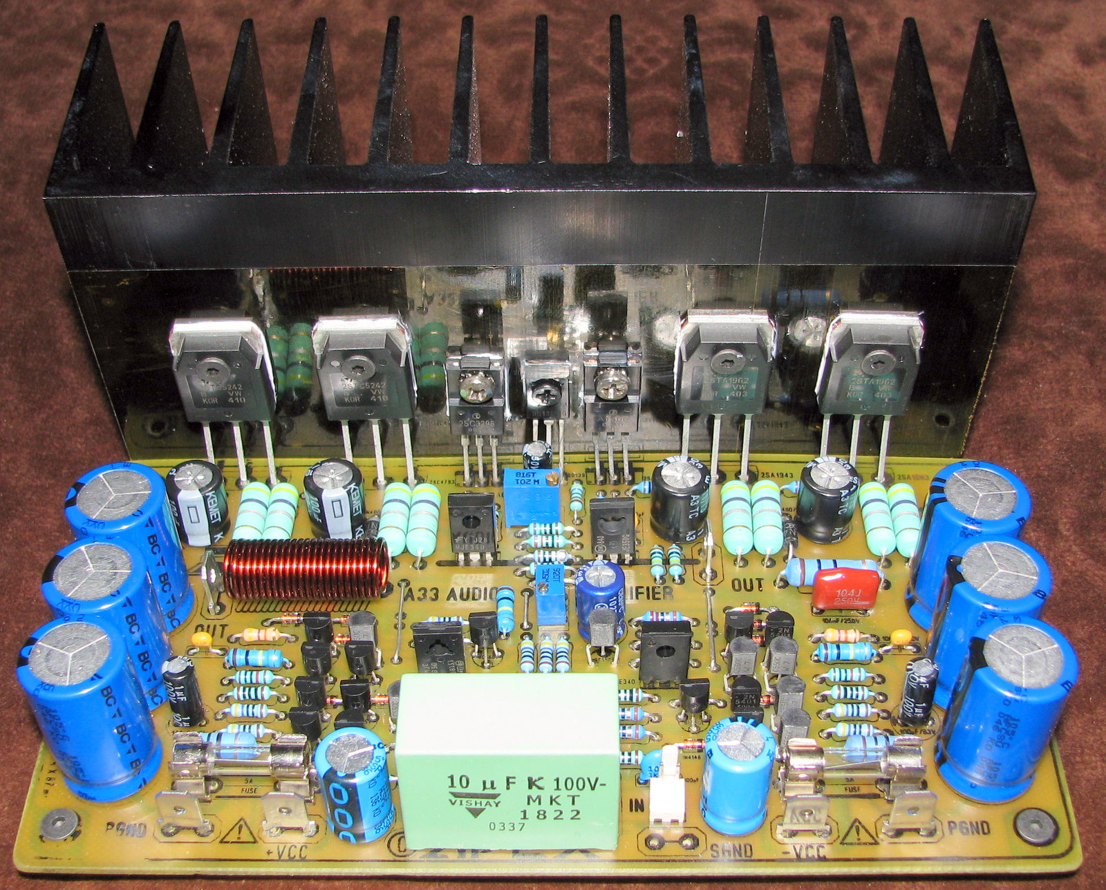

Next amplifier A33 , not ready , missing 3 resistors . Tomorrow will be ready for testing ......
Regards,Alex
Wow, that is a true work of art. Looks in real life as good as the pure pcb-design (and a bit better ).
Very cool!
regards Olaf

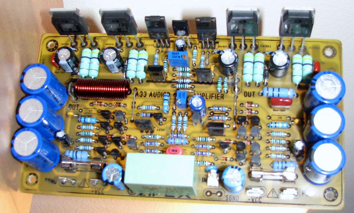

Regards,Alex
Nice work good luck with test,
Regards,Alex
Nice nice nice Alex....Bring it on..
May I ask ho w you get such a good silk image?
I have not tried printing component labels yet, but it looks like toner transfer using flat iron???
toner transfer,he has found out what temperature is the best to do it. if the iron is too hot that the paper will stick to a pcb and labels will be brittle and fragile. if the iron is not warm enough than paper will not stick to a pcb but neither will labels.
it depends for each iron and it must be adjusted with practic work. it depends from thickness of paper used for printing,thickness of toner on paper and than on temperature.
the easiest way is to use the laminator (if that is the word in english) ,a device that is being used to make a visit-cards. slide a pcb with toner-transfer paper through it 10-15 times and you will get similar results.

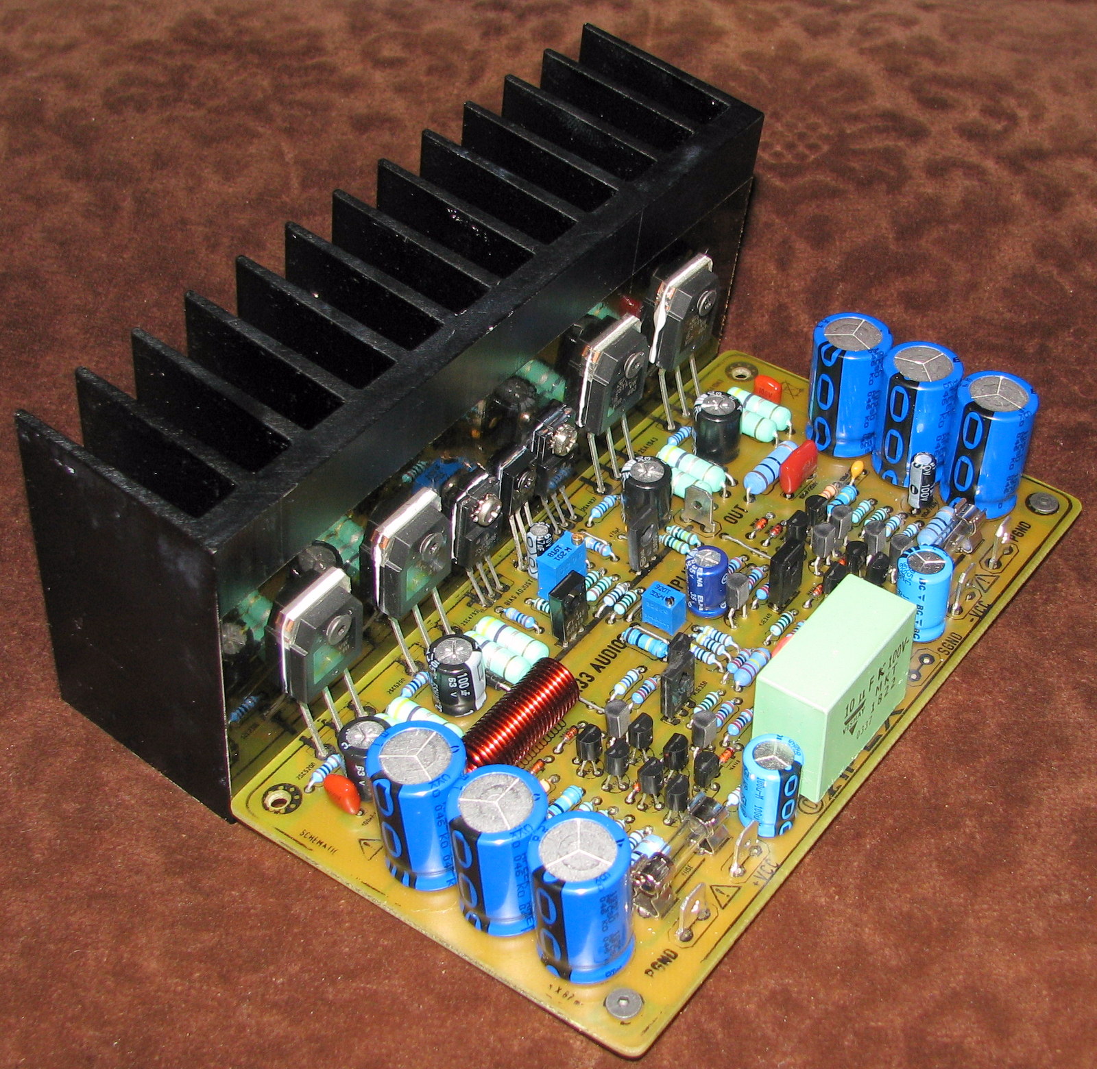

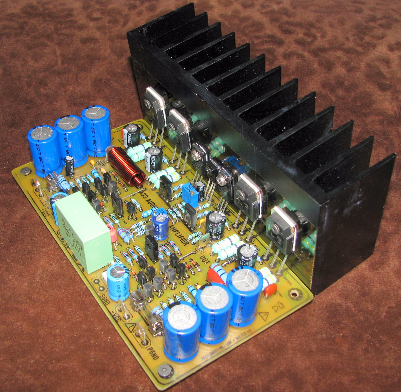

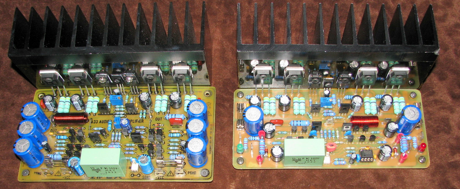

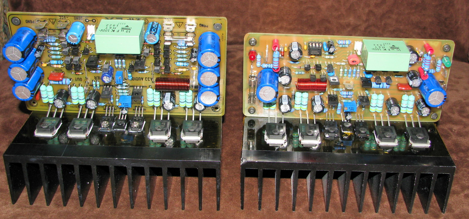

Pictures A23 +A33
Thanks for comments , new and better pic's of A23 and A33 amplifiers .....
Regards ,Alex
Regards ,Alex
Regards ,Alex
Nice pic's, thanks.
