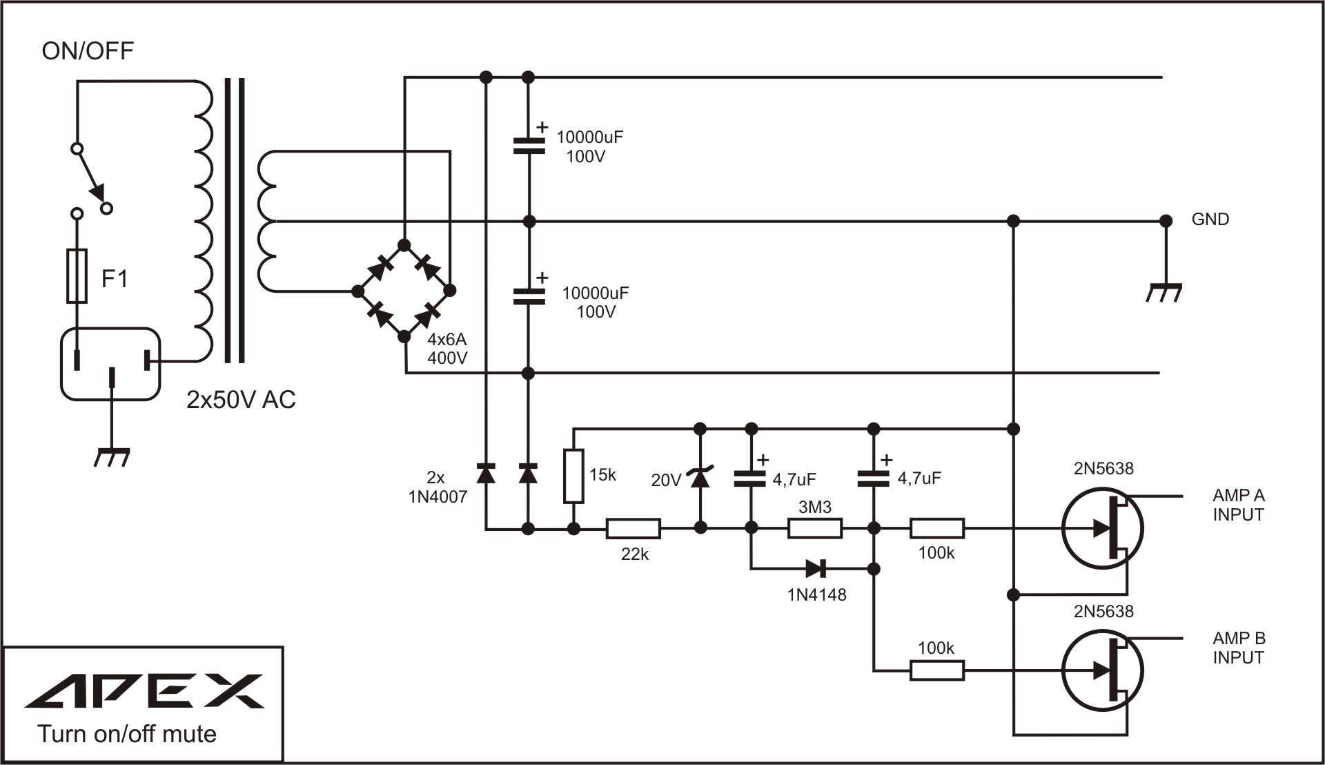

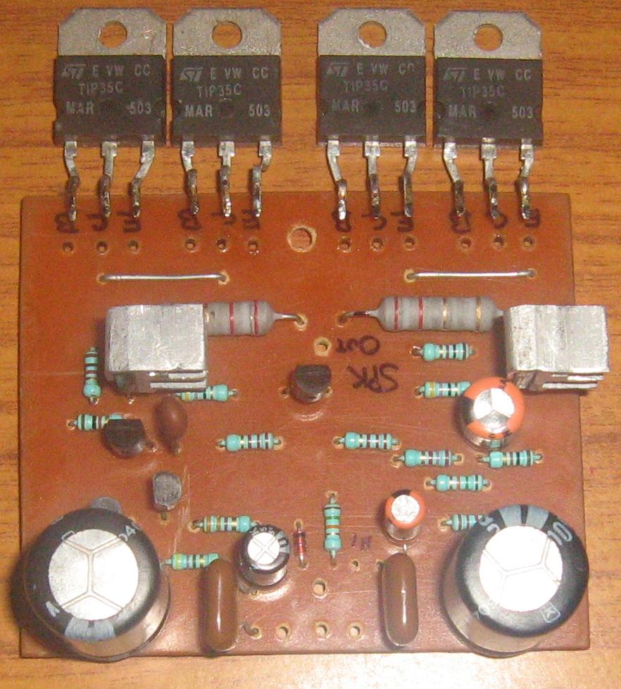

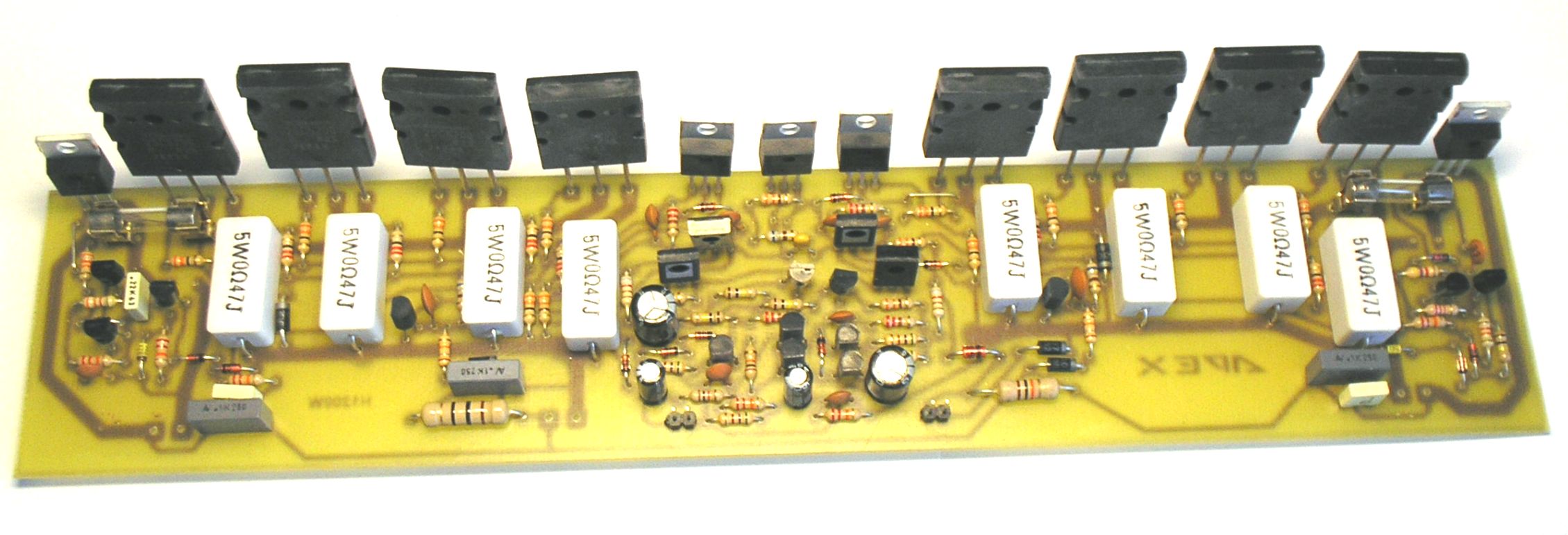

Turn on/off mute input circuit, without relay at the amp output.

Hi Apex,
how does this circuit work? :eek::eek::eek: What does this do? If I have this on the input, I don't need a switch on delay circuit. Is this correct? Any progress on Studio Reference PCB?
Macd;:rolleyes::rolleyes::rolleyes:
Fet short circuit amp input to GND and mute singnal when amp switch off, and umute with delay when amp switch on. DIY version of 'Studio Reference Amp' PCB will be share soon.
