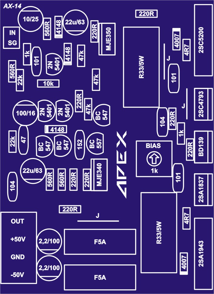

I made a new pcb. Is this board correct?
Thank you for your help. :)
Paulo.

Polarity for D4 & D5 on AX14
Dear APEX,
I have build AX14 using your PCB & layout in post #62.
I found one mistake in the blue component layout diagram: the polarity of D4 & D5 are reversed. I used 33ohm as current limiting resisters and they glows red on power up. I removed D4 & D5 and the amplifier works fine.

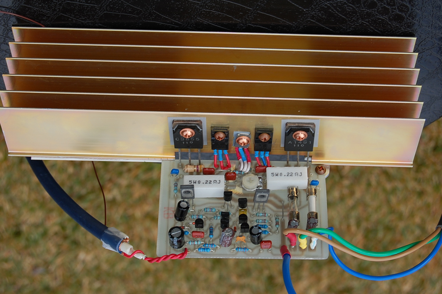

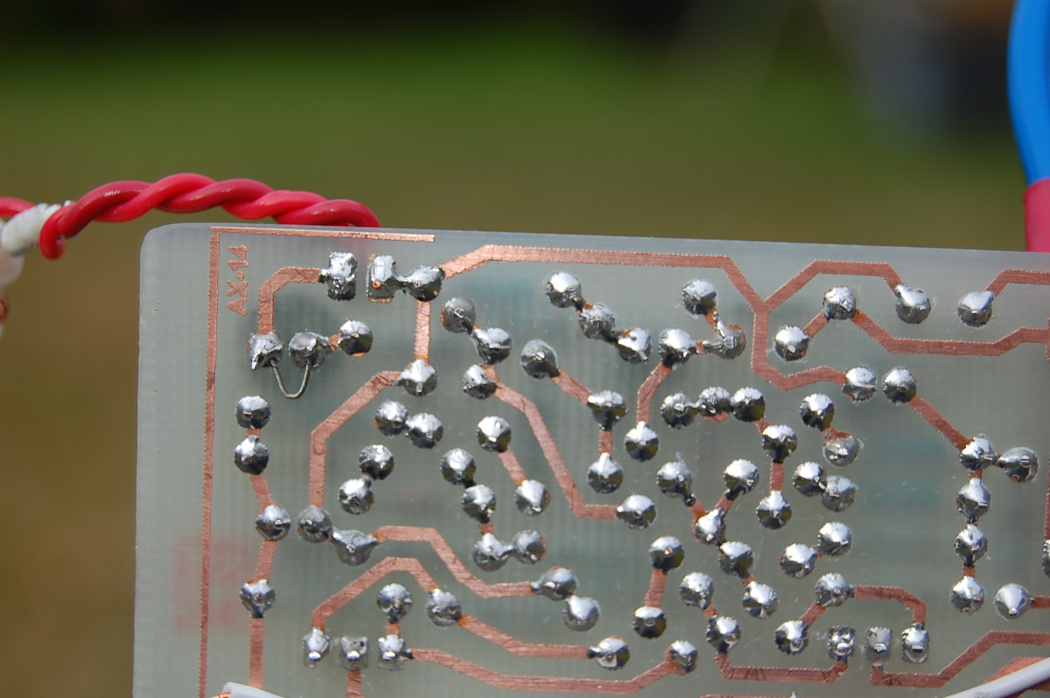

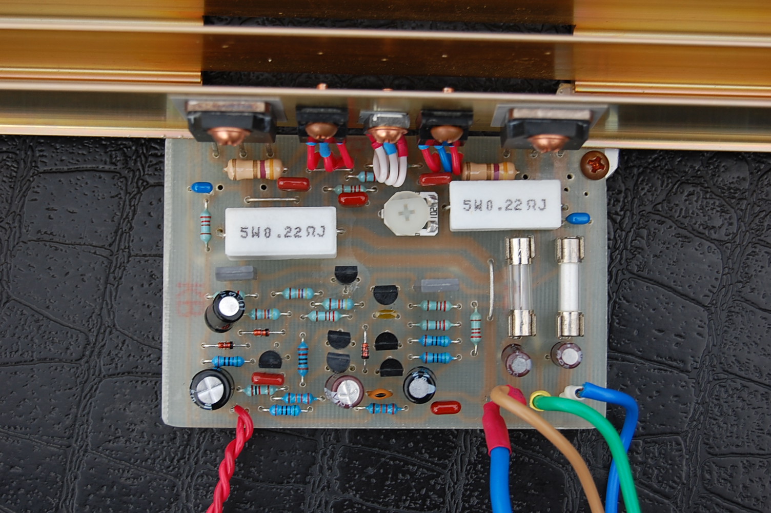

Andrew,
I should clarify:
2N5401 installed as Q1 & Q2,
Output DC offset voltage = 14mV (with DC-block capacitor)
Output DC offset voltage > 100mV (without DC-block capacitor)
BC560C installed as Q1 & Q2,
Output DC offset voltage = 4mV (without DC-block capacitor, input open)
Output DC offset voltage = 16mV (without DC-block capacitor, input connected to 15K resistor + 10K Pot)
I guessed that the BC560C got higher gain than 2N5401 so BC560C requires less input offset current.
This amp has got good bass, but I found that the treble is a bit harsh for my setup. It is OK for low-volume background music but it is a bit tiring at higher volume. I may reconnect the input DC-block capacitor & comapre.
I attached a few pictures here. The last pic shows the input capacitor was bypassed with a link.
- Stanley

D4 polarity reverted on component layout, you add some extra caps?

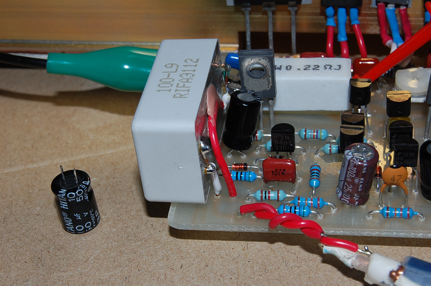

I added two rail bypass capacitors (1.5uF X7R ceramic) closer to the output transisitors.
I found the treble is a bit harsh if I removed the input capacitor (C1).
I put back C1 & that removes the harshness.
I replaced C1 (10uF Bipolar electro) with 10uF film capacitor & the high frequencies is a bit smoother.
I left the BC560C installed at Q1 & Q2 as they gives lower Output DC offset compared with the 2N5401.
Cheers, Stanley
