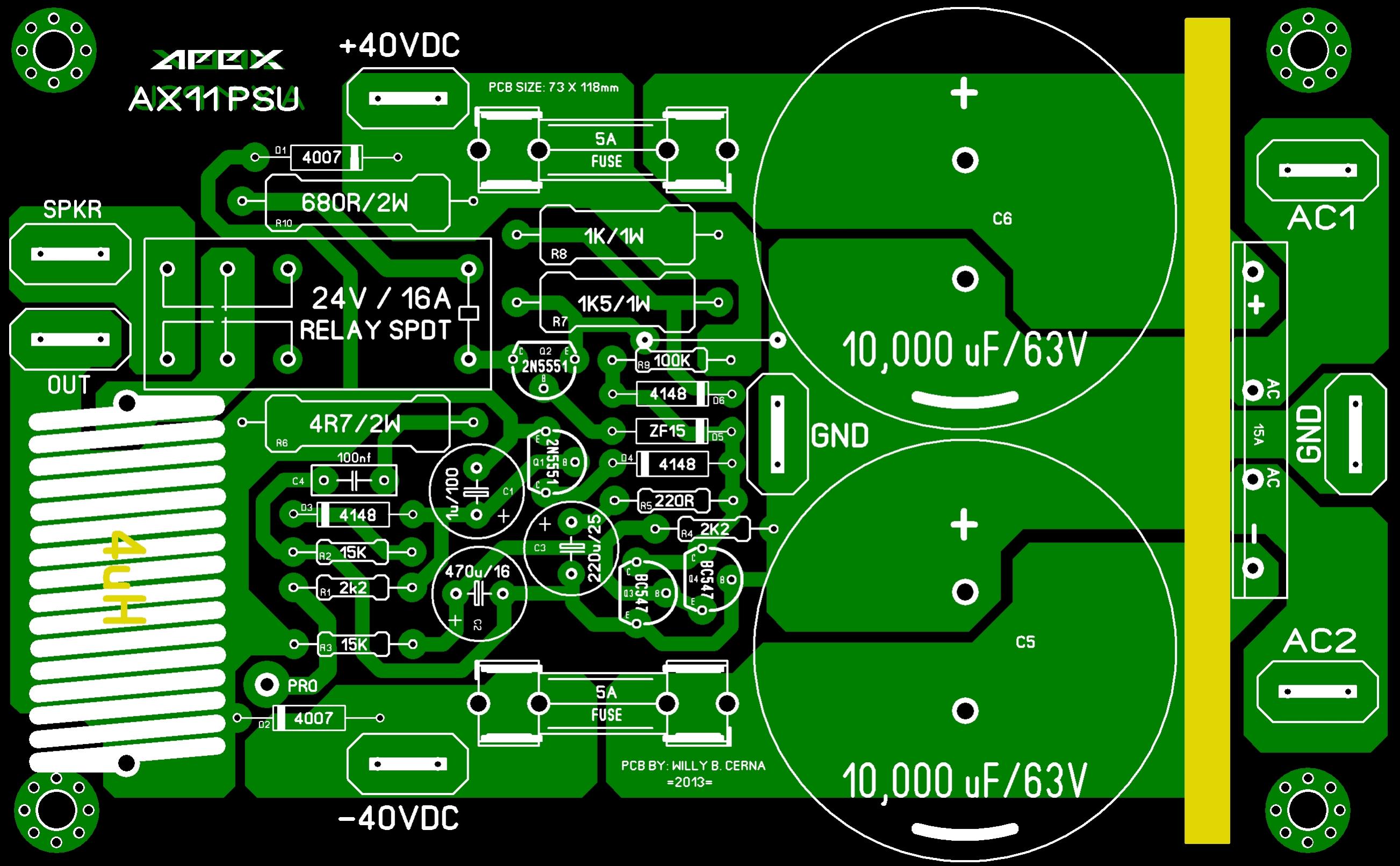

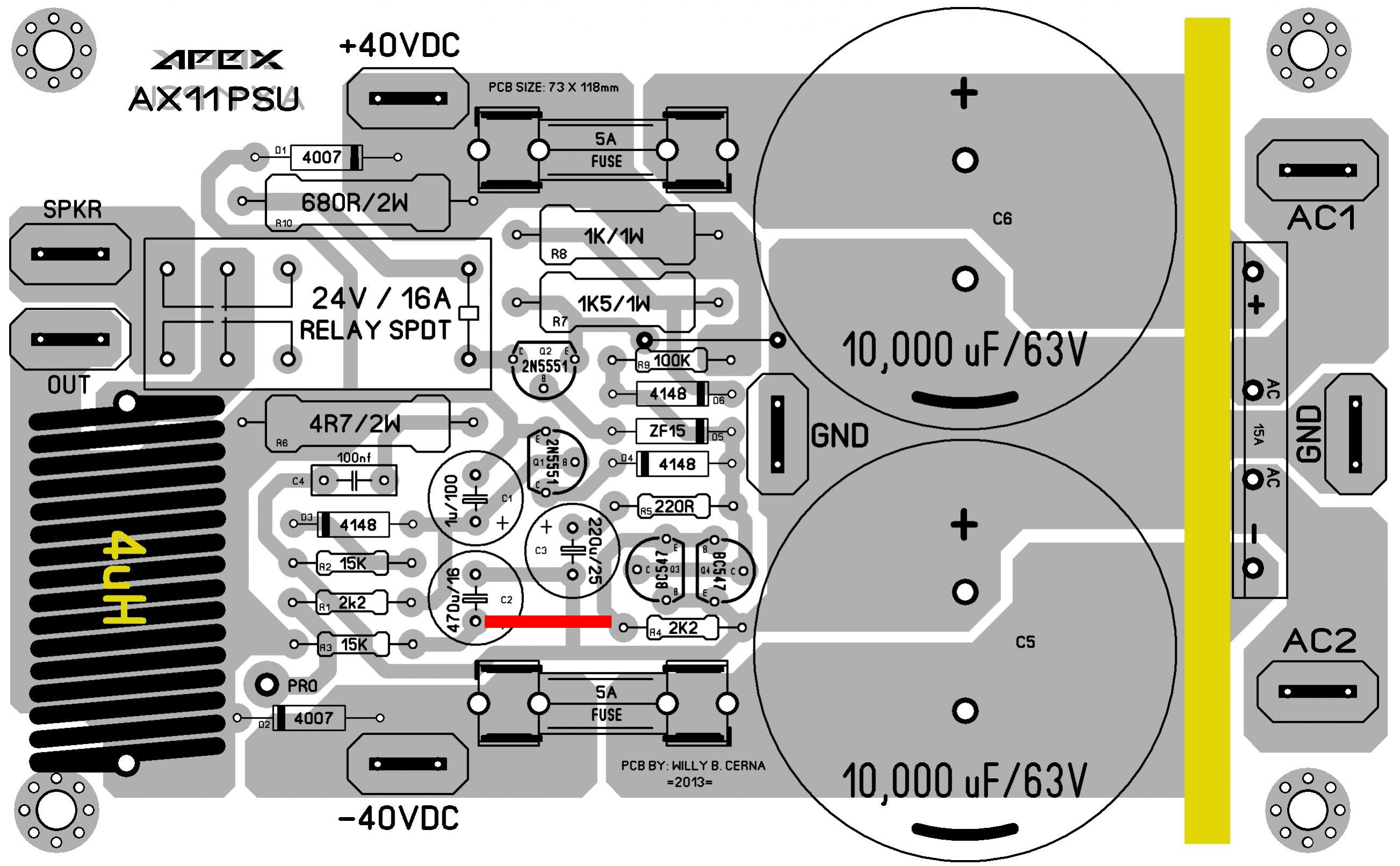

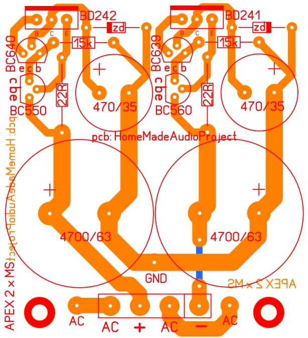

Guys let me know if you found any error.
Nice work, track mising and wrong pins order on BC547 ( C-B-E instead E-C-B )
Regards
Regards
Thanks Mr. Mile, it's now corrected.

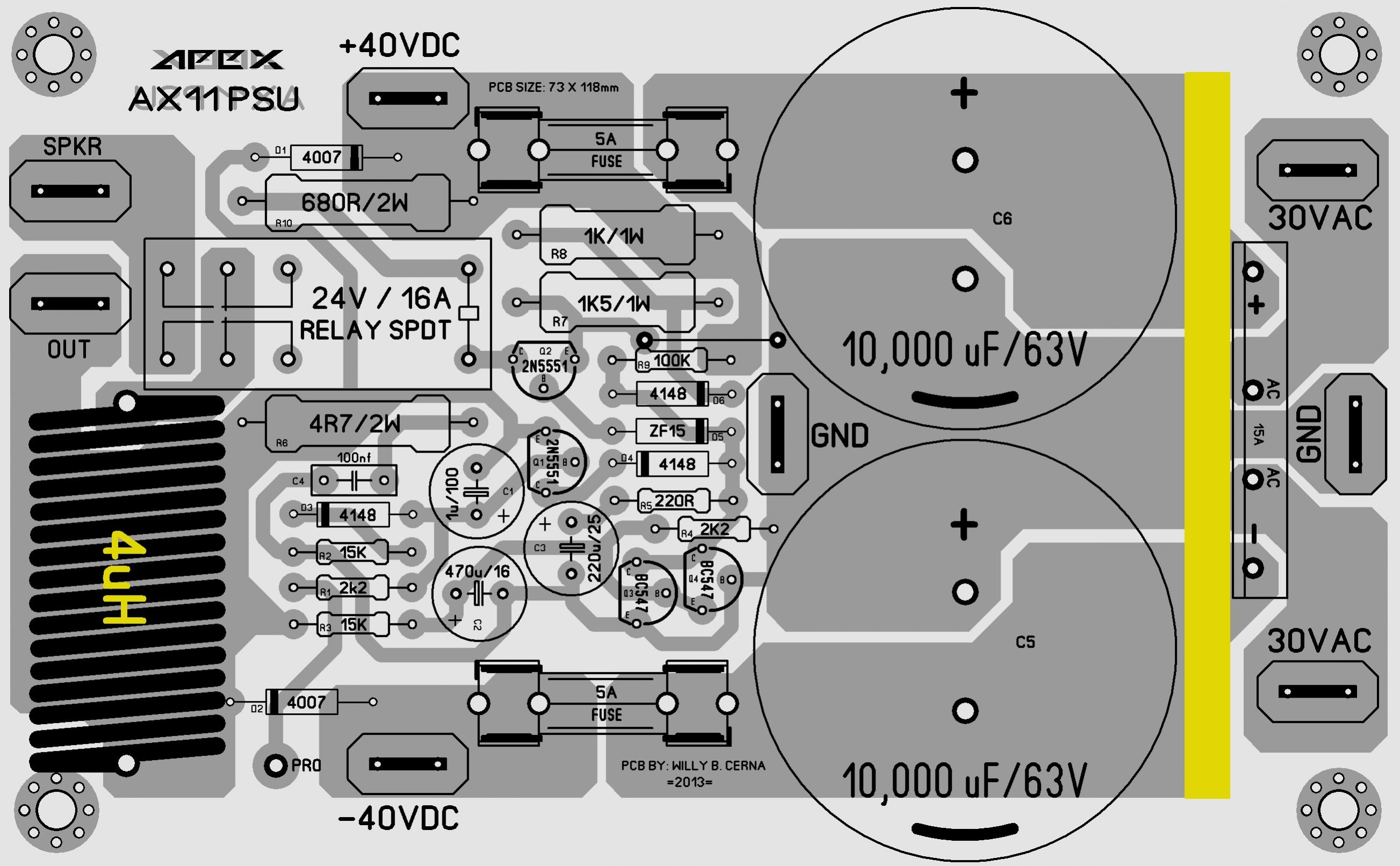

Greetings mister whether these protectors can also be used to ax 17
thank you
Let's hear the answer from Mr. Mile about this question.
ax 11 desain
thank you sir Mile who have shared her design and host wiljj78 very helpful for people like me who want to make the power amp
greetings, arif sumadireja
This PSU with protect can be use for any amplifier, just change 680R/2W resistor to get 24V on relay or 12V for lower rail voltage and 12V reley.

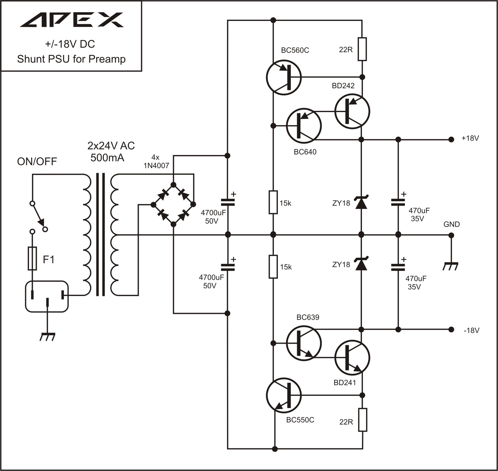

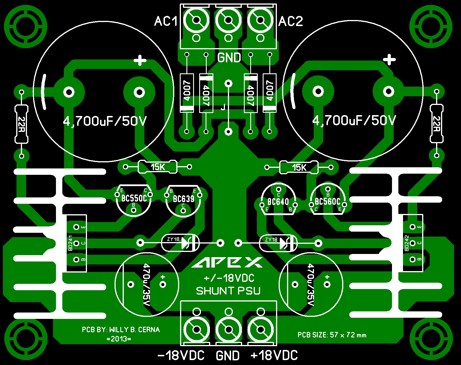

This simple shunt regulator can be use with AX amplifiers for preamp supply. Amp rail voltage can be use for regulator input (without 1N4007 diodes and 4700uF caps).

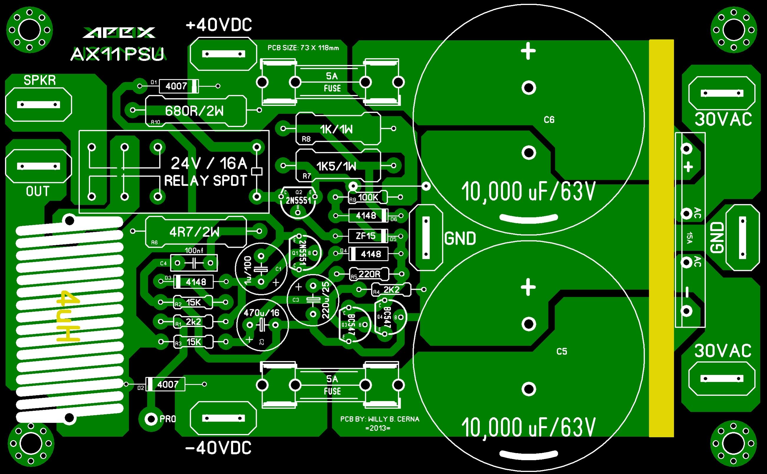

Here's the PCB.

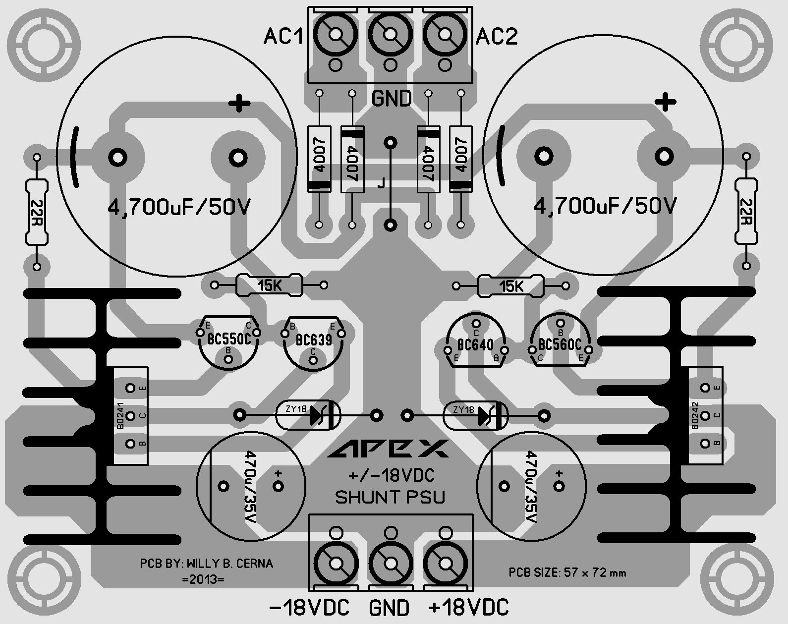

bottom layout
Her design is very nice, is there a bottom layout ..
Thank you so much ..

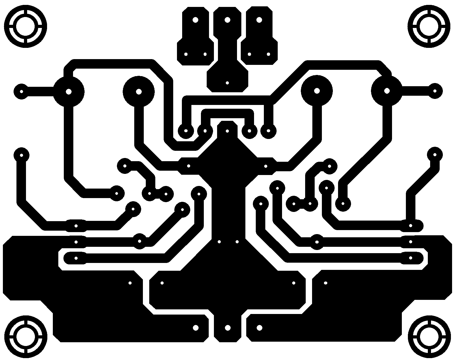

Thanks Sir Wiljj78, my question : how the size of the image?
PCB size: 57 x 72 mm

Here's the buttom layout.
Thanks I'm gone to use it.
