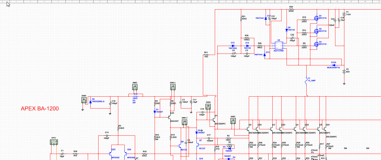

hi apex sir, is vertex step works with ba1200?
pls help me to make ba1200 to class h sir.

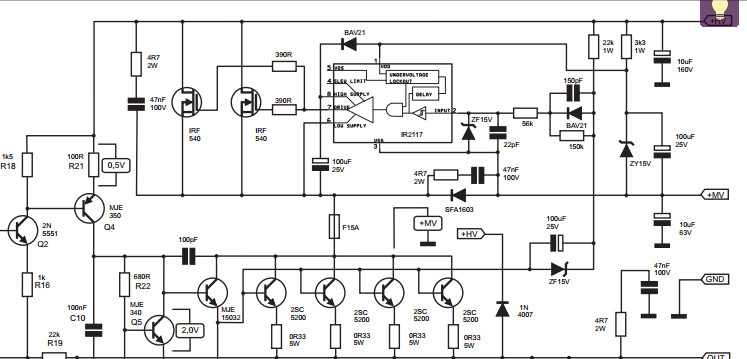

Sir ,
My plan for ba1200 want to use MJL3281/MJL1302 as outputs for rail voltage 90 0 90v .My question 1)can BA1200 works at 90 0 90 v .All it's parts like input preamps and protection works at 90 0 90 v?? 2)If i use 9 pair MJL3281/MJL1302 as outputs then what should be the safe operating rail village for 4 ohms load??
Crest Audio used 7 pairs of 2SC3281/2SA1302 with +/-85V, in their 600W amplifiers. It can work but they had sophisticated protection circuits.
