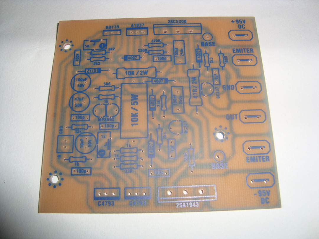

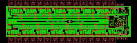

Hello Friend ,

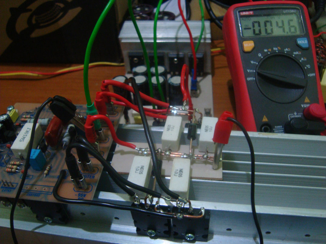

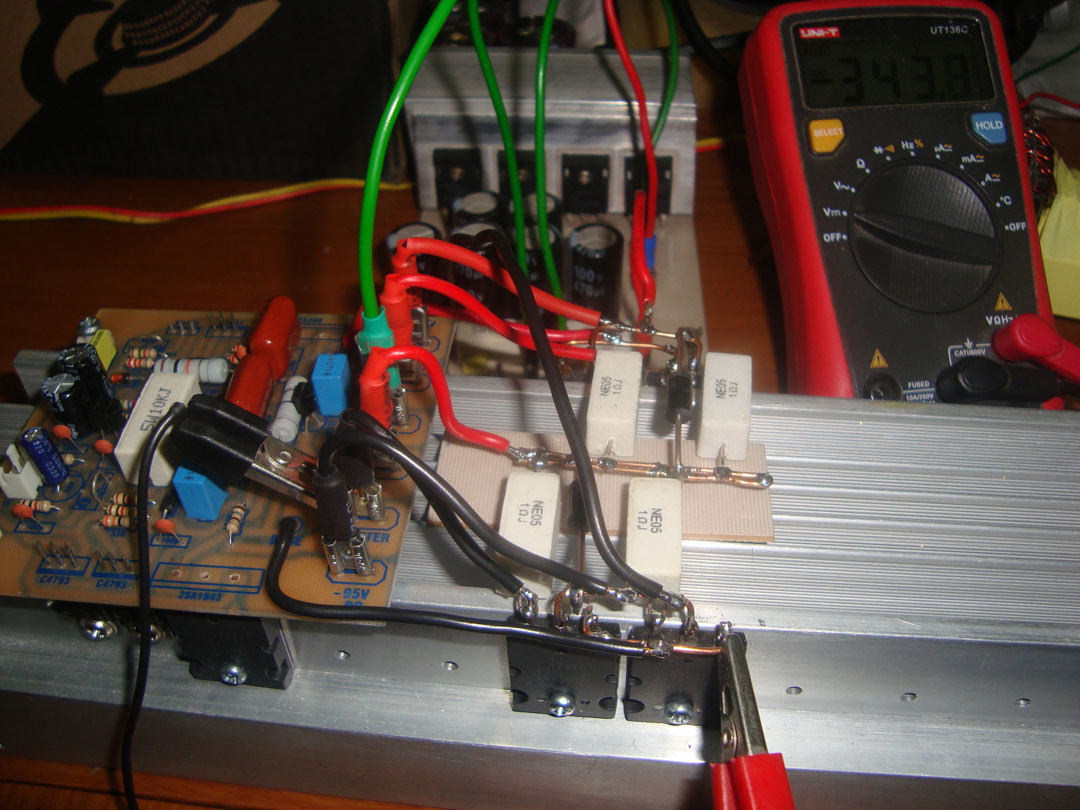

My Transistors Are Getting Hot on No load There is 160mv of offset on o/p on 52 0 52vdc supply , amp work but transistors get hot quickly can you tell ,
what did you set the values for R4 offset and R13 Bias resistors if you can share the modified segment diagram it would help a lot
i have just Damaged my 7 Pairs of Transistor twice....

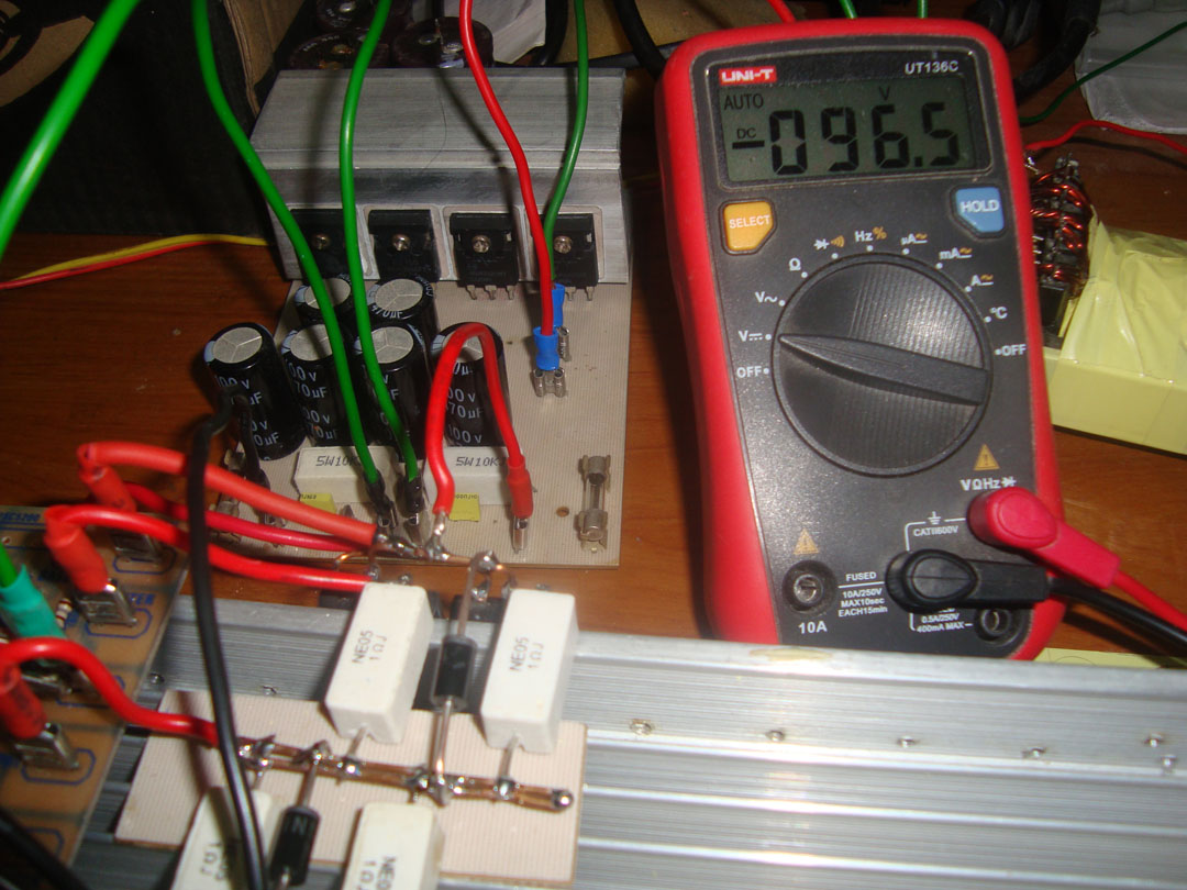

hi apex sir,
in my hand the 8.2k resistor not available, now i checked with 7.5k resistor, bias is ok,
92vdc power supply.
i feed 50hz sinewave and it clips 52v ac on output,
my 4ohm dummy load 250pcs x 1k x 5watts.
output transistors getting hot over 90degrees at 40v ac on out..

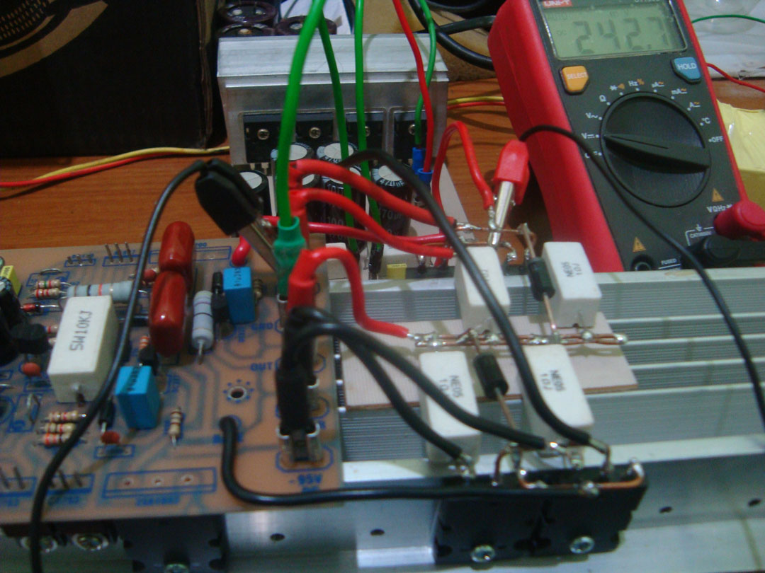

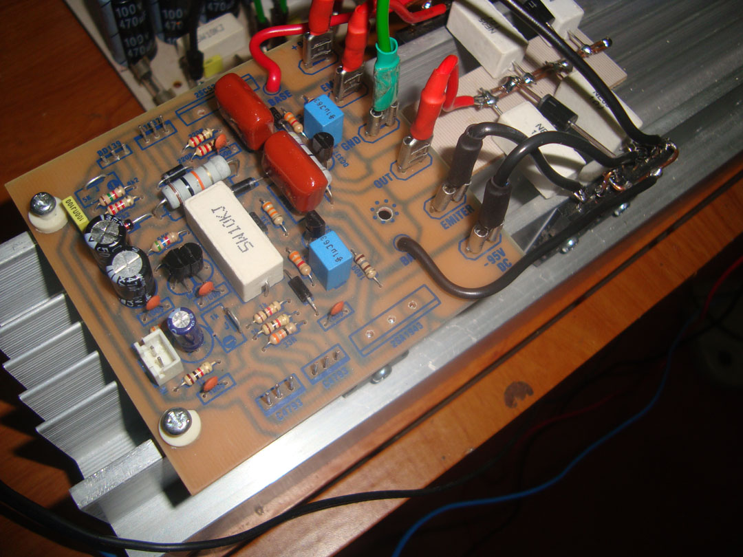

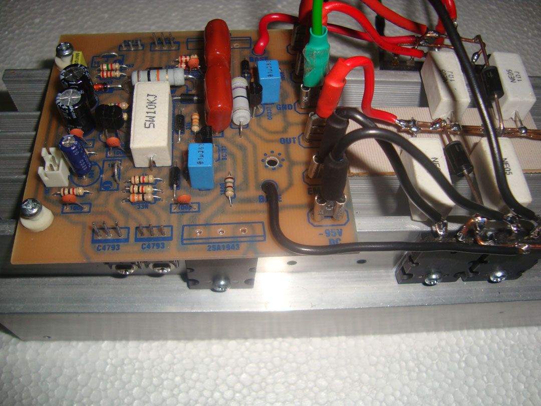

hi sir

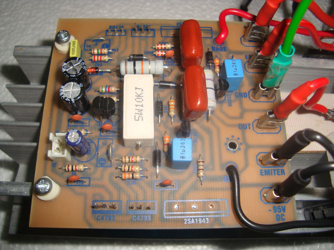

please measure the voltage between base and collecter it should be below 0.5 volts .please check also the traces of the driver transitors if they are connected , any dry joints are very destructive especially the biasing transistors
ba1200 driver board
hi apex sir,
ba1200 driver board. tested.
hi apex sir,

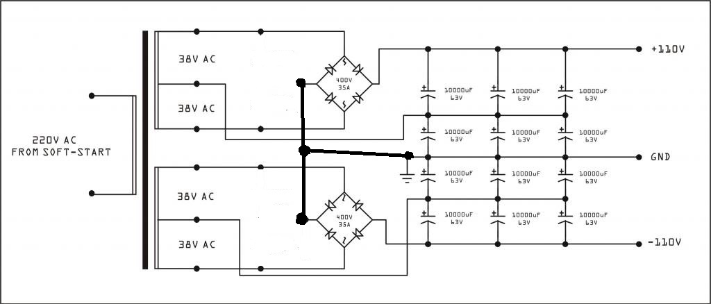

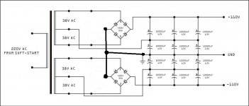

No, your transformer shows three connections to Power Ground. These will short some of the windings during different phases of the mains waveform.
sir andrew , can this work,thank you
I once used 40 caps in a similar configuration.... didn't blow up anything, however on one + 90v rail, one bank of caps was +48v, the other +42v.... My problem was there was no auxiliary ground since the trafo only had one center tap... so the voltage would sometimes float. The addition of some 2k resistors helped, but being 63v caps, I didnt have a huge problem, but I would not advise doing it that way...
The way you have it configured, it should be rock solid.
