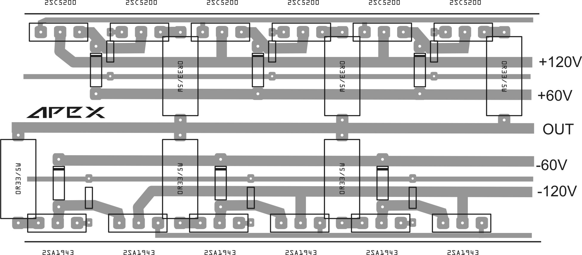

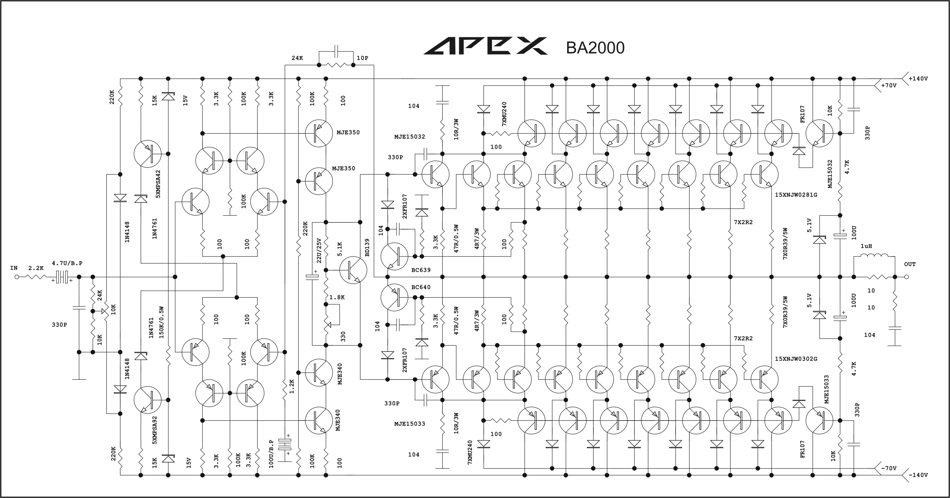

i can't post with high quality. limited size picture. maybe this picture can help you. regards
1. relay 12VDC, rating ampere lupa bos. :D
2. u can use anything small transistor for Q1,but remember of NPN. for Q2=tip32 / anything PNP.
3. sensor fan, no use. automaticaly detect from out amp.
4. NTC 10K to heatsink, heat protect. but this protect work fine without it. :)
schematic of sensor fan attached.
thx. regards
